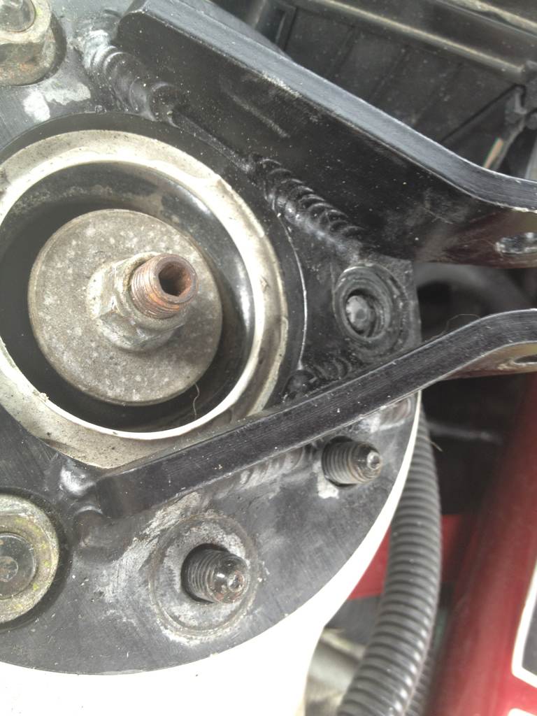

While putting my strut tower on, I sheared one of the studs in half:
Tapped the sheared stud out, but there's a cover so it couldn't fall out completely. So I ended up having to take the entire strut assembly out. Sorta hard since I was by myself but not too bad. Anyways, luckily the fronts springs aren't that big, so I zip tied the spring so it couldn't move much. Backed the top nut off, then took the top hat off. As soon as I took the rubber/plastic cover backing thing off the hat, the sheared stud fell right out.
I figured I would just put my own nut and bolt in there as a replacement, so I took one of these:
And shaved the head down to the size of the other ones, which can be seen on the sheared stud. So I did that, put it all back together, put my own nut on, and all is perfect yet again :)
