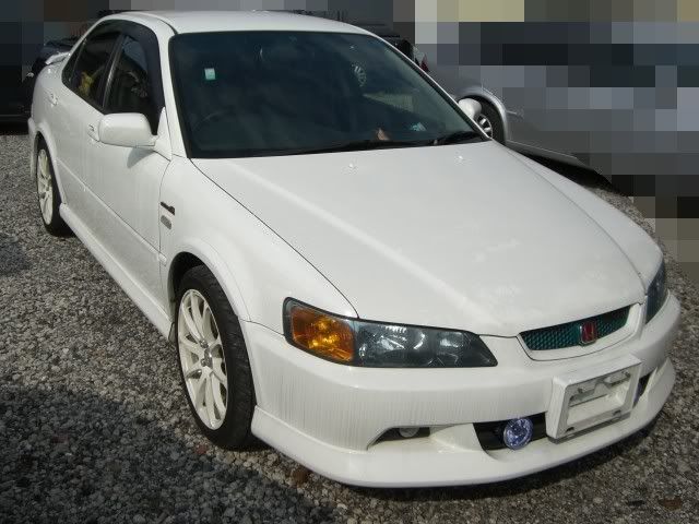

Im lookin for this front

You can probably use the hood and fenders from any JDM accord, but no other JDM 6th gen had the guard flares. But they bolt on so you can get them seperately.
The bumper differs mainly in the lip and fog lights. Only the Euro-R Accord looks like this.
Also, you can't mix and match Torneo parts as these are the only parts (apart from the trunk) that set the Accord and Torneo apart.

think i could part it out? or do you think i will need the radiator support & everything else
BlkCurrantKord
Super Moderator
Sep 7, 2005
10,011
113
Ohio
You'll need the radiator support. I've found one RHD clip w/ engine/tranny/dash but no front end parts and then I've also found a place that sold the front end parts (lights/hood/fenders/bumper/support) - which is that link provided for V6P.
