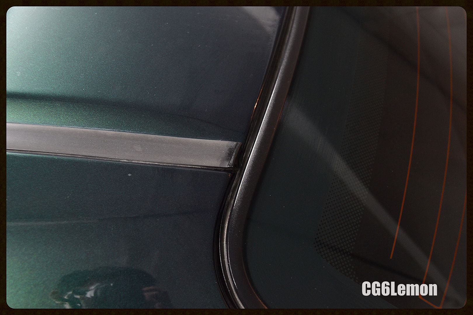

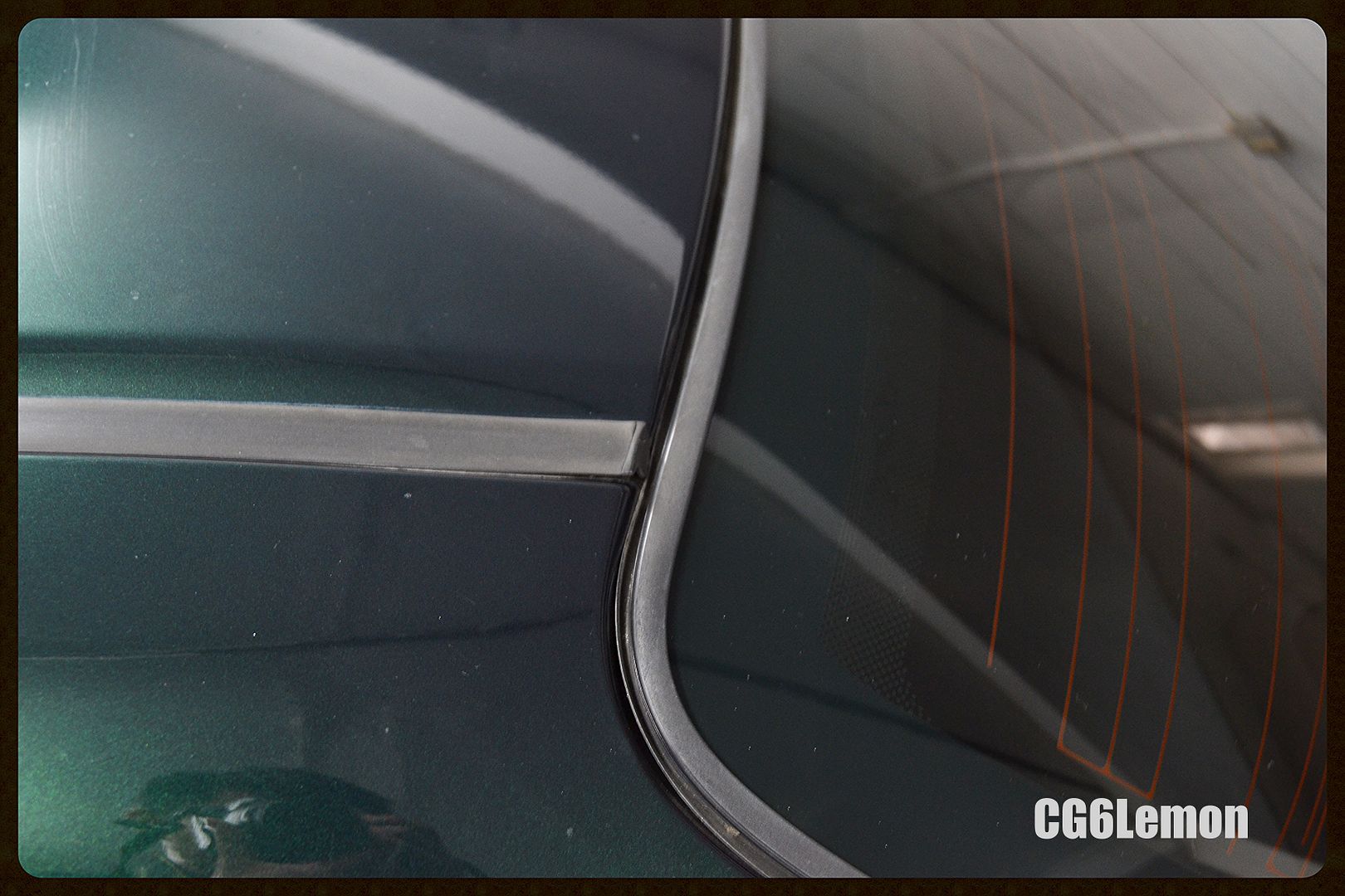

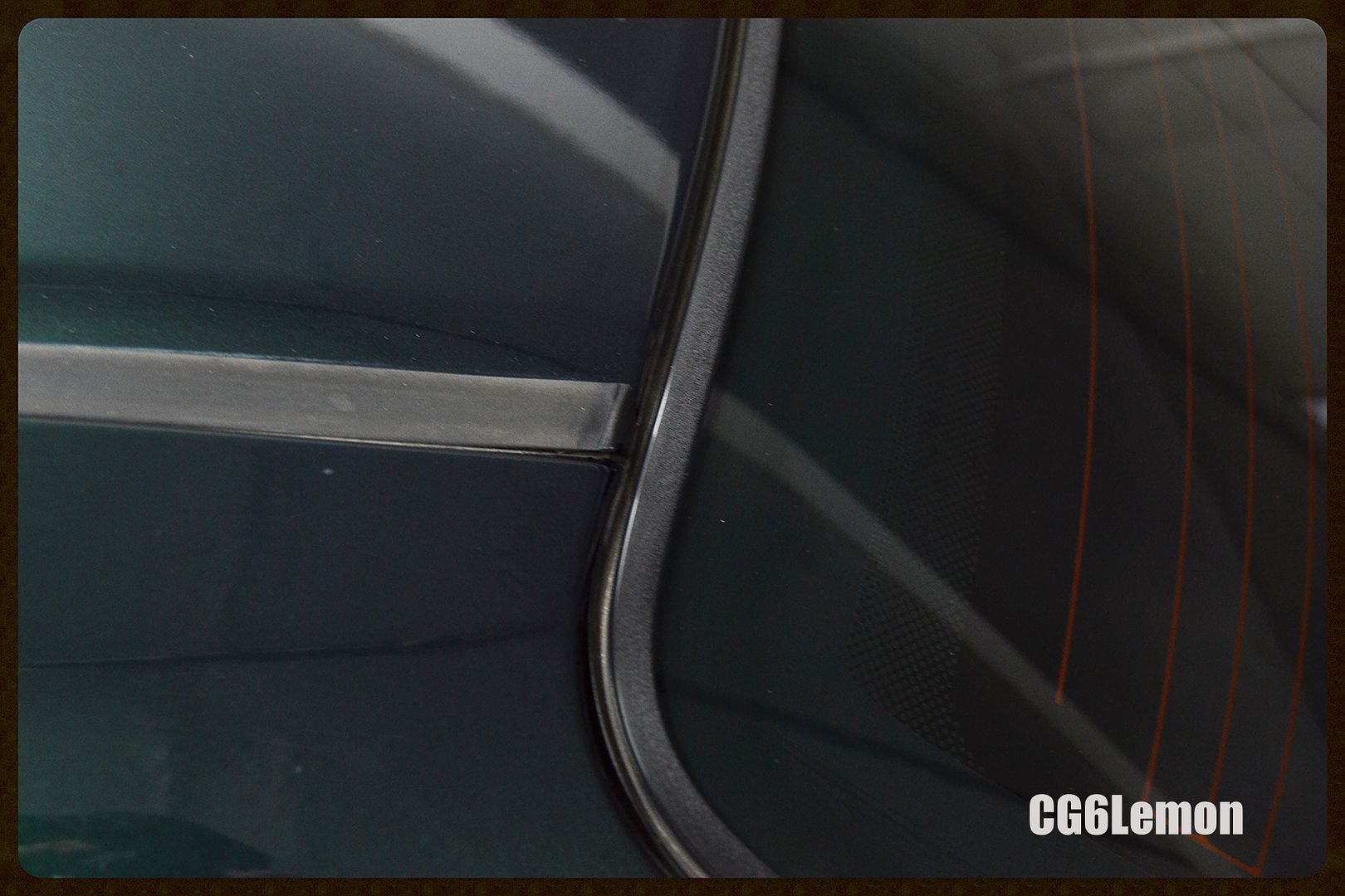

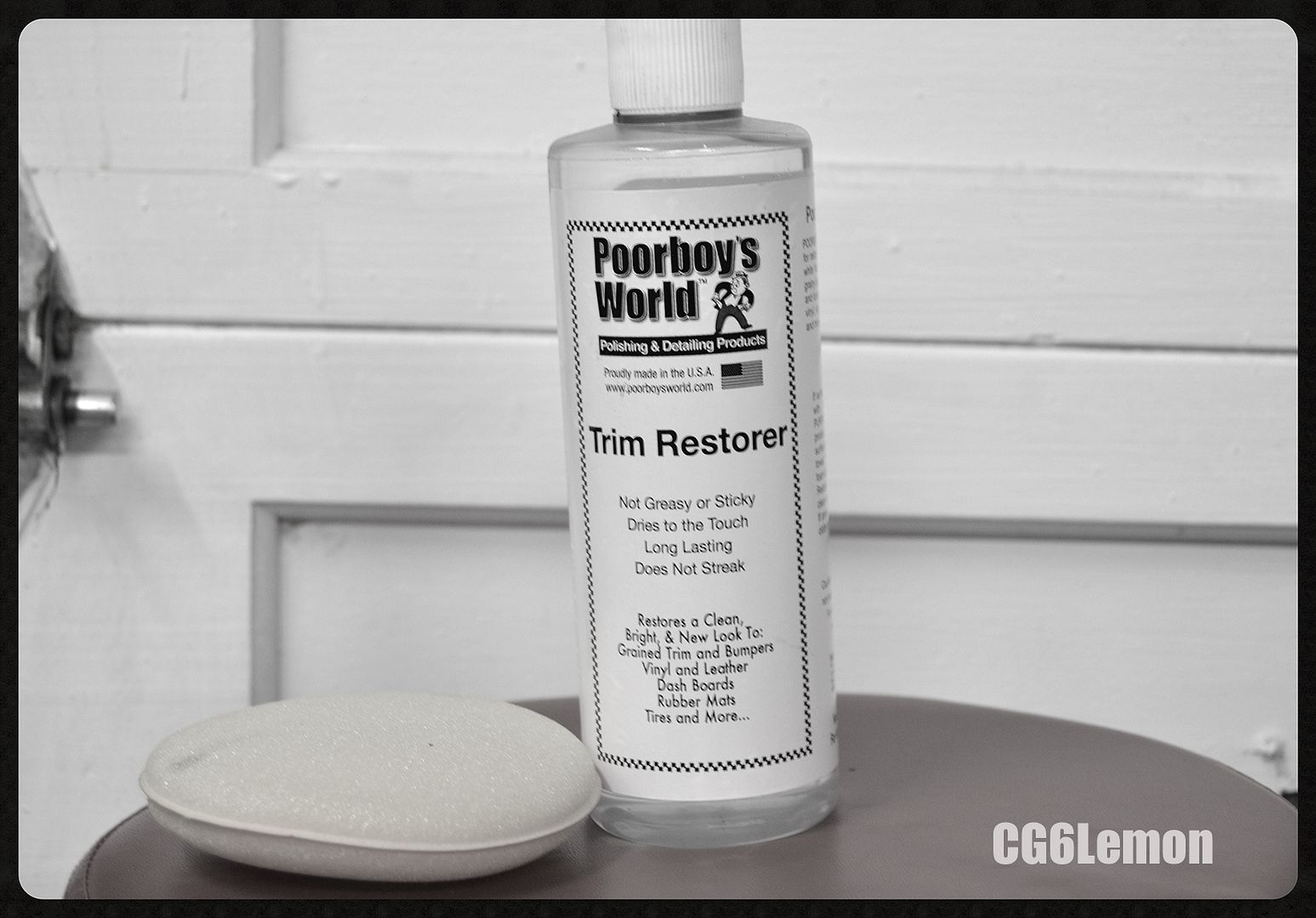

A quick review of Poorboy's world trim restorer
Brief product overview: (Copy and pasted from Detailedimage)
POORBOY'S TRIM RESTORER is a unique formula designed to restore and condition grained trim and more. It takes away the white haze from products that get embedded into grainy plastic parts and leaves the surface clean, dry and looking new. TRIM RESTORER can be used on vinyl, vinyl tops, grained plastic, rubber, and more.

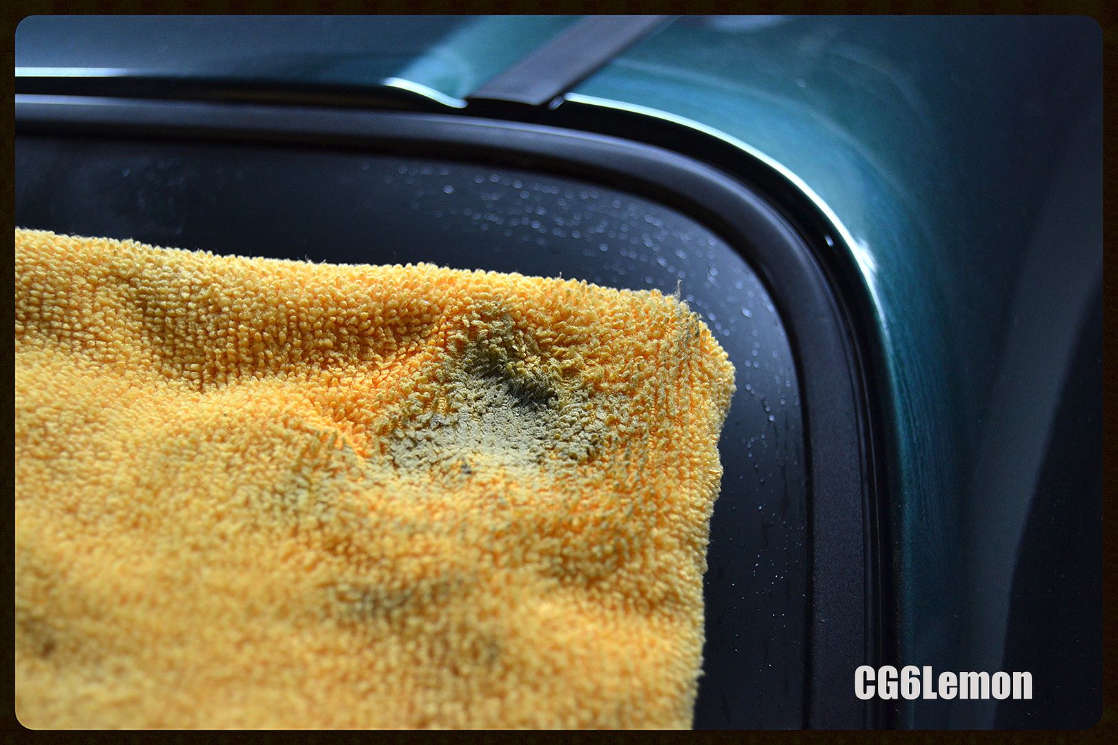

Before using this "dressing", it is not a dye, or a trim coating, proper prep is required for it to work as best as possible. I used an All purpose cleaner ( Zep Citrus from HomeDepot) to clean the surface to ensure the trim is bare with nothing on top.
Started with a clean towel, then ended up with dirt and stains from the trim alone.
When applying the dressing, use a generous amount. A little goes a long way, but don't try to conserve and use a little dab for a big area. After applying, I let it sit for 5 minutes to allow the pores from the plastic trim to absorb as much as possible before buffing it off.
Here are some 50/50 shots
Zoomed out shots

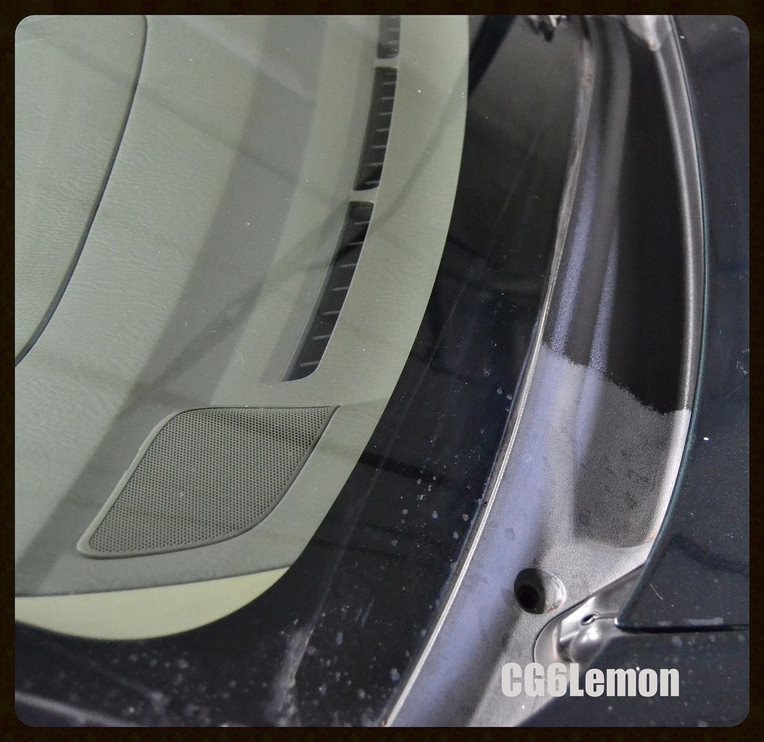

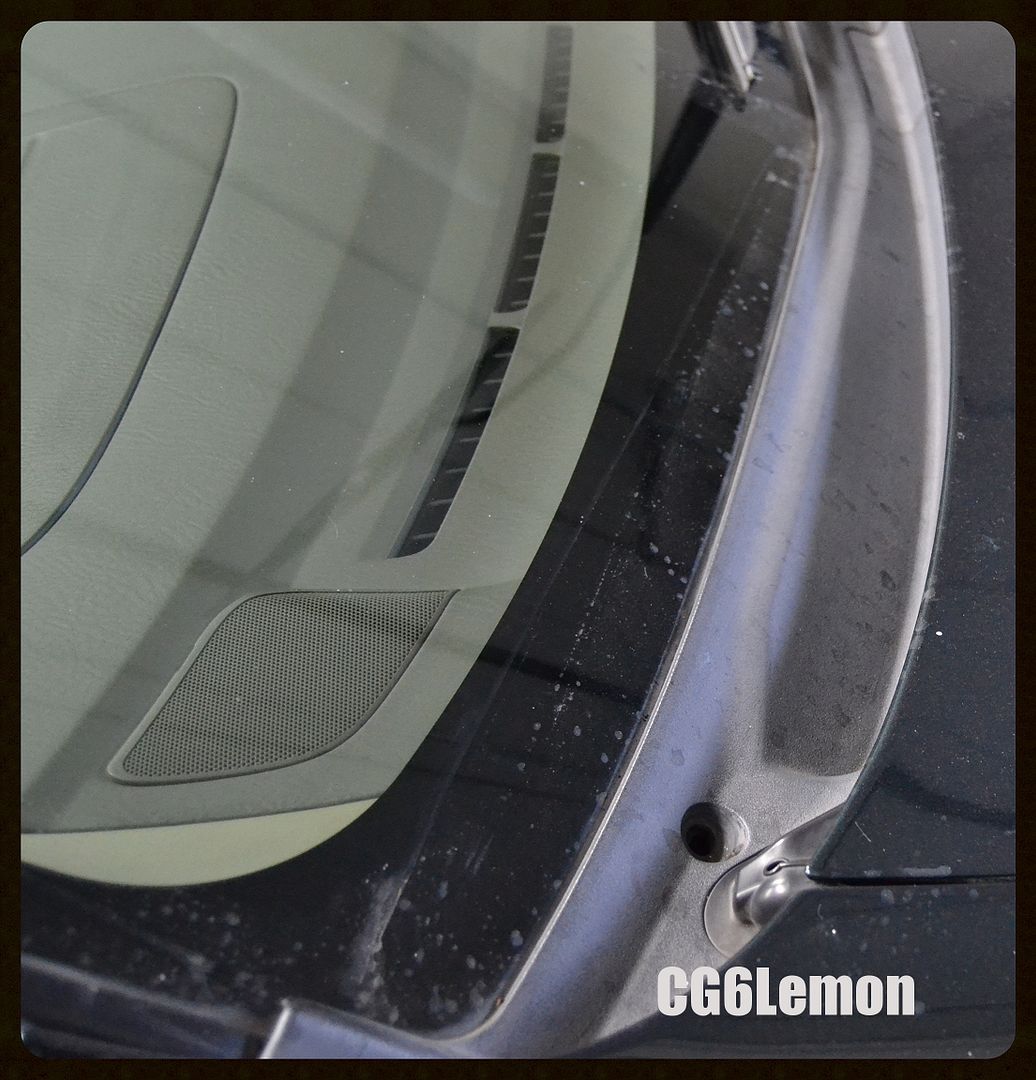

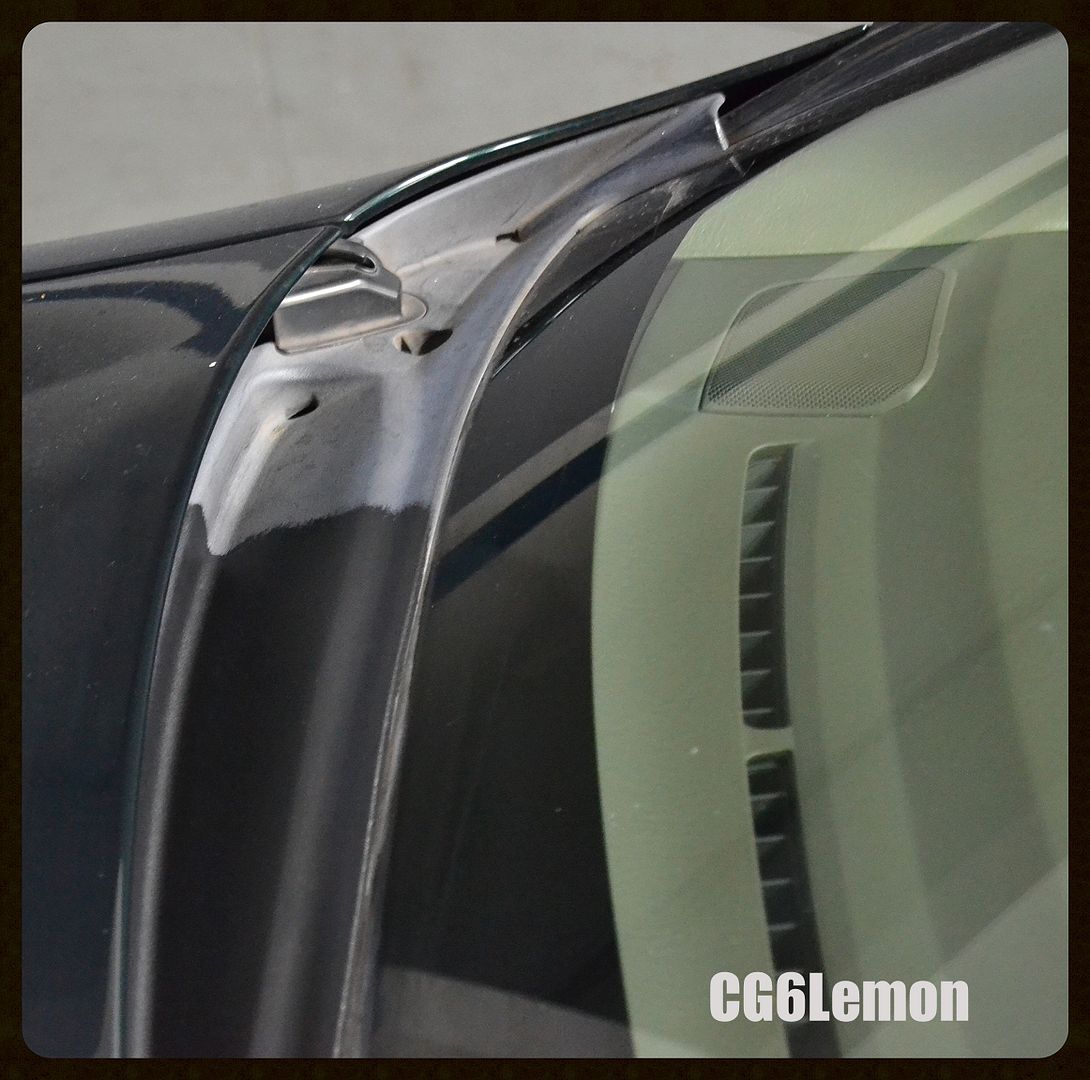

Next I did a small part of the windshield cowl. Started with a really faded, grey texture. Then applied the dressing which gave it a nice low sheen "refreshed" look again. This dressing will not restore anything because that's not what this product is designed to do. The dressing will wear off with normal driving conditions, and is not permanent.
Some 50/50 shots
Last minute thoughts and impressions of the product:
This product will go a long way because it does not require much product consumption per application. Price wise is okay IMO for this specific type of product. As far as how how this product performed, first impressions were good. The trim was brought back to life, but I will need to test the durability of the product to see how long it will hold up after normal driving in the sun and a couple washes. The product works, and offers a nice uniform dressed look.
Thanks for viewing, appreciate any thoughts or comments. Always happy to answer any intrigued minded questions.

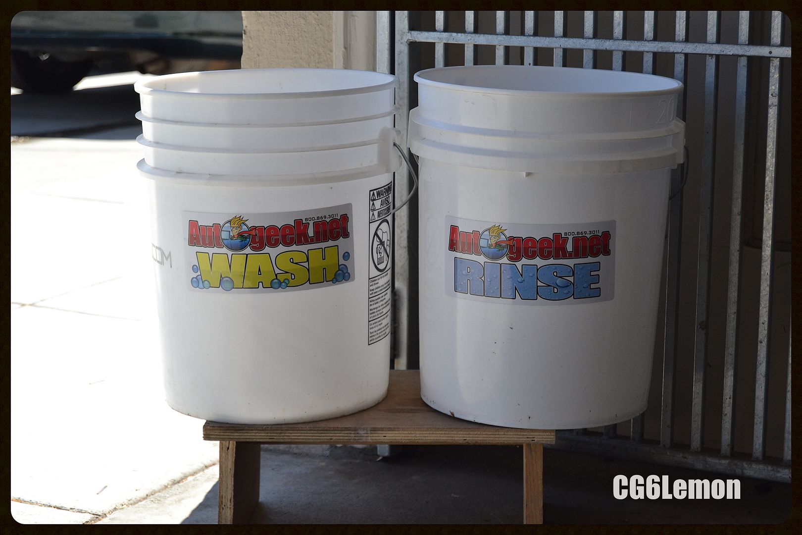

The Benefits of using two buckets instead of one
One of the most common practices in auto detailing to this day is using one bucket for soap and rinse. The concerns with using one bucket to wash your car, and at the same time redepositing the dirt that was on the surface back into the same soap bucket is asking for trouble. What happens is the soap bucket is suppose to be the "delegated" soap bucket only, and was not meant to be cross contaminated with other particles.
You want the soap bucket to be as clean as possible everytime the wash mitt is re dipped to gather more soap. The idea behind the 2 buckets is to have one bucket for soap only, and the other bucket filled with only water for rinsing off your wash mitt after every panel of washing your car. This way the dirt from the surface of the car will stay in the rinse bucket and when you re dip the wash mit into the soap bucket, the mit will be as clean as possible to not reintroduce any dirt back onto the wash mit then back to dragging the dirt onto your car.
It would go like this:
Dip mit into soap bucket
Wash one panel
Rinse off mit from rinse bucket
Re dip mit into soap bucket
Wash 2nd panel
Repeat from here for rest of the car

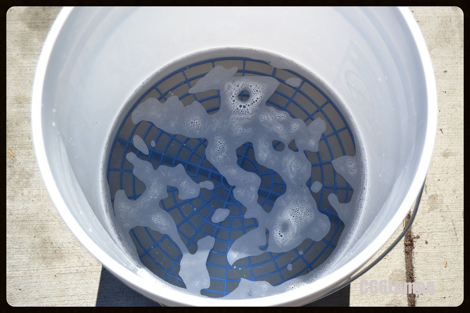

Here I have 1 bucket filled with soap
Now we have two buckets, one filled with soap, and one with water

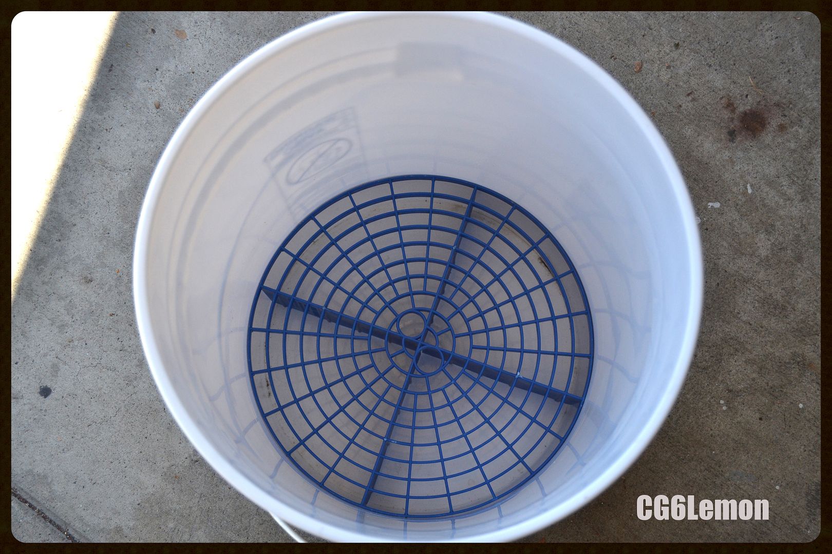

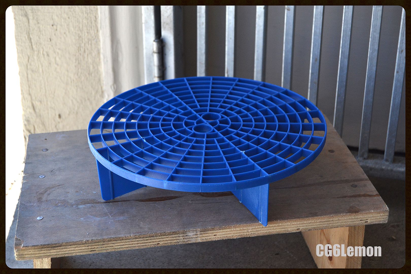

A tip for the rinse bucket is to use a Grit Guard in conjunction.
What this does is that it sits on the bottom of a 5 gallon bucket, and it offers 2-3 inches levitation from the bottom of the bucket. This will act as a separator from the loose dirt and the fresh water from swirling around when you put in the wash mit to rinse off the loose dirt. The dirt will sink to the bottom and only clean water will be accessible on top of the Grit Guard.
An example of how it sits in the bucket, and all the dirt from not washing my car for one month after a car wash
Now is the Grit Guard an absolutely necessary tool when washing your car? I would say no, but if you are going to try your best to not inflict any swirls to your paint, why go through all the effort to leave out something so simple to ruin all the hard work you've invested. I would highly recommend trying the 2 bucket method for those still using 1 bucket. Thanks for taking the time to read through this, and as always I'm looking for feedback on anything anyone is interested in and wants to know a little more info.

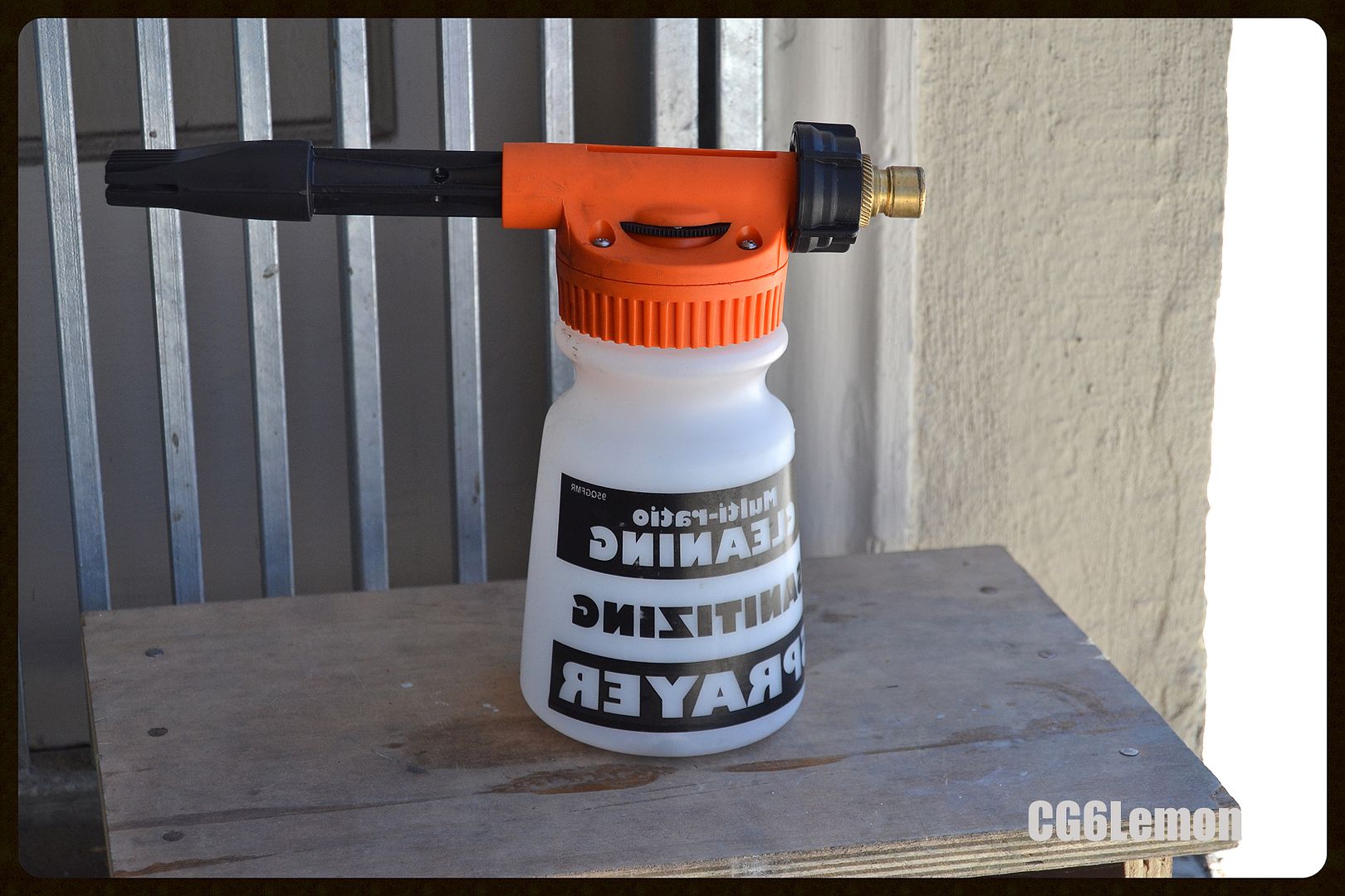

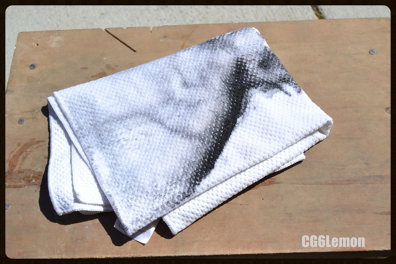

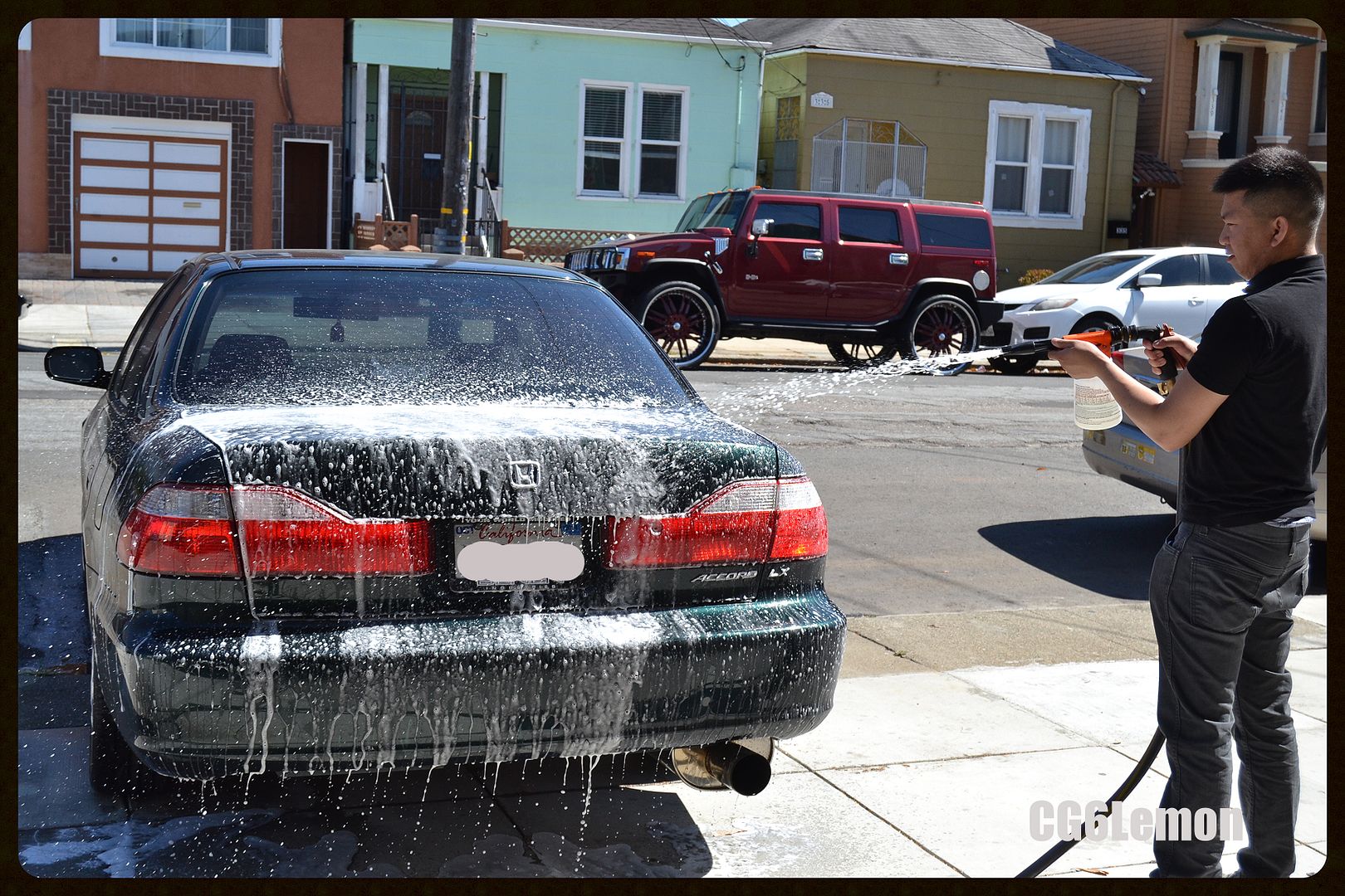

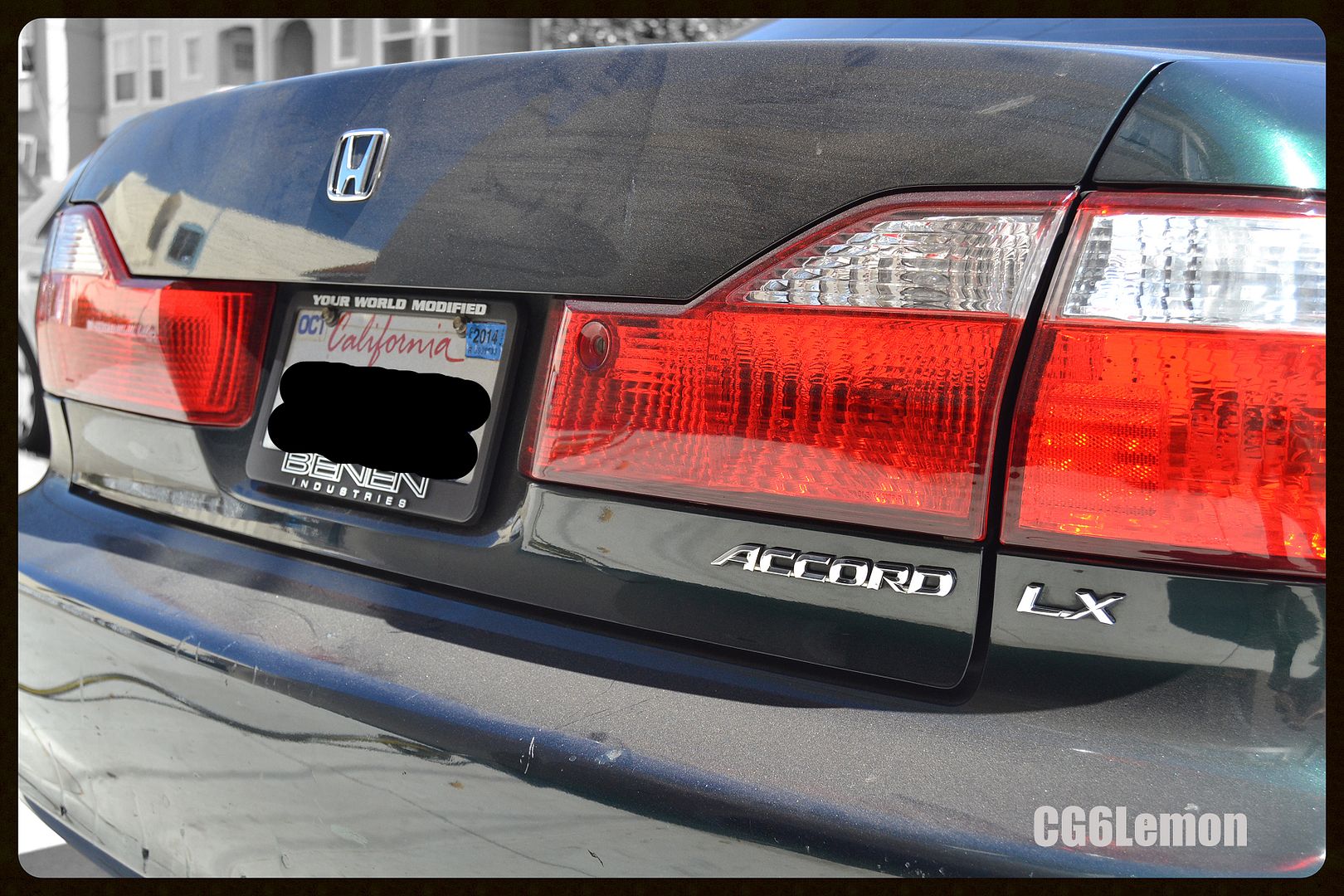

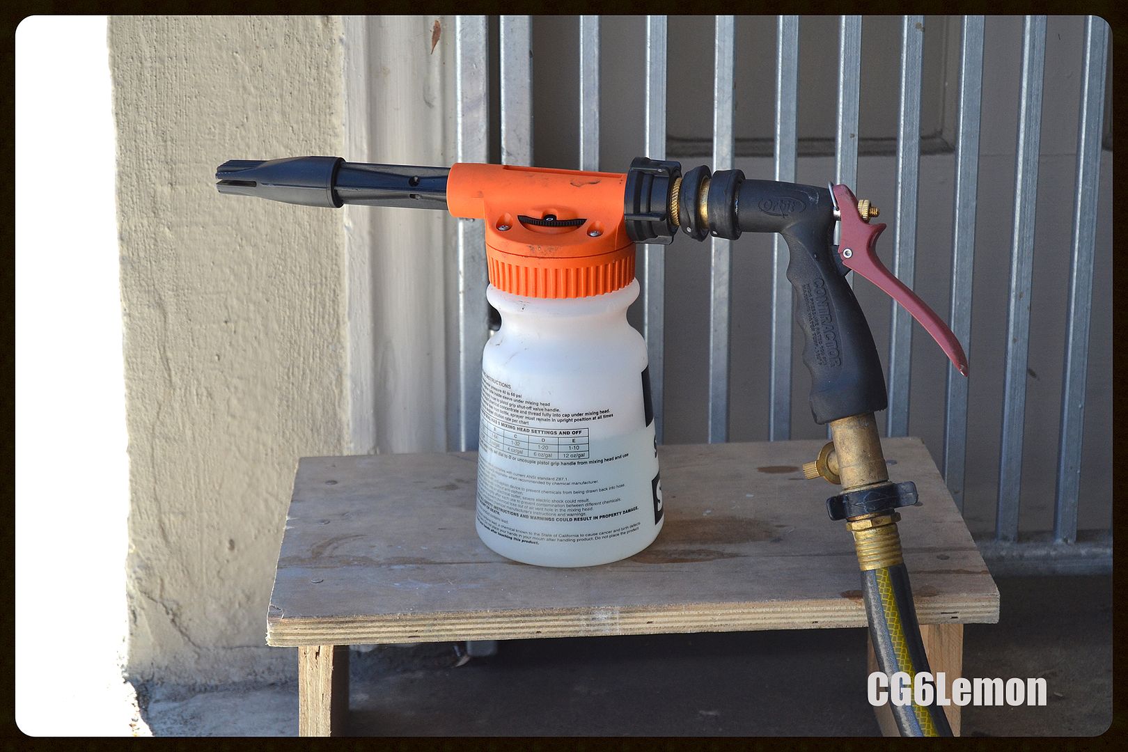

How can a Gilmour Foam Gun help with your wash process?
Before I knew such a tool existed, I used a hose attached with a sprayer/nozzle. Now that I've tried one, I would "never" wash a car without one. What is a foam gun? A foam gun is attached to a garden hose which intakes soap from a canister and puts out foam to emulsify, break down, loosen dirt, and most important of all, offers exceptionally more lubrication compared to hosing it down with only water.
How it works: Not my video
http://www.youtube.com/watch?v=QdQuAadi-pk
This is the foam gun with a quick disconnect on it
Here it is all assembled ready to go. It comes with both ends of the quick disconnect attached to your nozzle. I personally added a shut off valve to the hose.

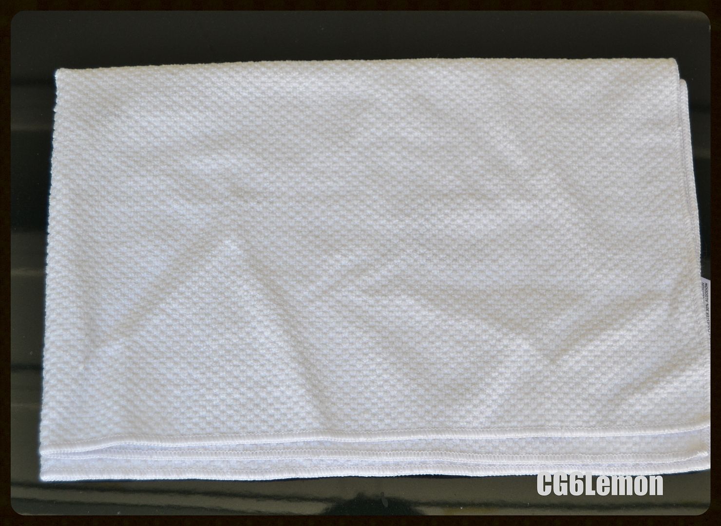

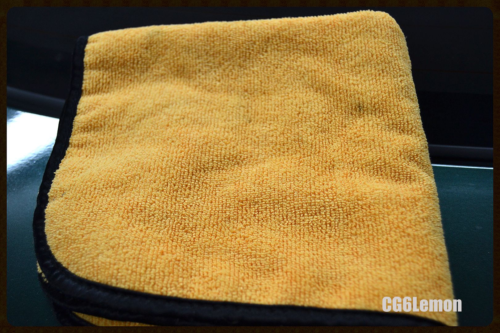

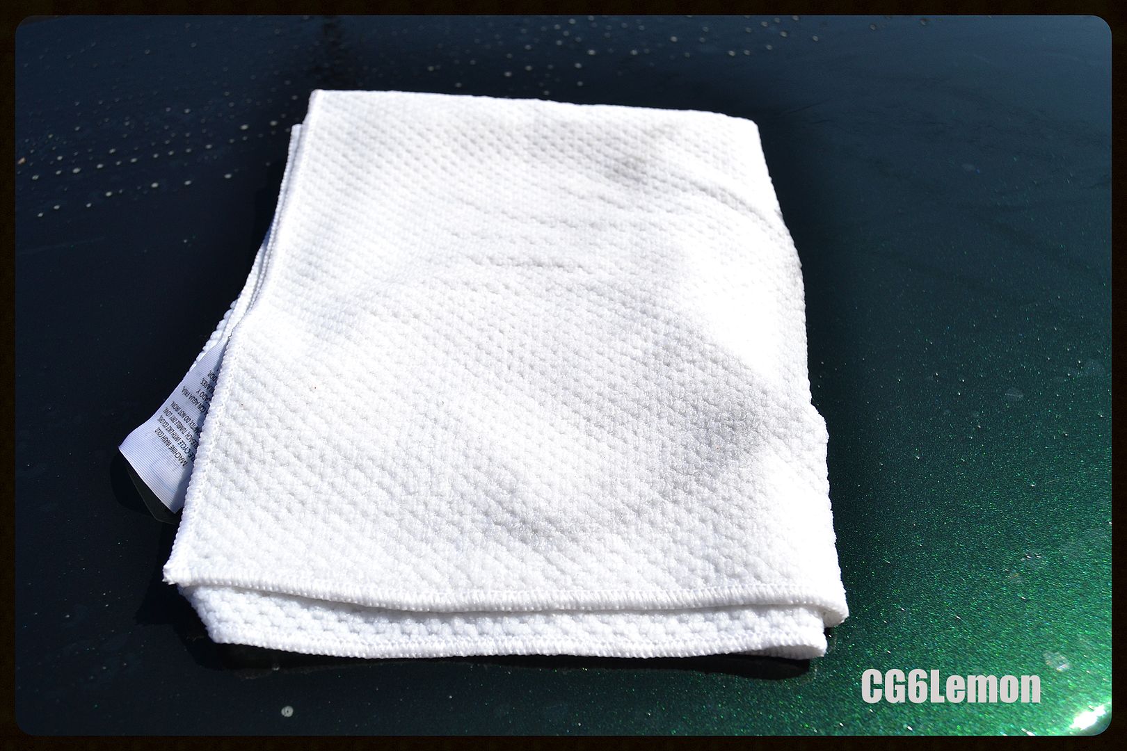

To demonstrate the foam gun's qualities, here is a clean towel before use.
The condition of my car without a wash for one month. A thick layer of dust/dirt on the surface of the paint clouding the reflections
To make things as fair as possible, I will rinse down the rear bumper with a strong jet of water

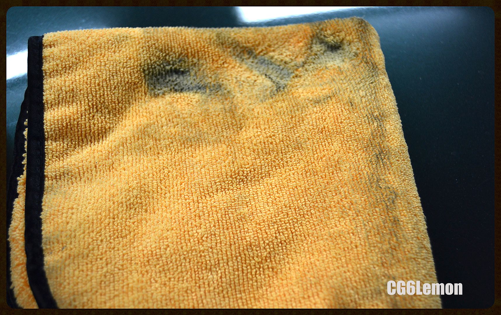

After the initial rinse, I dipped the towel into my soap bucket and wiped it across the whole top surface of the rear bumper. The amount of dirt accumulated on the towel shows the initial rinse only knocked off loose dirt from the bumper, anything else did not come off.
In this picture, I focused on foaming the trunk area, and let the soap dwell for 2 minutes before rinsing it off. At this point, I did not do any wiping/agitation, just foamed and rinsed.
Afterwards, I did the same thing and used a clean towel dipped into the soap bucket and wiped down the whole top part of the trunk. The result of implementing a pre wash with the foam gun already removed 75-85% of the layer of dust/light dirt without even touching it. The result of the towel only shows very light dirt.
This tool have become a staple in my arsenal which I cannot afford to not have. For those that do weekly or bi weekly washes, this tool is the perfect choice to use. Simply, foam the whole car, rinse it off, and dry your car off. It is that simple, easy to use, and adds a fun factor whenever you wash your car. Anyone that is interested, I will leave a link below to be able to do some more research before purchasing. Thanks for viewing guys. If anyone have any questions about the foam gun, feel free to ask away. I guaranteed you won't be disappointed with the purchase, that's how much confidence I have in this tool.
