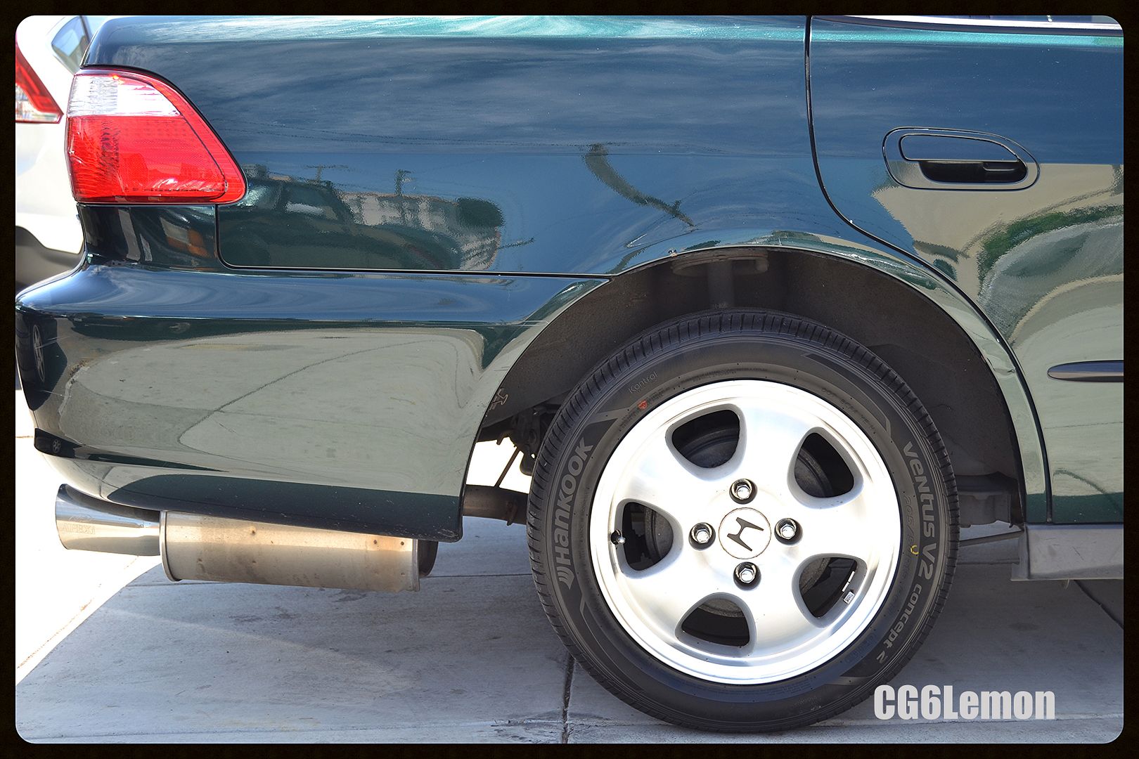

cleaned my brothers sedan, his wheels were sooo bad, he hasnt washed it in about 3 years. passenger headlights wont get any better because moisture gets in
Brad, Good job getting the heavier/bulk build up of dirt/brake dust off. Do you know if the lip is clear coated or bare aluminum? To test a rim, apply a light polish and rub on an inconspicuous area. If the wheels are painted you'll see the color of the paint coming off onto the towel. If the wheels are clearcoated you won't see any color transferring off the wheel and onto your cloth, but if you also don't see the cloth turning black you know the wheel is not bare aluminum. Bare aluminum will turn your cloth dark grayish or blackish.

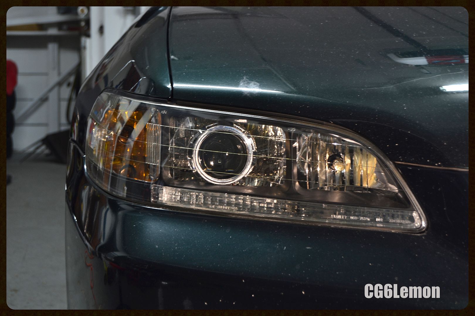

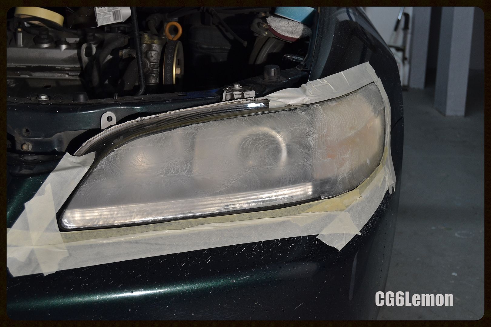

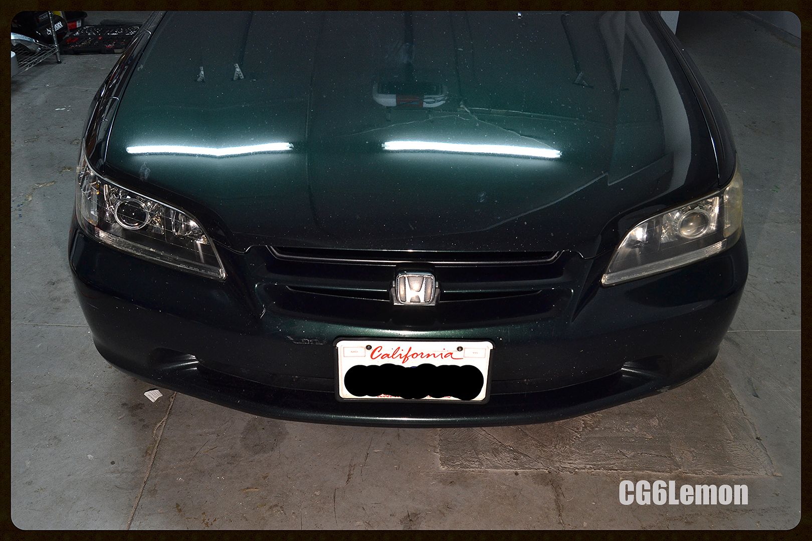

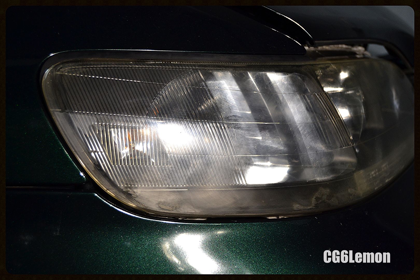

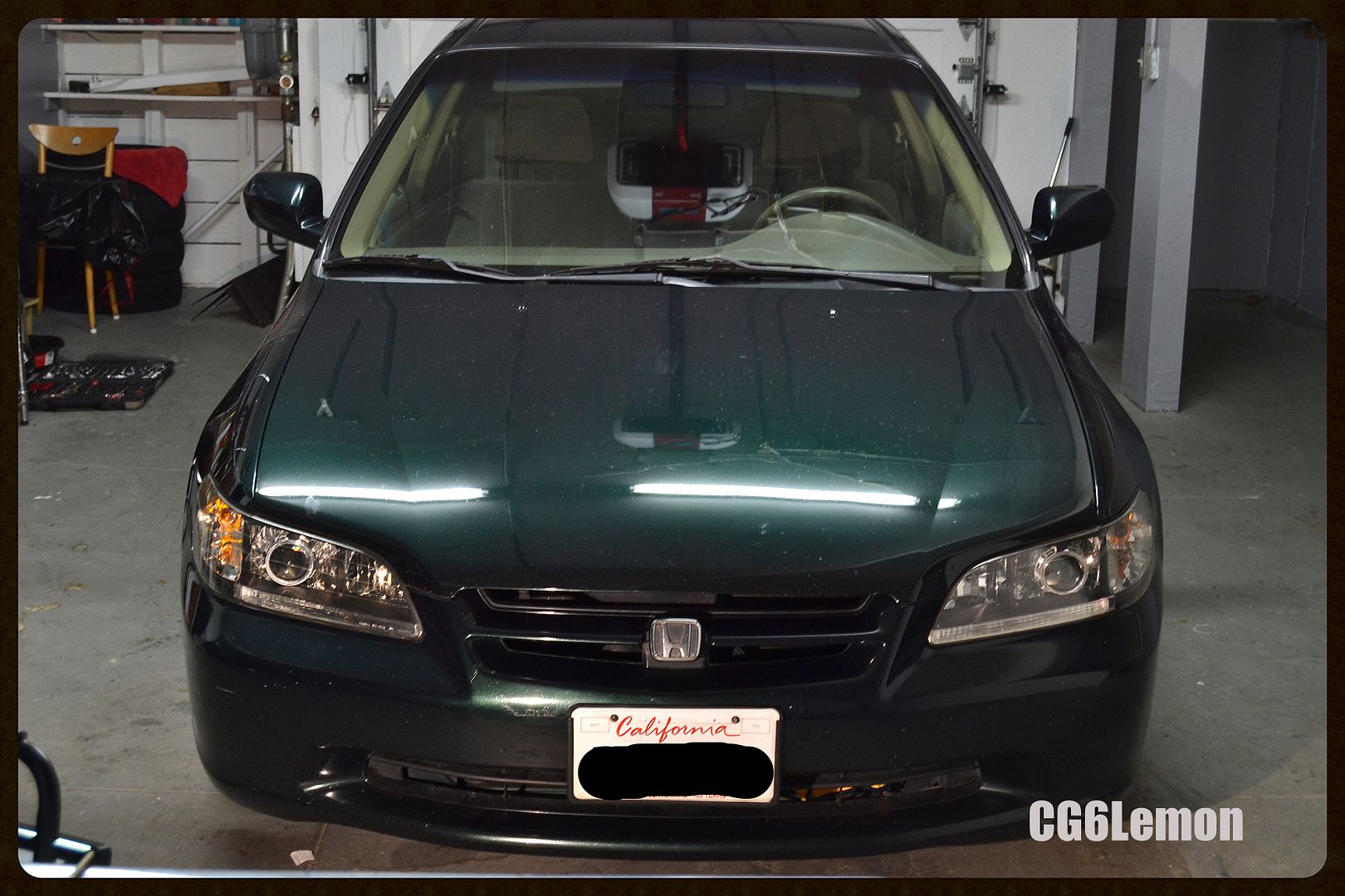

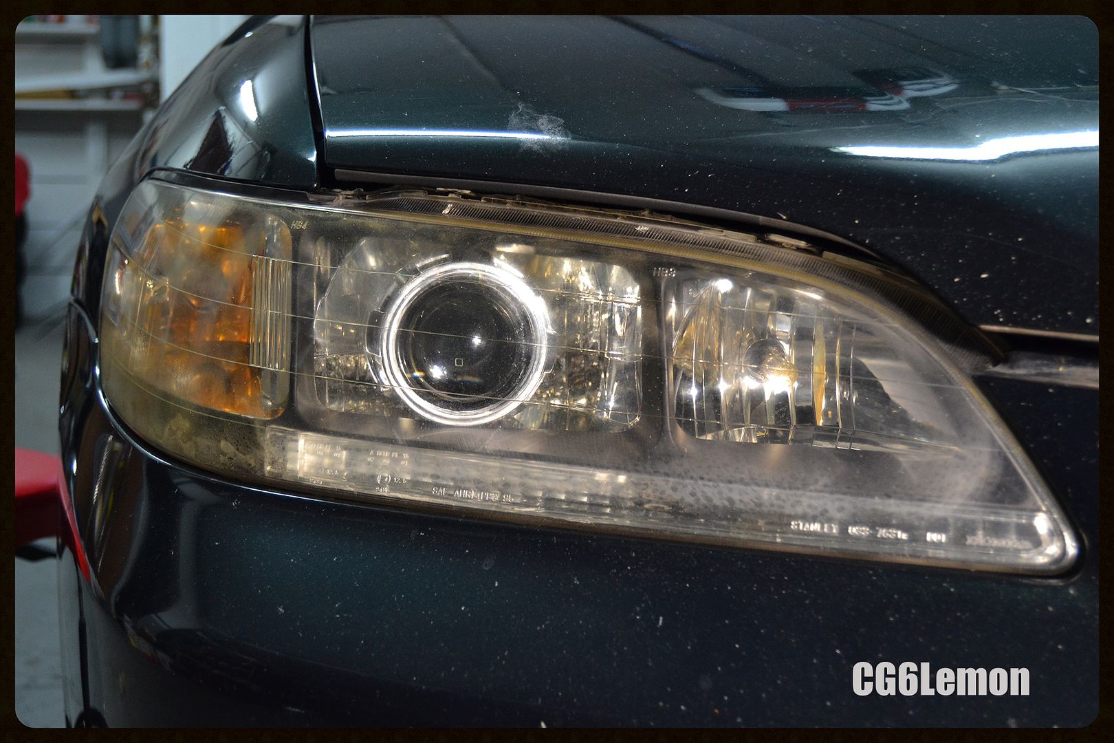

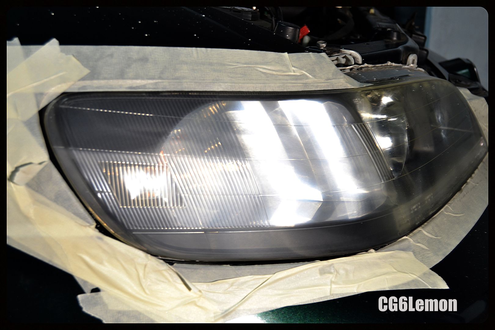

I recently completed my retrofit for my headlights, and upon closer inspection the lenses very severely oxidized, and the previous owner sanded them leaving me more problems to fix. The method I used to "restore" the headlights is only one out of many proven methods, but this will yield the best results with the right tools.
Our starting point
Judging the condition of the headlights, in order for me to tackle all of the problems I know I will have to sand these headlights to remove the defects. My goal for these headlights is to get a crystal clear look to it, but I'm not going to chase the pitting from rocks, and road debris.

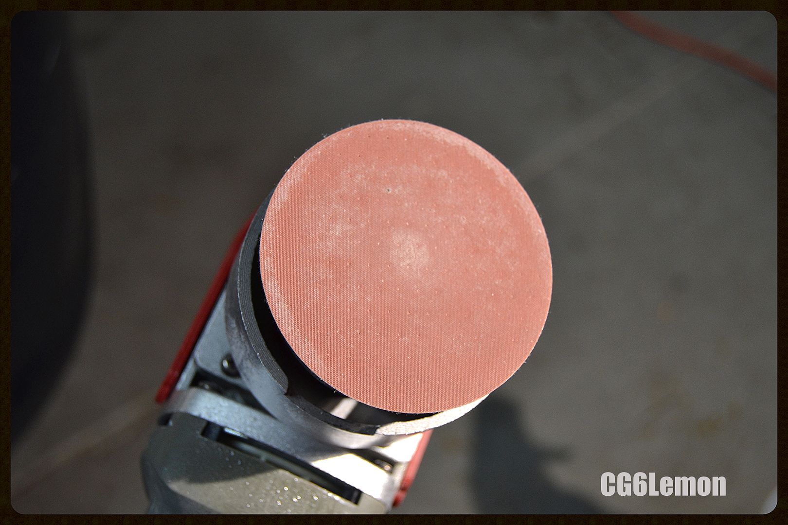

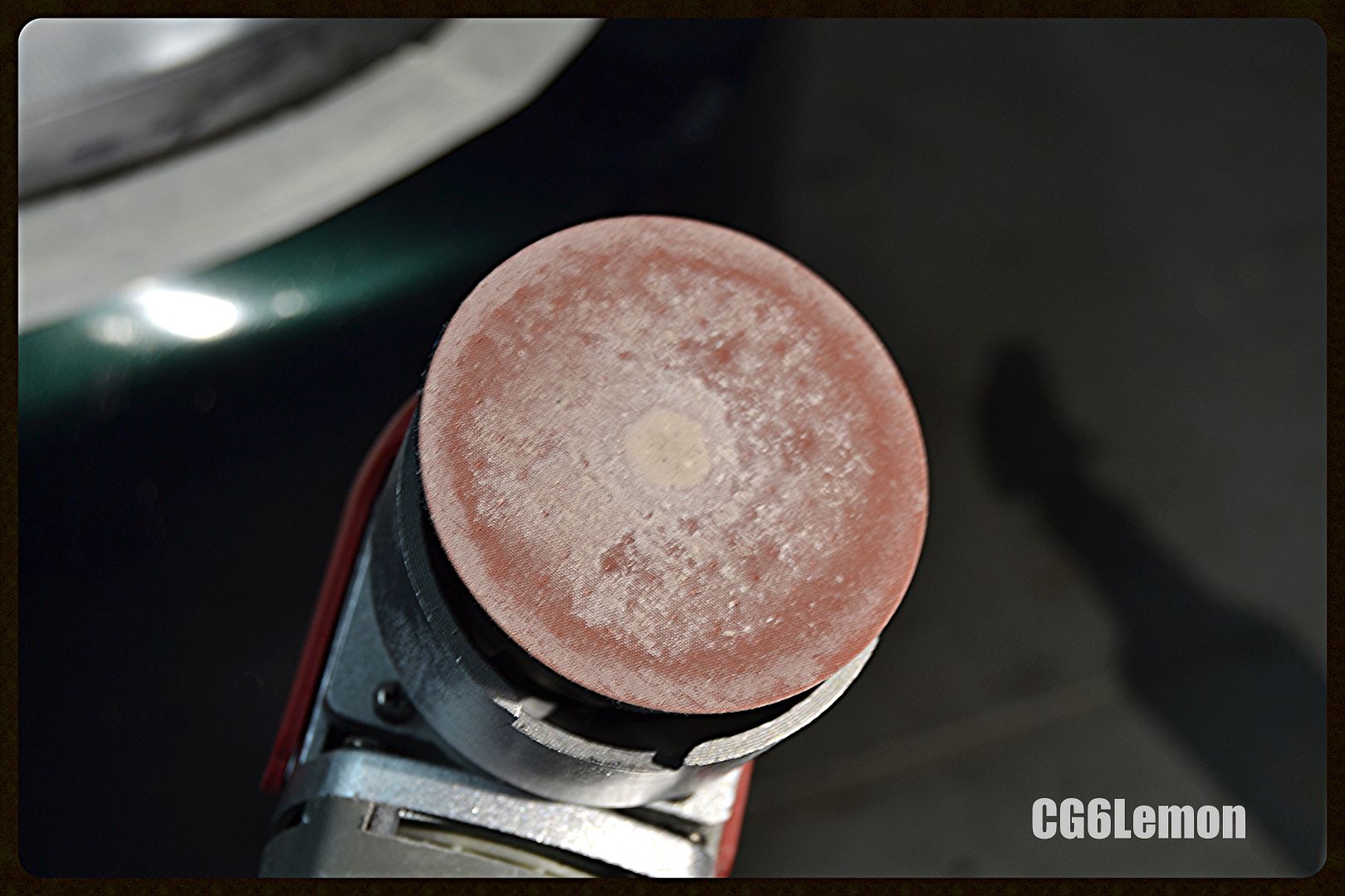

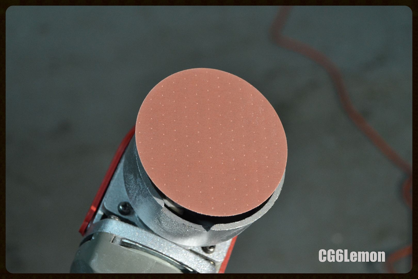

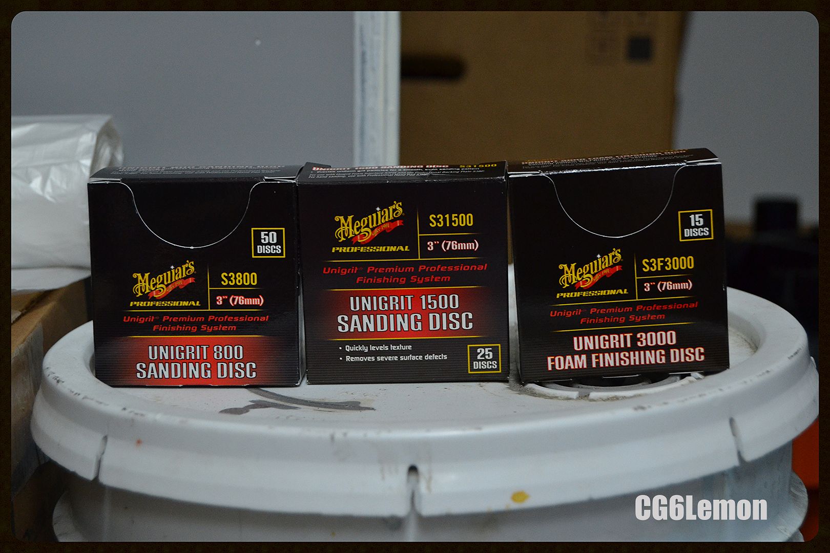

I purchased some sanding disc to use on my DA to speed things up.
This is the disc attached to the DA

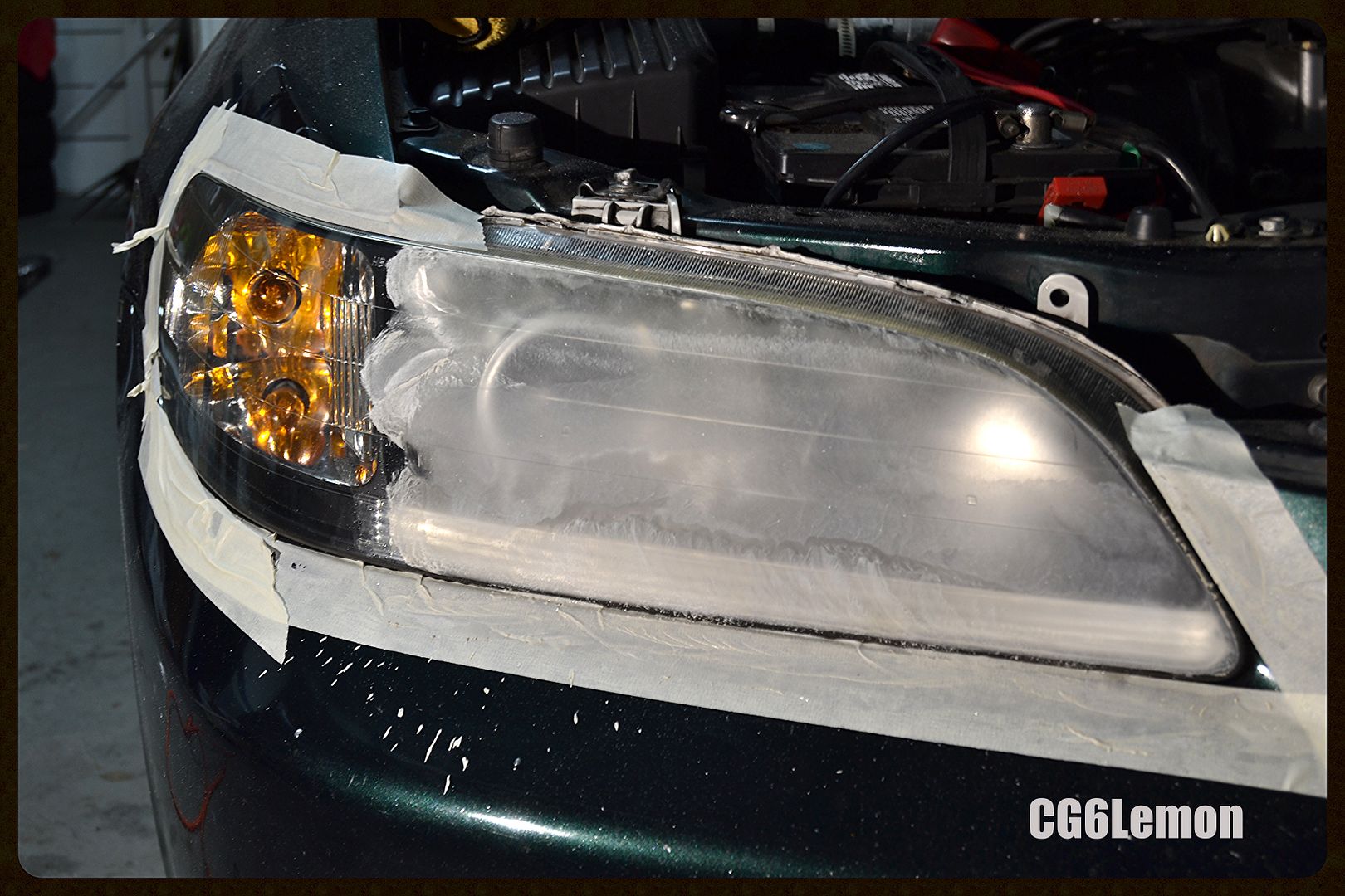

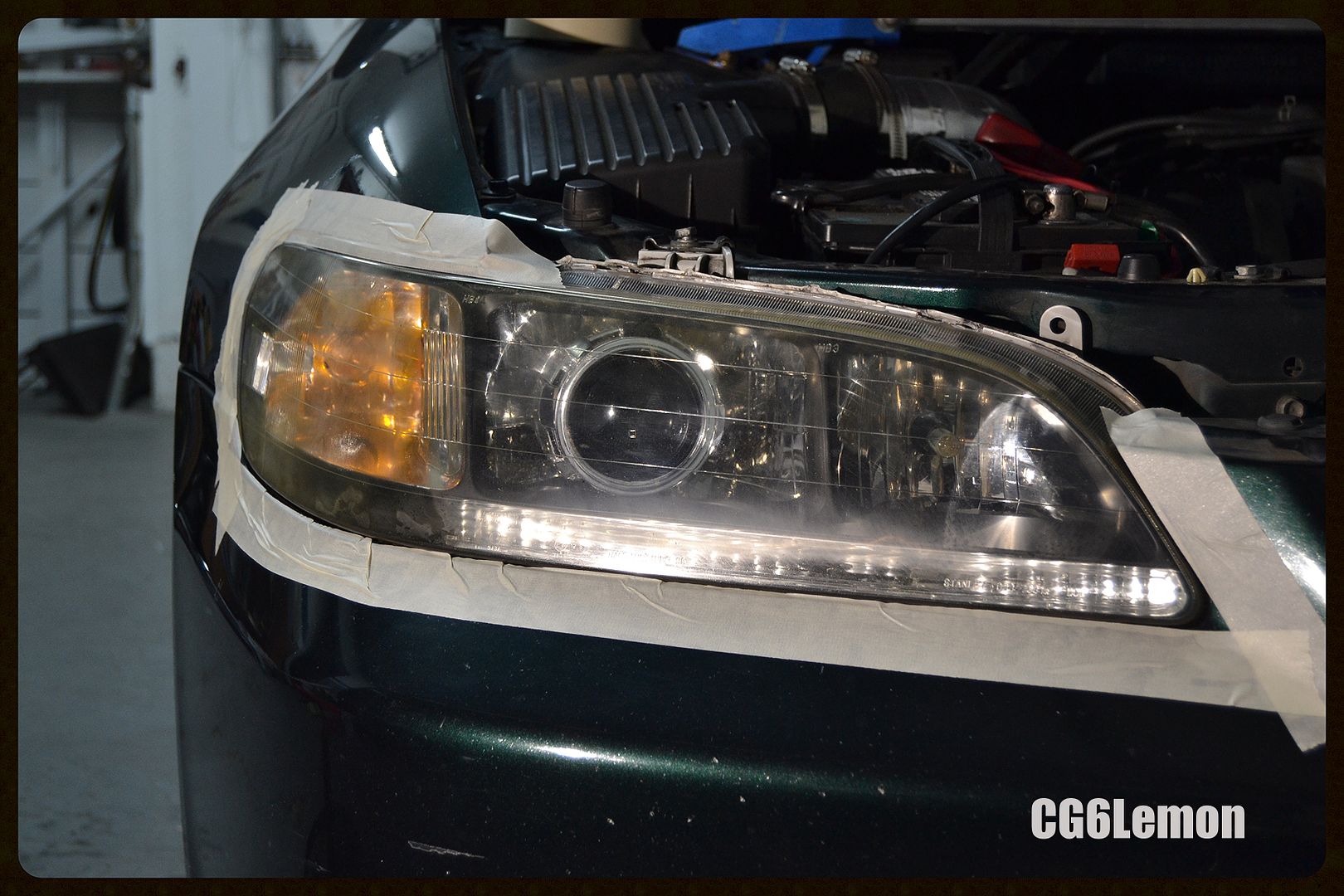

A tip. Tape up the surrounding headlight whenever sanding is necessary to avoid extra work of polishing out unnecessary sanding scratches.
Before I jump right in and starting sanding like crazy, I came up with a plan and decided to do a test spot first to determine my process. I started with a corner of the headlight which IMO was the worst area of the bunch.
This is what the sanding disc looked like after a couple passes. The gunk, dirt, oxidation, clearcoat, and residue coming off the headlight and being transferred onto the sanding disc.
A tip for this is to spray some water on it and wipe the surface with a towel to reveal a clean surface on the disc ready to start sanding again.

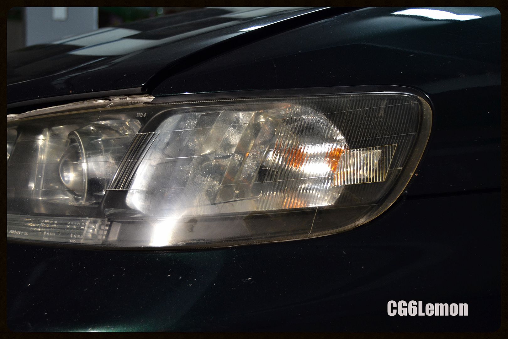

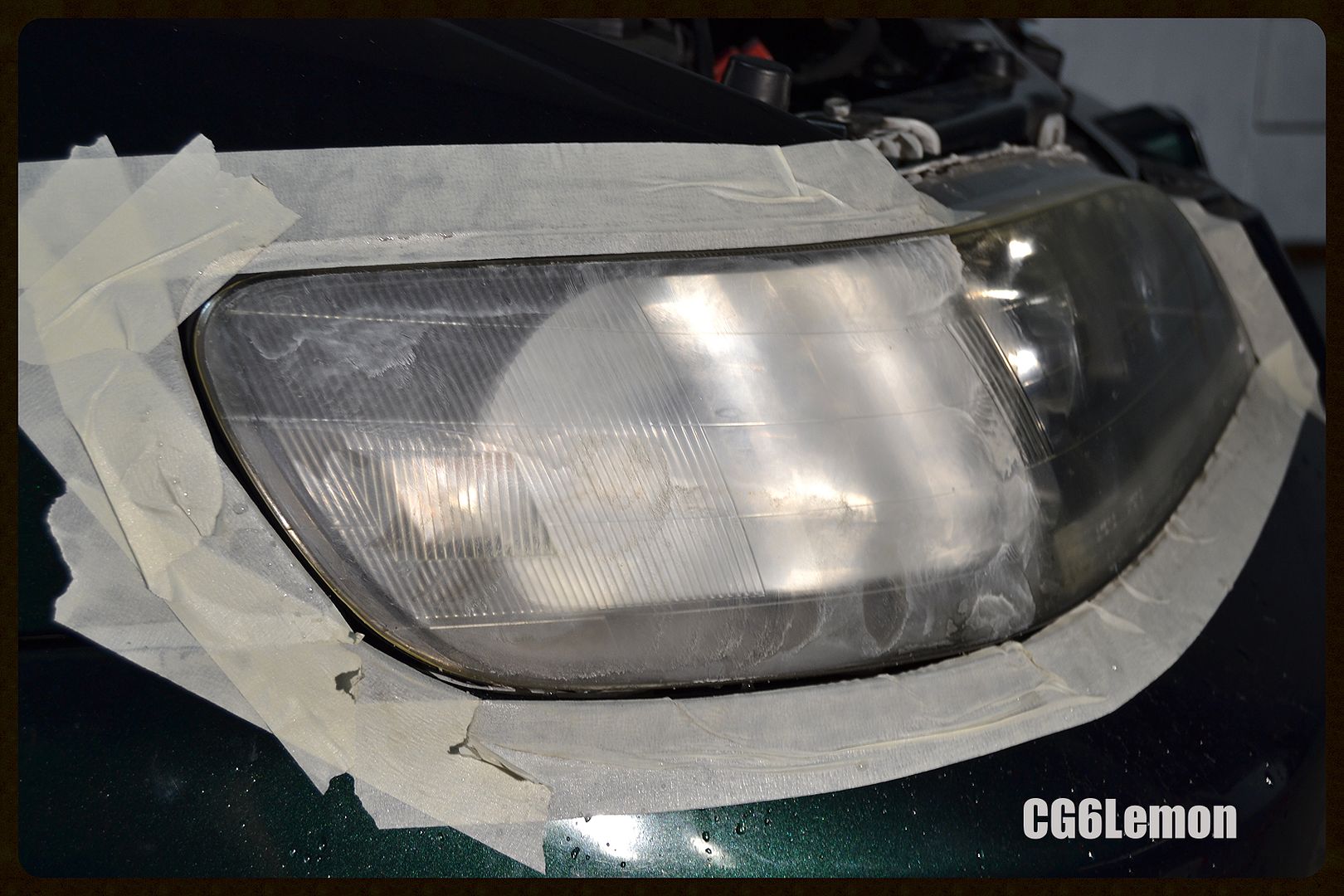

After using 800 grit, I refined it with 1500, and 3000. Ended up with a slight haze I need to polish out later on. From these pictures you can tell the low beam and high beam area was bad with severely yellowing showing.

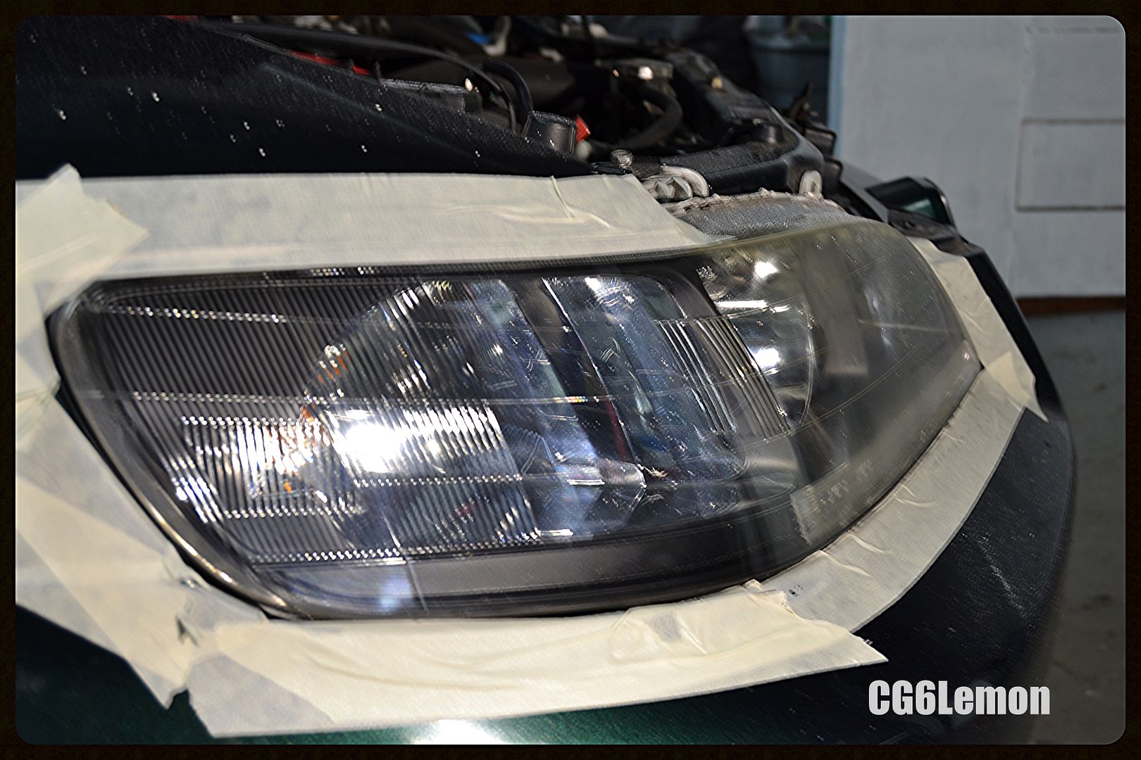

Moving on to the rest of the headlight now.
Completed
Moving on to the other side now
Completed

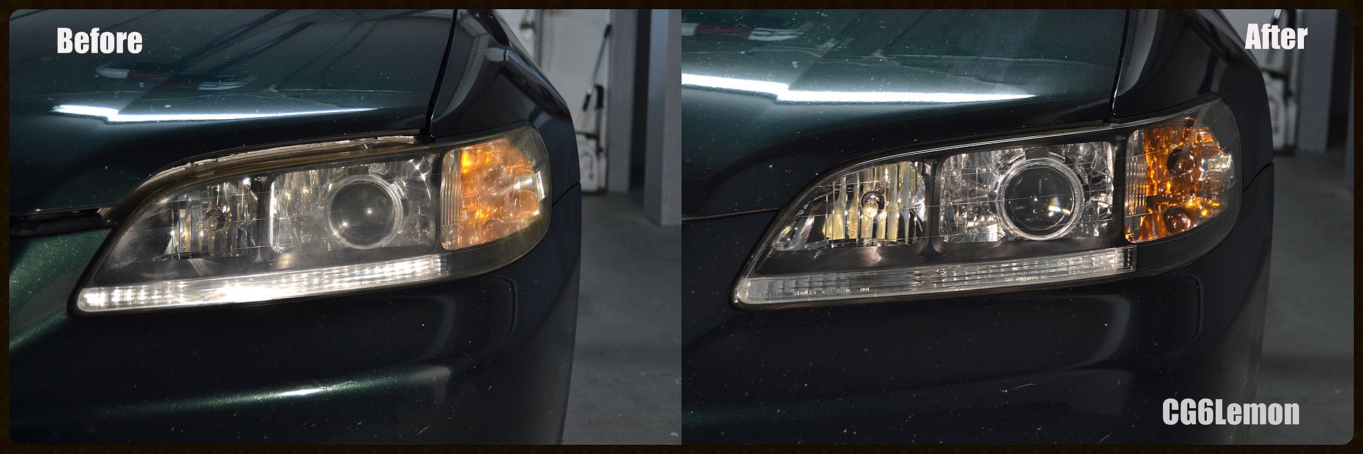

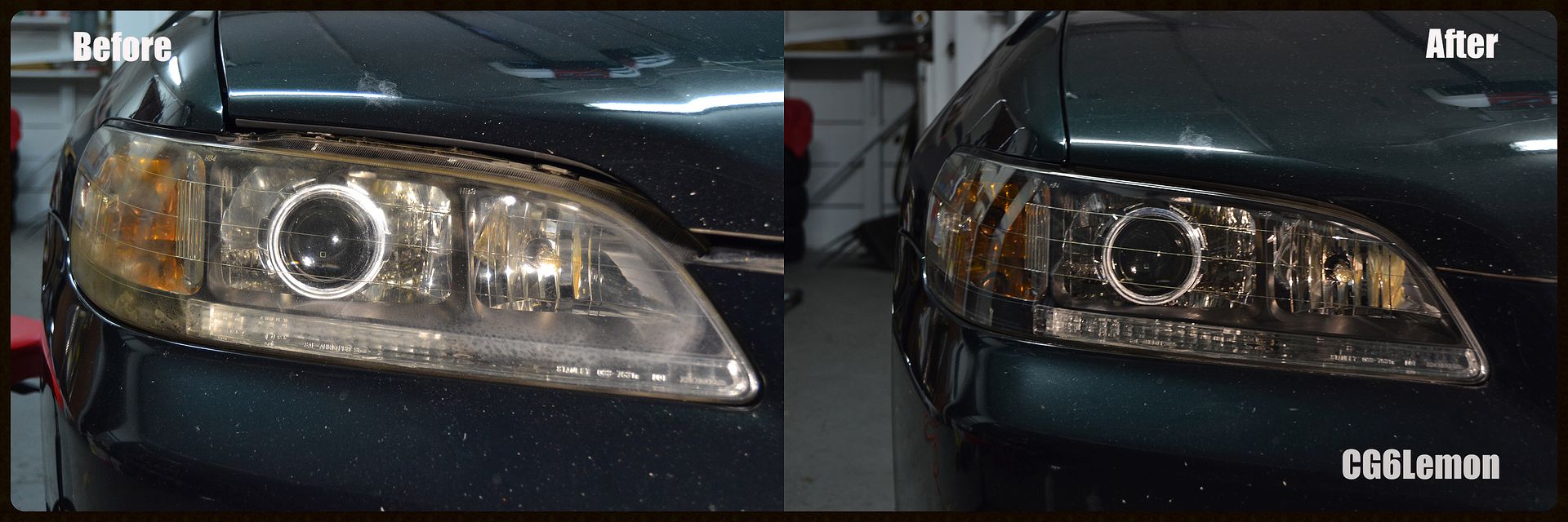

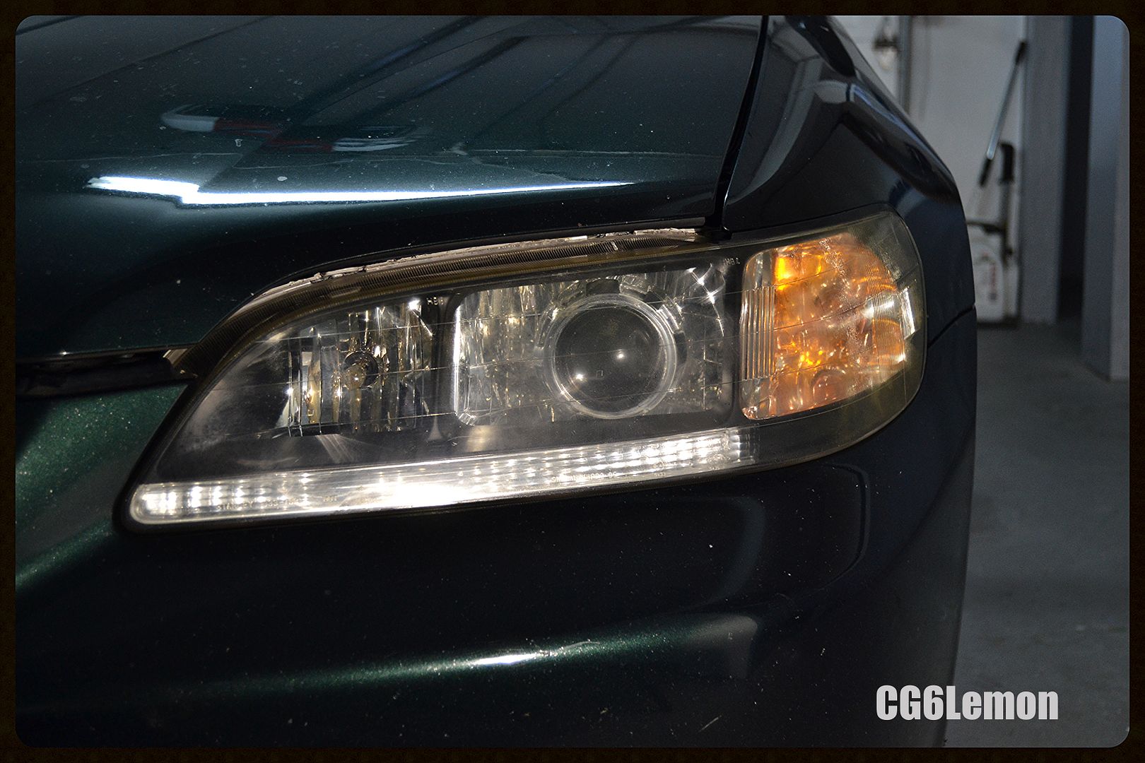

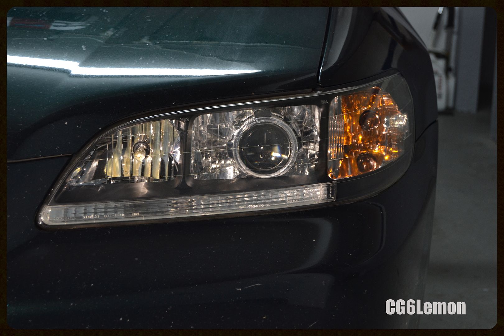

Finished shots

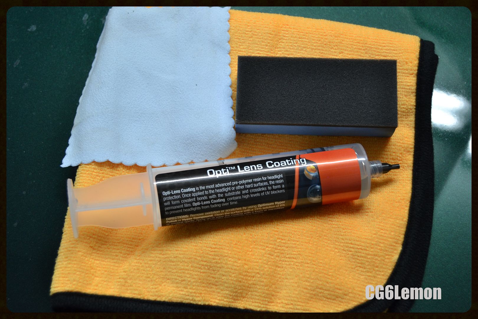

Whenever you sand your headlights, you are removing the thin film of UV inhibitors that protects the headlights from the sun's UV rays. It is absolutely necessary to reapply a layer of protection back onto the headlight to prevent further oxidation. For this reason, I have chose to use a coating by Optimum. The coating will replace what was removed, and is durable enough to last for years to come without any chance of oxidation returning.
http://www.autogeek.net/optimum-opti-lens-headlight-coating.html
One thing I have learned from this ordeal is that refining 800 grit with 1500 grit is too time consuming. I needed 1000 or 1200 grit sandpaper to be more efficient. To those that have made it this far, thank you for viewing my work. As always I appreciate any comments, or questions. I am open for suggestions on any topics you would like to see.
Total hours: 3 hours.

nice write up. though the sanding is fairly typical, the sealant I feel like is often not mentioned, so props! i've also seen clear coat applied after sanding, thoughts?

Thank you. The last step protection is as equally important as the execution process. Applying clear coat is another method which also works as well, but it requires a little bit more tools and knowledge about using a spray gun.
A very good write up lemon, interested to now how much are we looking at total price for everything total. I will be doing this in the near future
Thank you. I would only consider this route if you're looking to do more headlight restorations as a side job to get your money back. It's pretty pricey after you add things up.

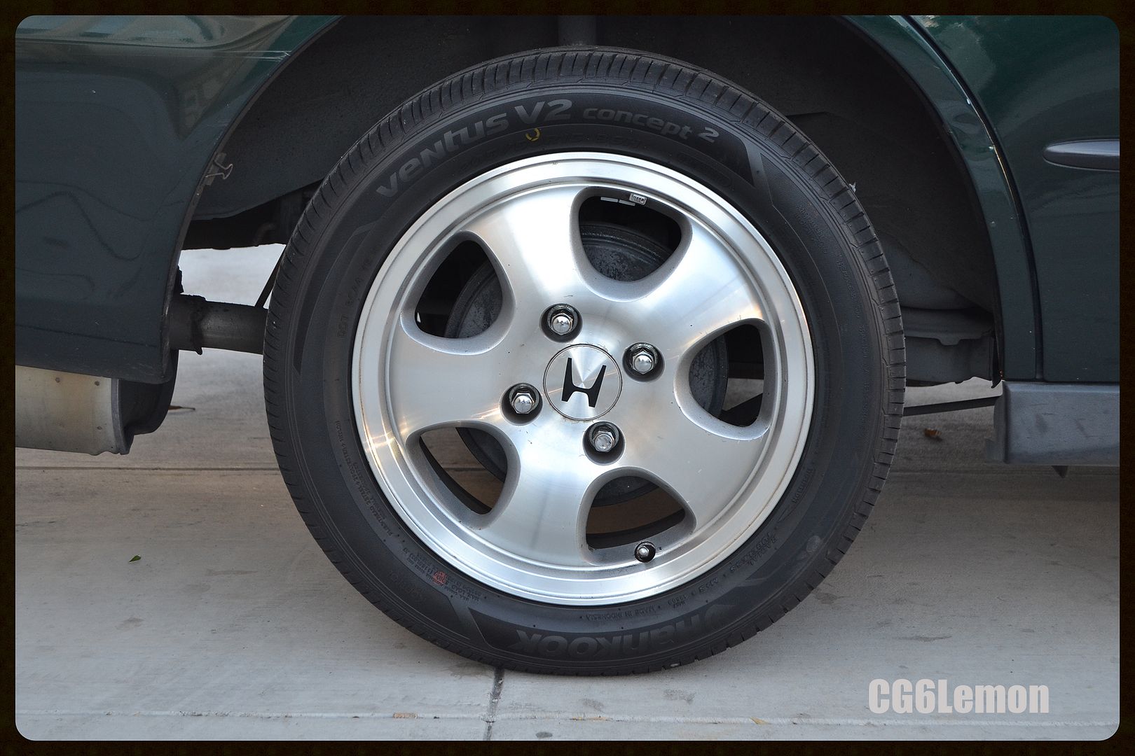

An update on the durability of the water based tire dressing. It's been about a month from last application and this is how it currently looks.
Before
After one month

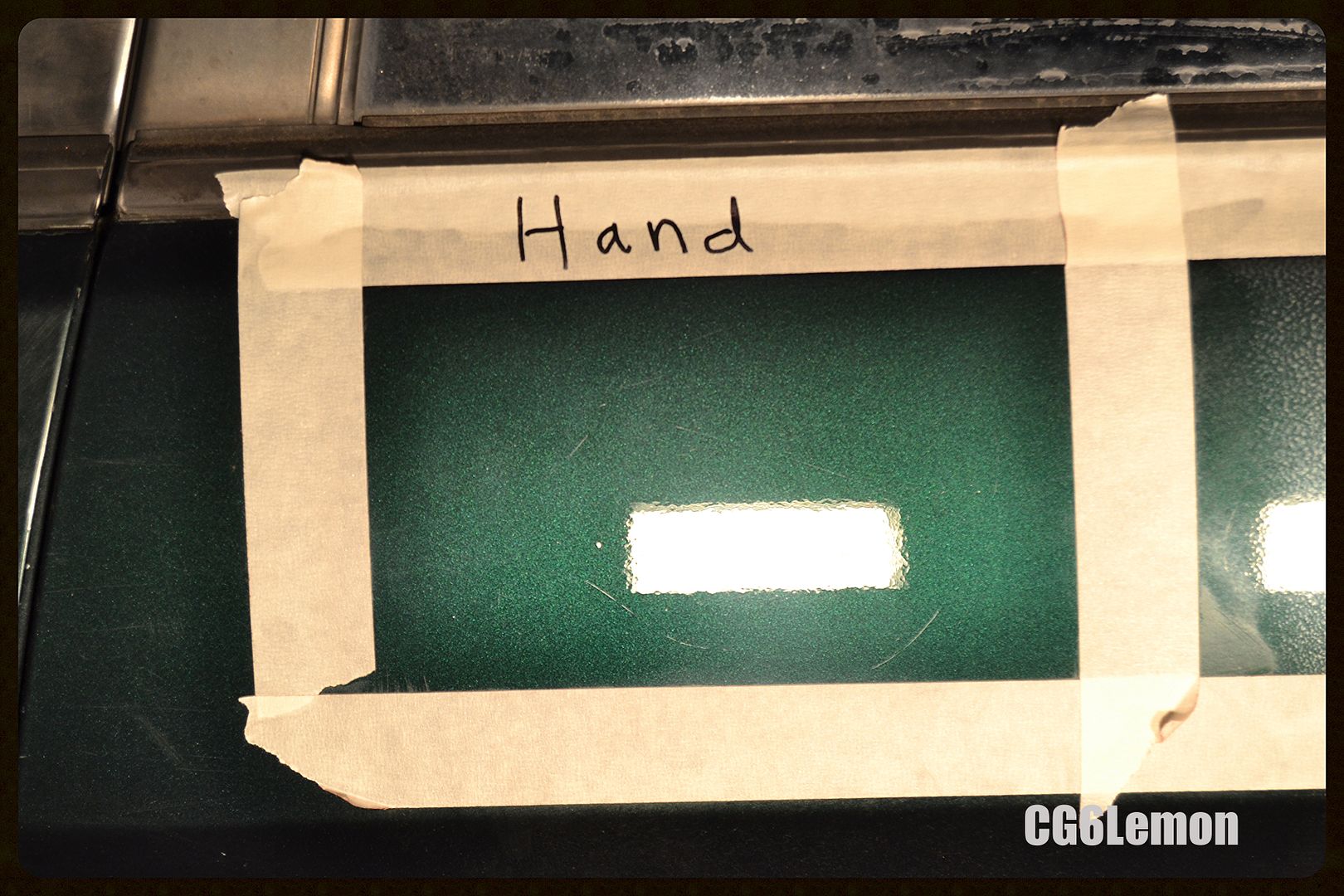

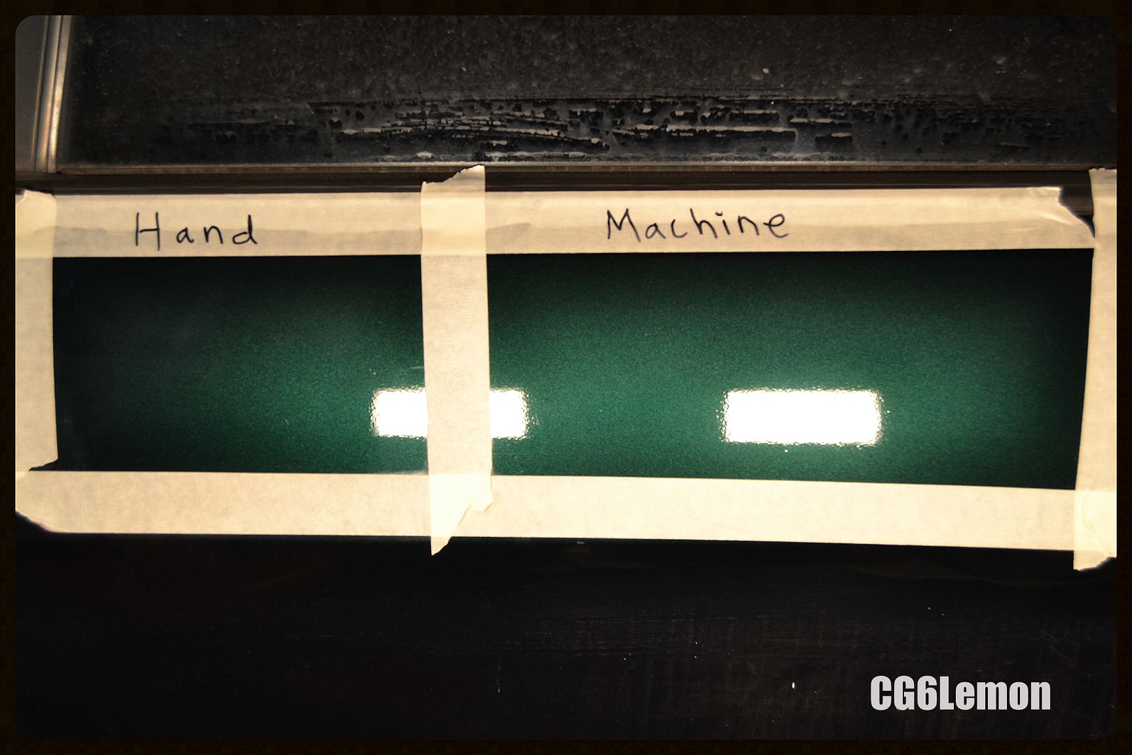

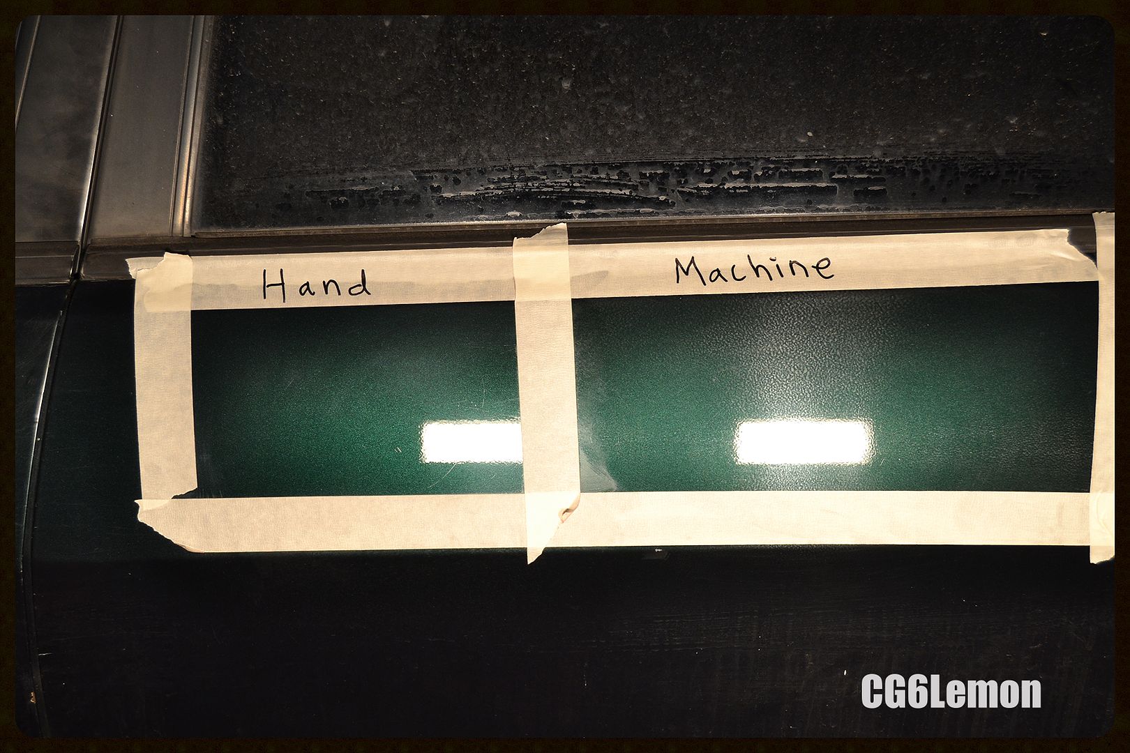

These are just a couple examples that I was able to jot down from my head. But it is pretty clear that both can polish paint, but it will depend on the user to decide which method will be used. Below are some pictures to show as an example of what can be achieved by either methods.

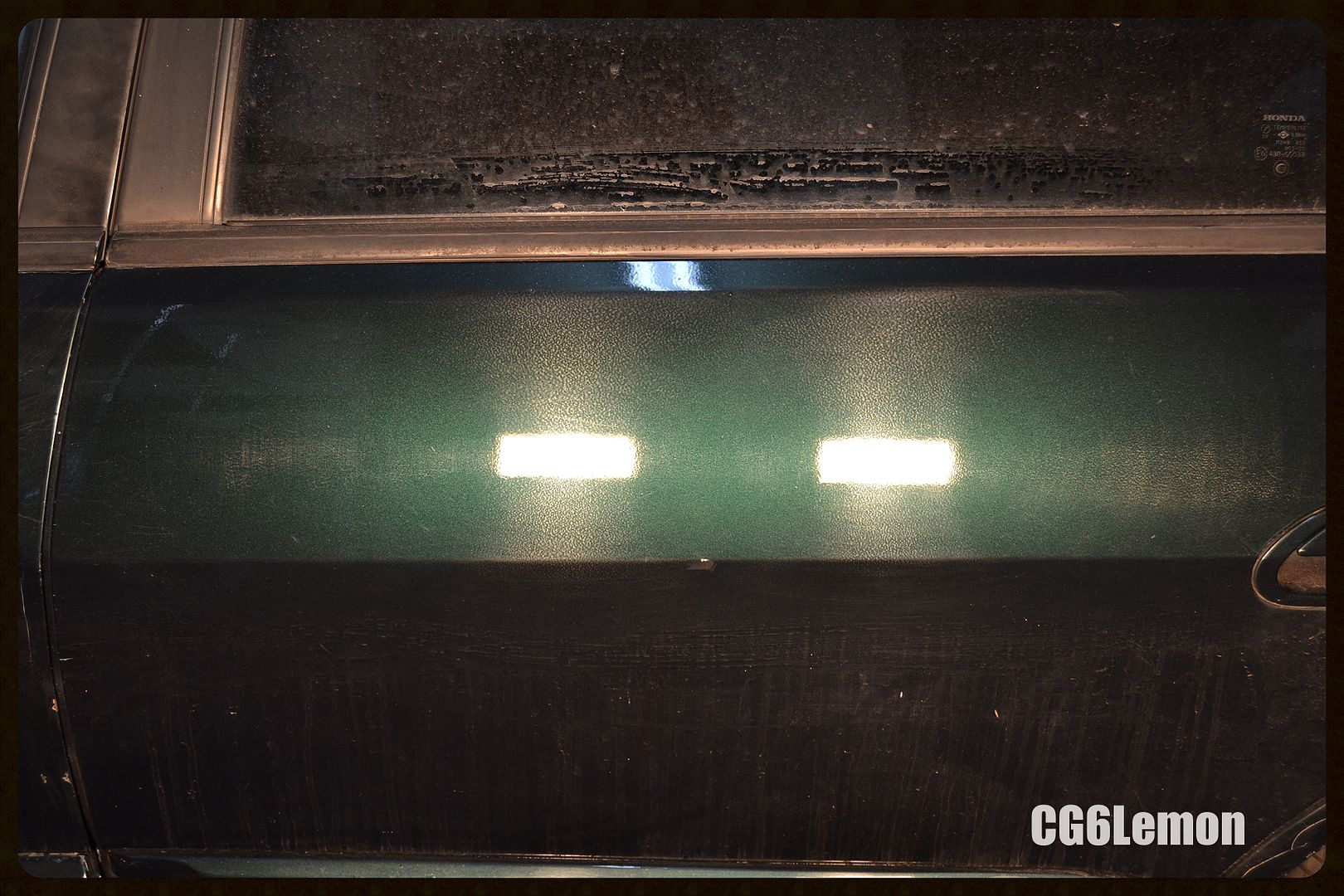

Starting point

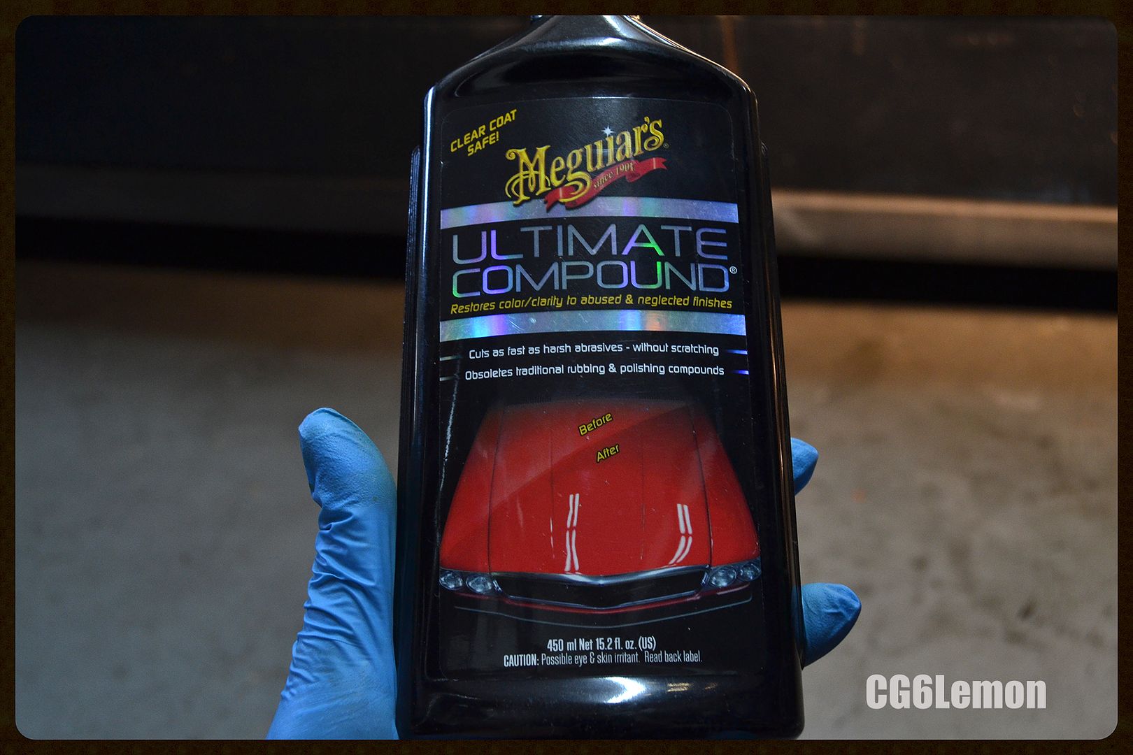

I decided to use a compound that anyone can purchase at a auto parts store.
I taped off two sections to show which side is which, and the results I was able to achieve. This section took 10 minutes doing it by hand, and there are a couple of deeper scratches left over. A huge improvement non the less.
Side by side shot

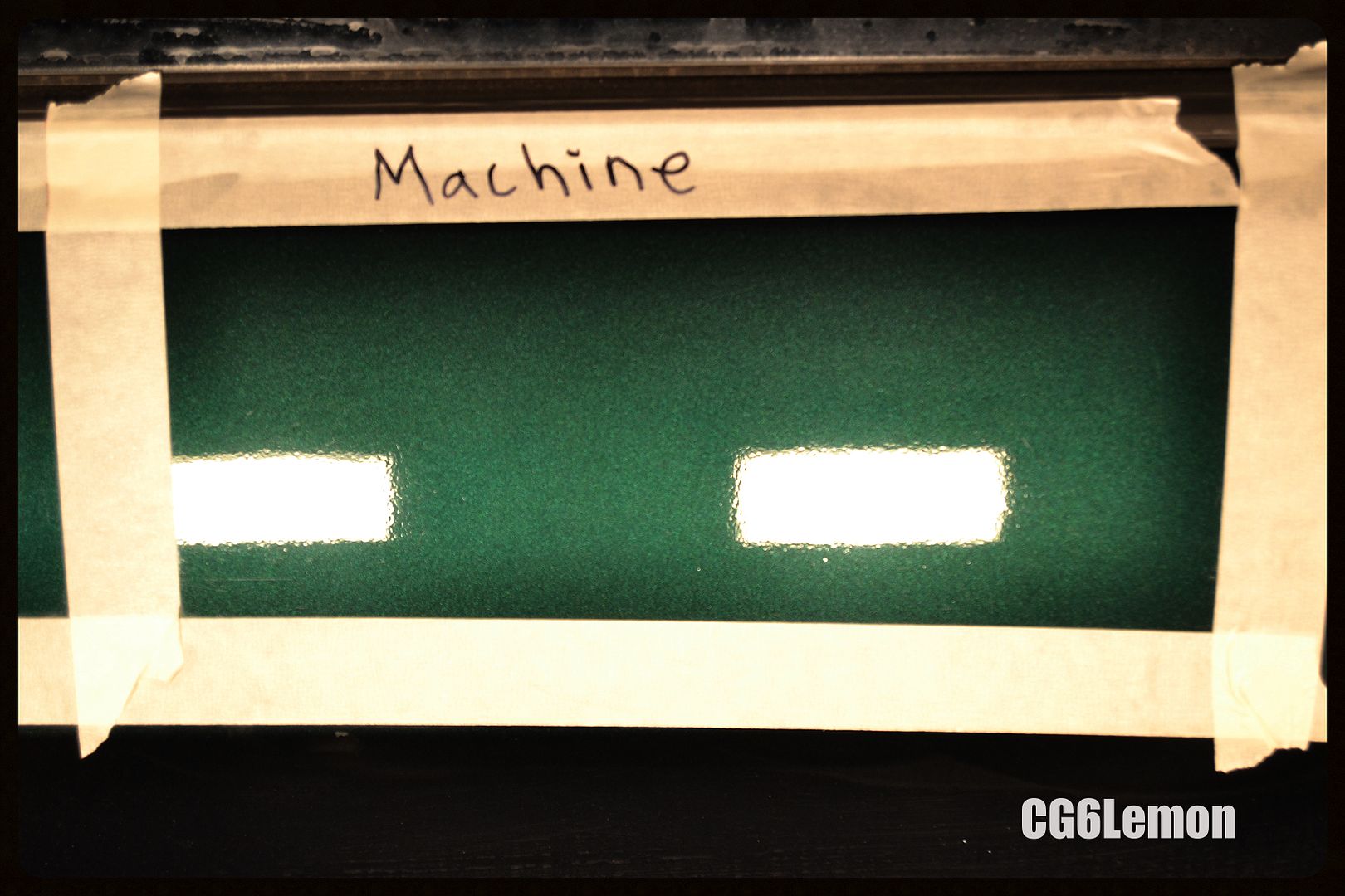

I tried to be as fair as possible so I used a polishing pad, instead of a compounding pad on this section. I got about a 90% correction rate within 2 minutes using a machine.
Both completed
Thanks for viewing. This was a fun demo for me because it's been a while since I polished by hand. It reminded me of the pain, and some areas only polishing by hand will reach so it will depend on different situations. Let me know of any topics you are interested in.
