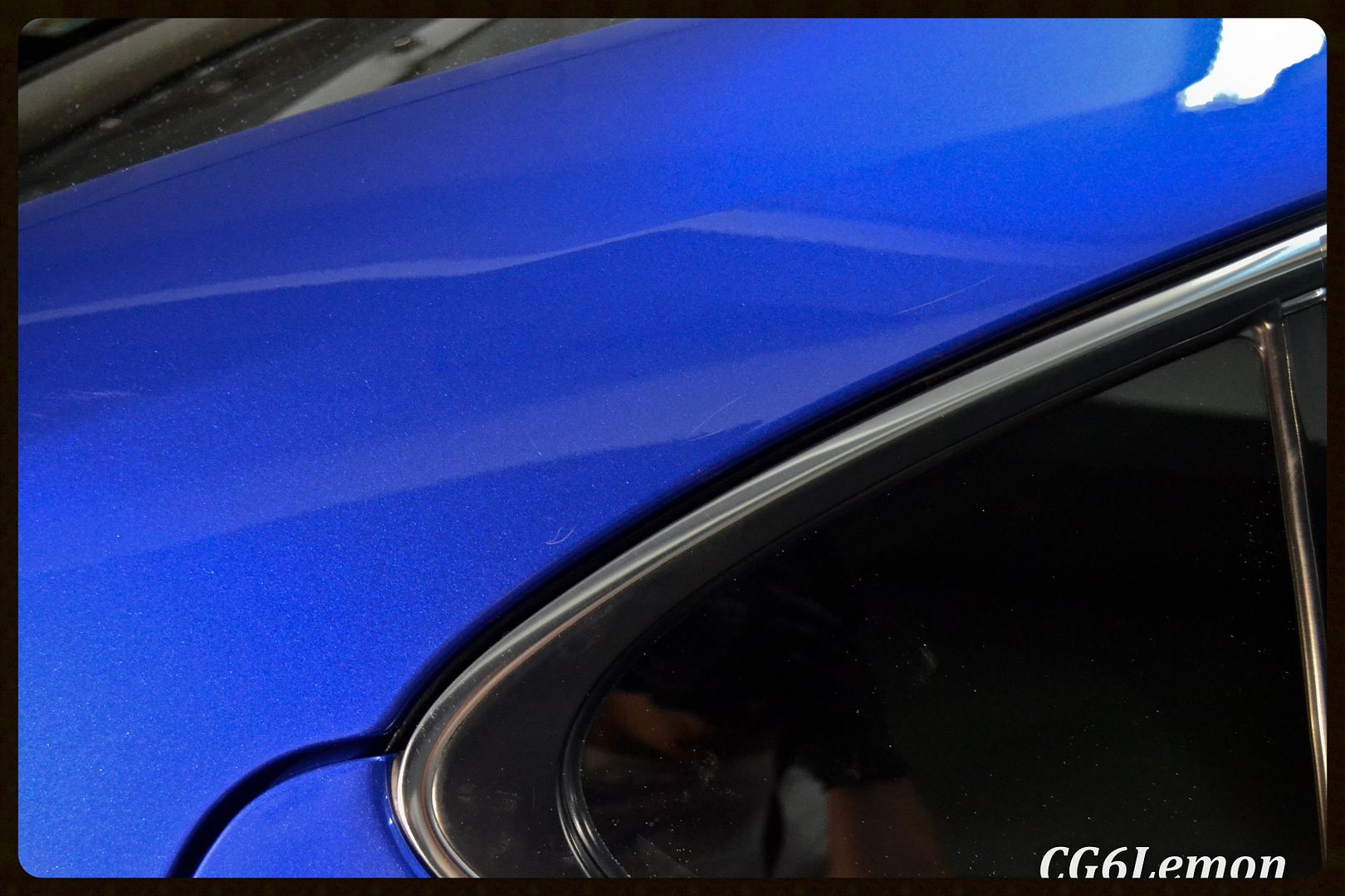

Scratch on roof

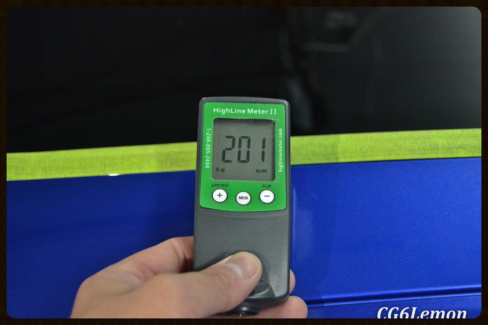

TIP: Always tape off the rubber molding to prevent damage from buffer pad or discoloration from compound & polish

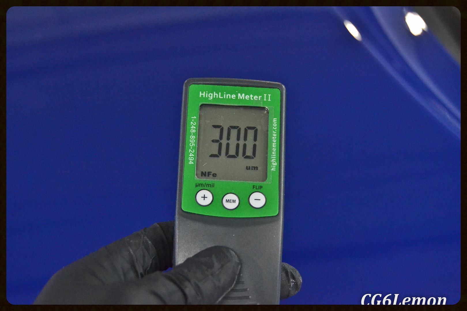

Took some paint readings before I began. Readings varied from 200-300 microns for whole car
Scratch removed using Meguiar M101 compound and Hydrotech cyan pad

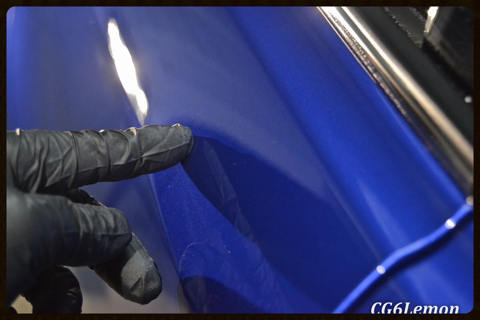

Scratch on door

I tend to tape off edges whenever I am doing extensive correction to prevent burning the paint due to less paint near the edges

This particular model had a very generous amount of paint from the factory. Easily twice the amount I've seen on average compared to other cars.
