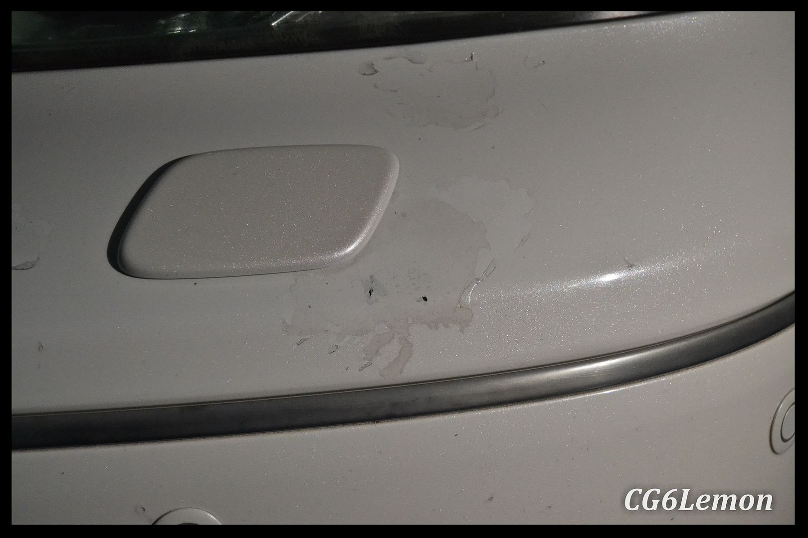

Hey Lemon I have a question. I went through this whole thread (great stuff by the way, thanks!) and I didn't see any info on your way of removing dried on sap. I have 3 spots of sap on my car and have tried different things such as goo gone and even dawn degreasing soap, but have not had any luck. Would bug and tar remover work well? The sap has been on there since I received the car 9 months ago, so no telling how long it has actually been on it. Any help is appreciated. Here are some pictures of the spots:
On my spoiler
On my rear window
On the roof
I always used WD-40, spray it on and let it sit for a few minutes
then grab some isopropanol wipes or put some on a towel and wipe it off
repeat if necessary
Is that safe for the paint?
I found a couple of cars at work with very hard tree sap just like the pictures you've showed. I was able to remove it with a method using solvents. I will post it tomorrow because it requires a bit of typing.
repeat if necessary
I have not tried using WD-40, but I do know using IPA straight will work. Becareful not to let it dwell long though because it can soften the clearcoat.
I usually can get if off with a clay bar and quick detailer spray, may take some time though.
Clay and quick detailer spray will work on fresh/semi fresh tree saps. +1
