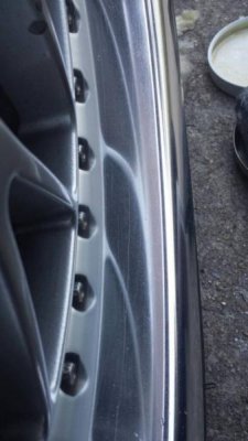

tried polishing a lip again. used both mother's mag/alum polish and never dull. basically no black residue. I even put some polish on some 0000 steel wool and nothing changed so they must be either clearcoated or anodized.
here's what I'm up against
obviously the scratch is a whole nother story but its that hazy look to it that i wish i could get rid of.

Looks like they have a clear coat on them.

Jon, since you did a test spot with the 2 methods, and you did not see any black residue coming off, you have clear coated lips on your wheels. It's a good thing, and a bad thing haha. The good thing is it requires much less maintenance. For example, Chris's wheels are uncoated, which is why he has to keep polishing them up to get "That Shine Back". The bad thing is, no matter what you do, the lips will always have "a little milky/hazy look" to it. That's how they were manufactured. (I did some research on that part) It cannot look like Chris's wheel in comparison.
Now that you've figured out it's clearcoated, you may use finishing polishes, polishes, and compounds on the "lip", just like you would for the paint on your car. Now here is the tricky part. The amount of clear coat on a vehicle is not the same as an aftermarket wheel. It may be thinner, or thicker than the clear on a car, and cars these days have "very" little clear on them straight from the factory. What I would recommend is using the least aggressive method and work your way up. Use a finishing polish first with a microfiber towel, if doing by hand, then see if you can correct any defects. Then slowly move up the aggressiveness, and remember you cannot keep polishing the lips forever because eventually you will go through the clear if you do it very often. Do it once, and try to take good care of it by applying a sealant, or a coating, to protect the surface, and do weekly washes to maintain the finish. Hope this helps clear some things up. :thumbsup:

Chris, you are correct. Any updates on your wheel project lately?
