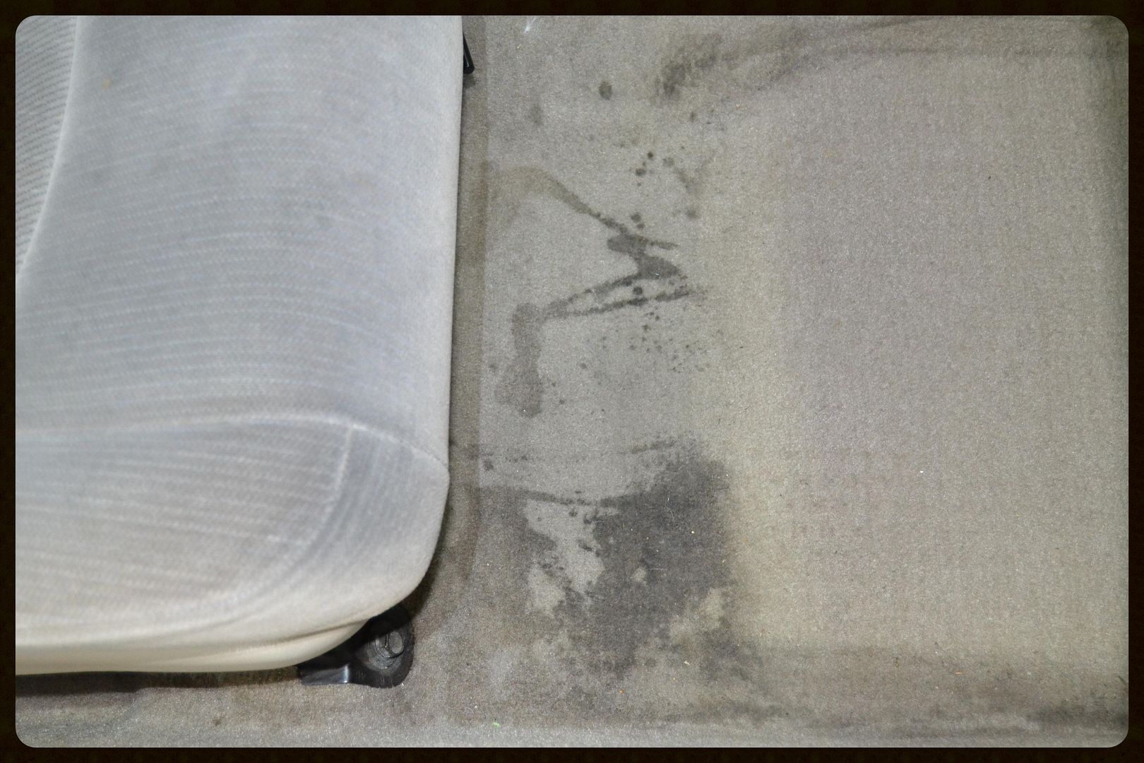

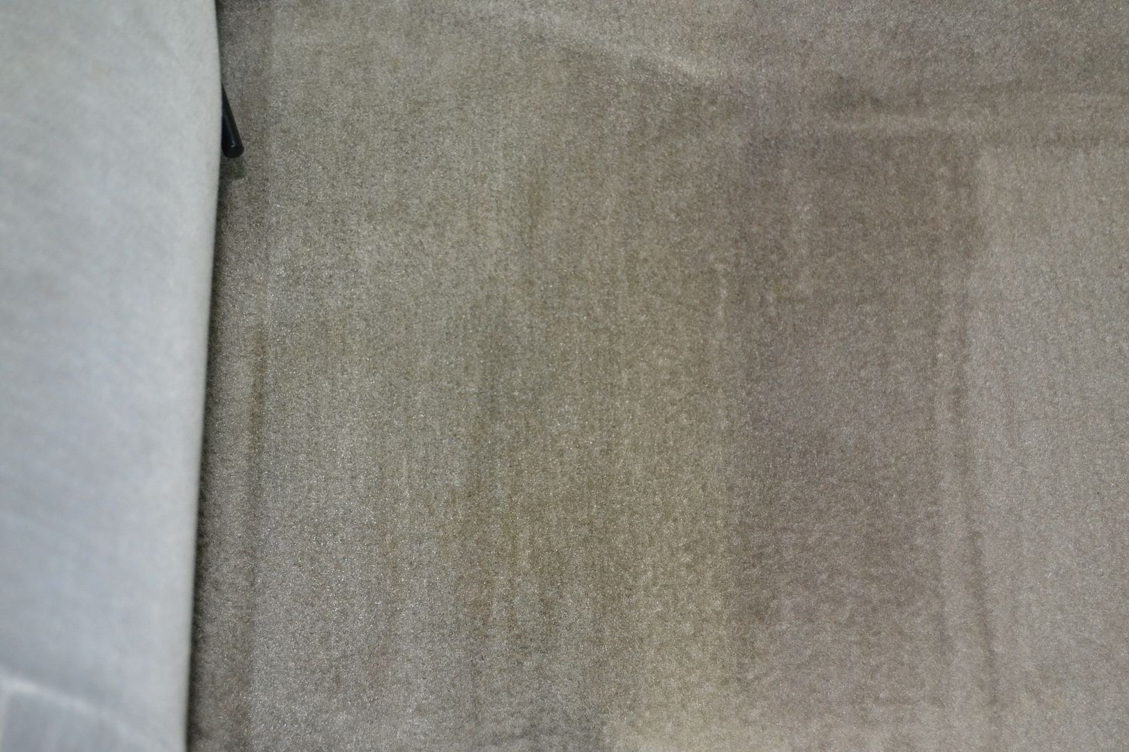

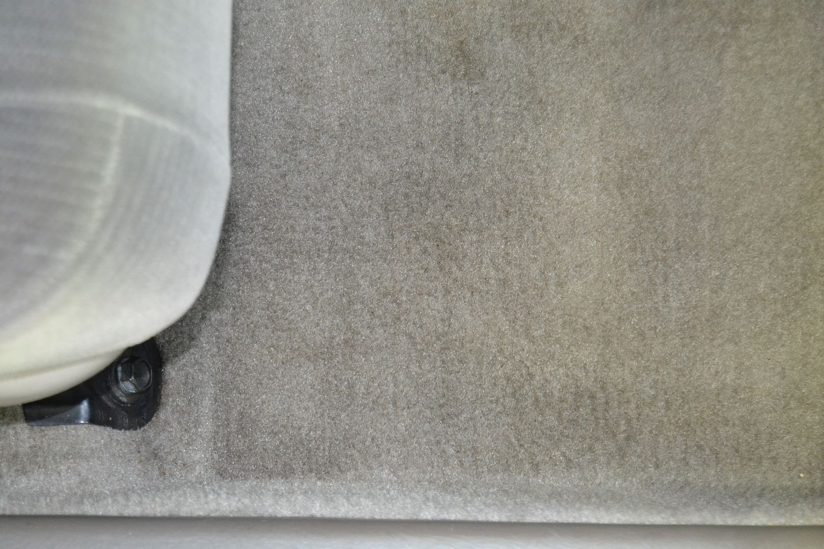

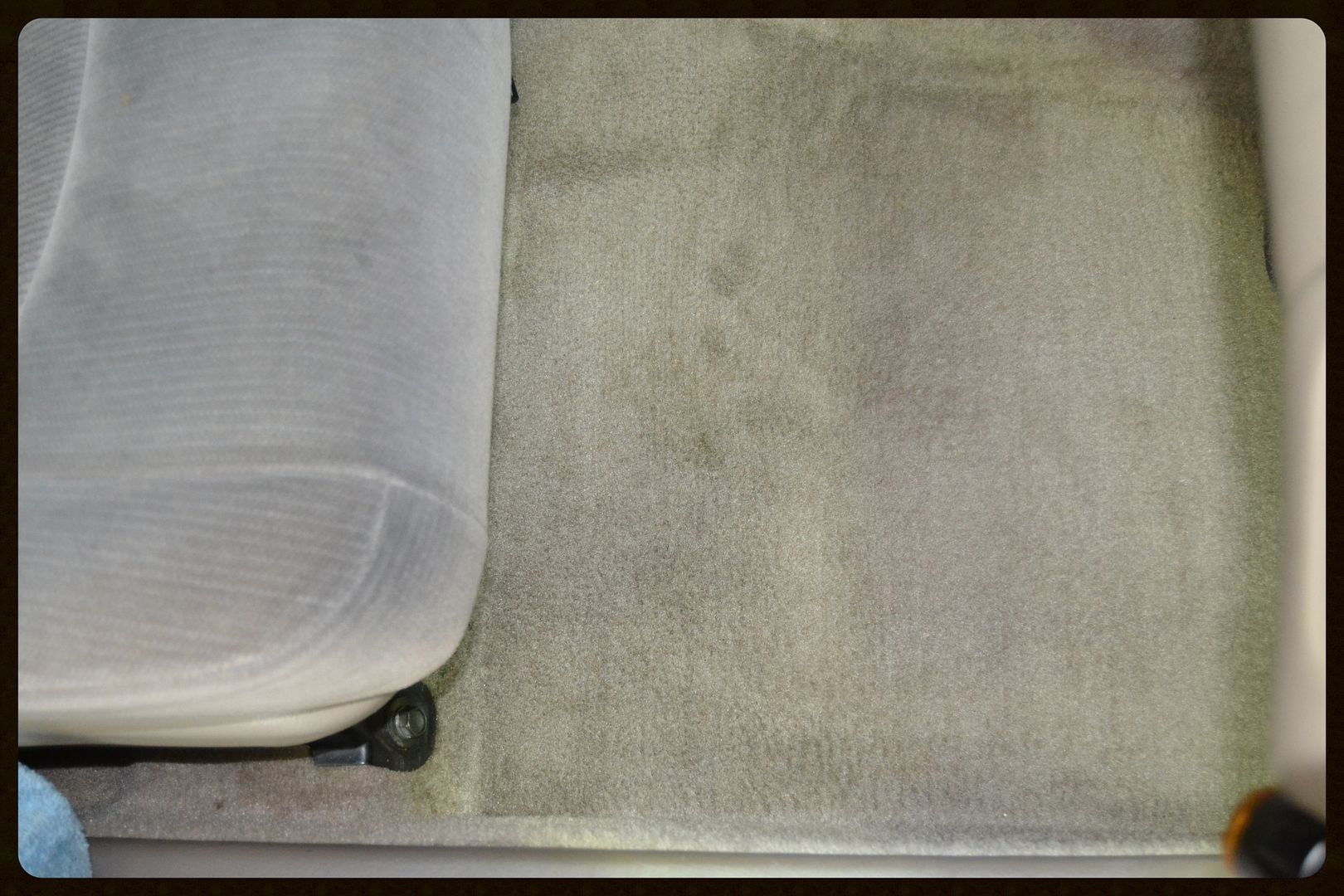

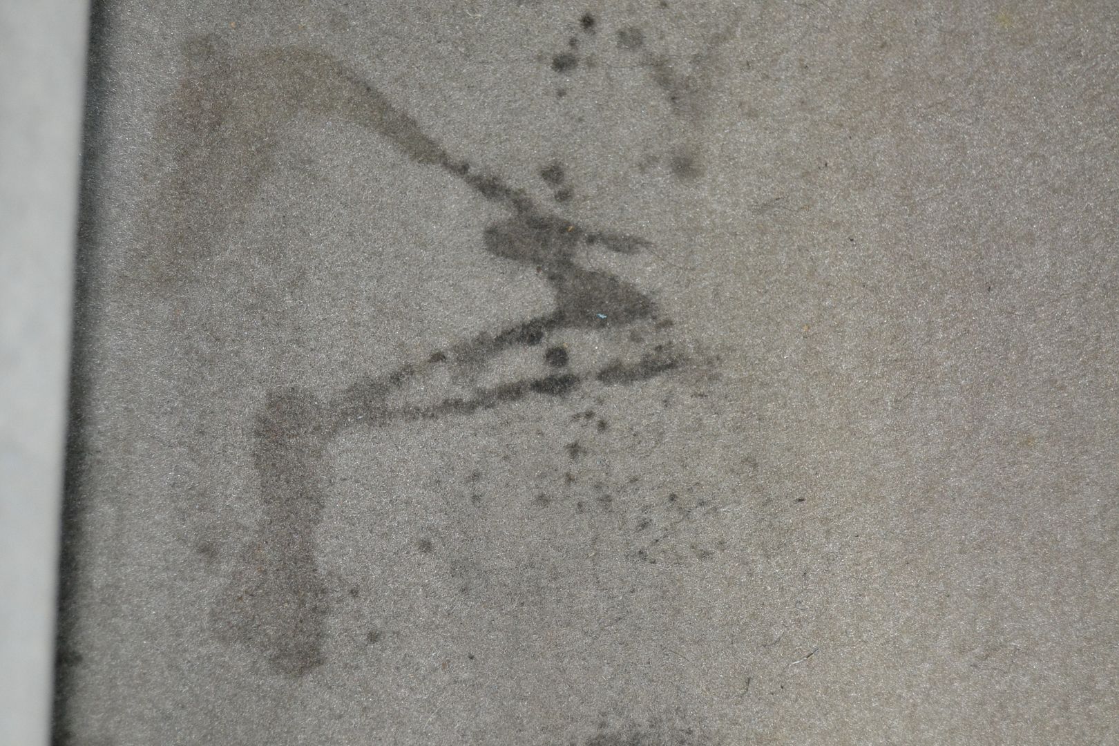

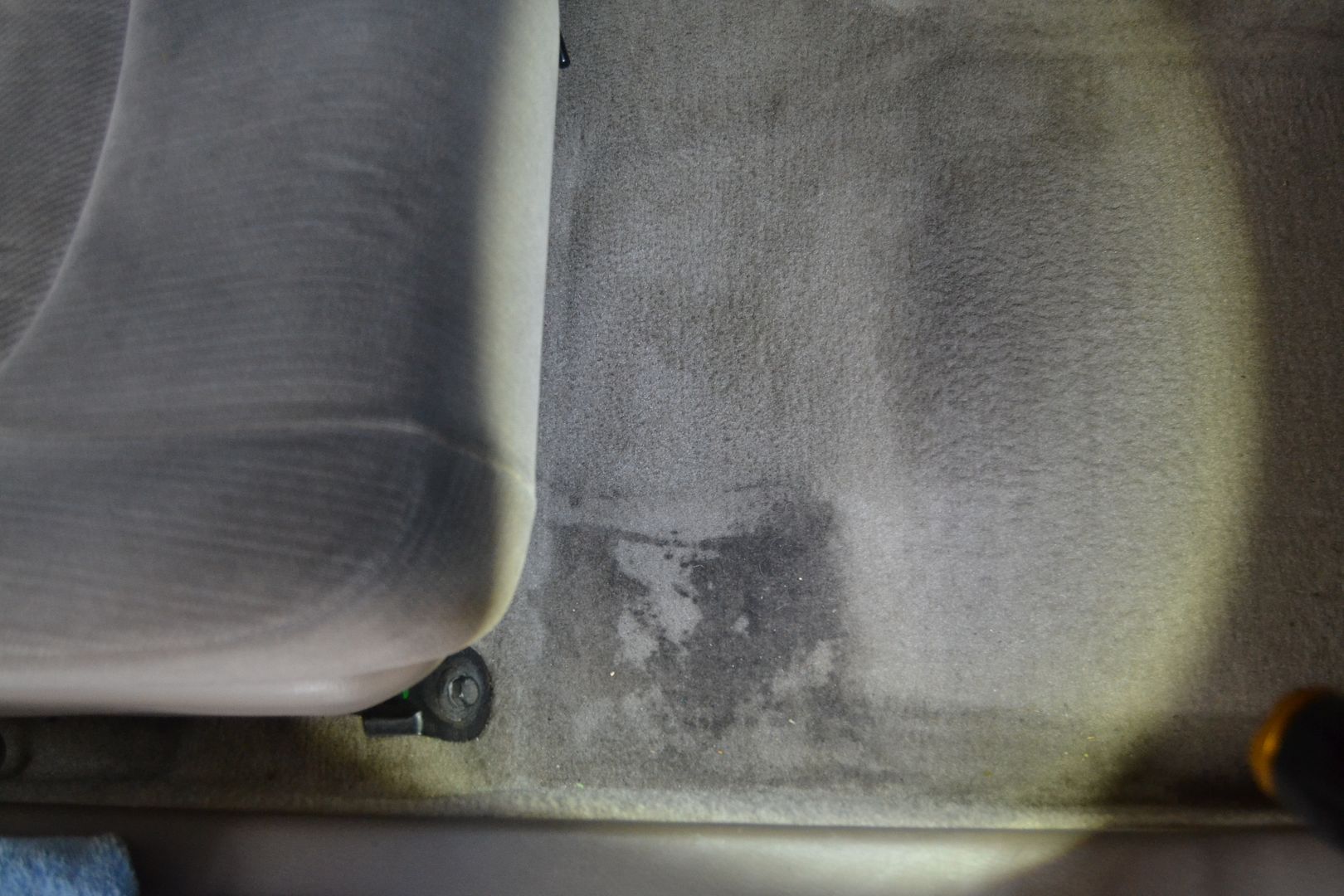

I have some pictures to contribute as well. I was going to clean a spot on my carpet to show a member the potential of a hidden gem. Well, here it is.
Before
Two areas with what I consider really bad stains
Zooming in
Done
Zooming in
After
Halfway done 50/50 shot
Aftermath
Process:
Vacuum as best as you can
Spray Folex and let it sit for 2minutes
Use a very stiff nylon brush and brush it Left to Right, then Up to Down
Wipe up as much as possible with a towel
Vacuum up as much moisture as you can(Better with an extractor)
Let it air dry or use a cooling fan to speed up the process
Any comments, questions, or suggestions, feel free to leave a remark. Thank you for viewing.

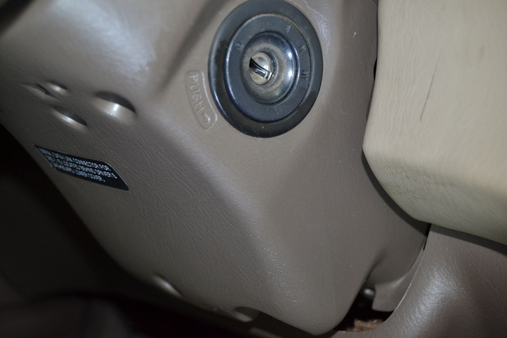

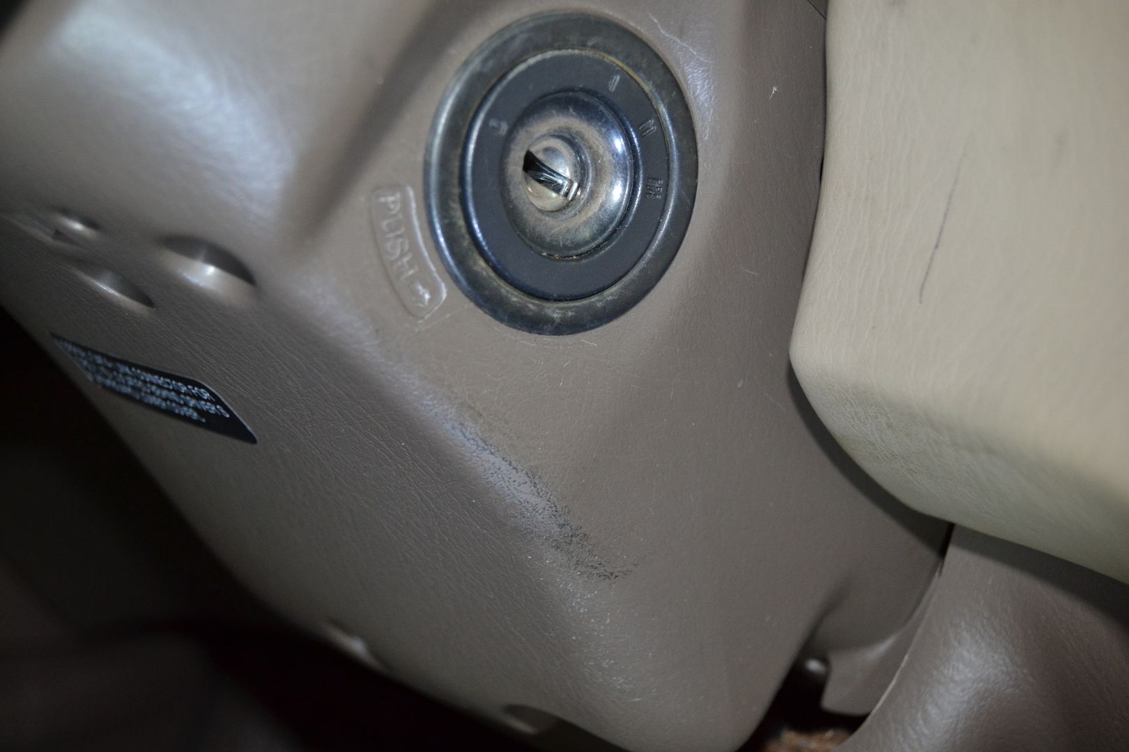

Just a couple pictures of what an Over The Counter product can do for your interior. I like to use Zep Heavy Duty Citrus Cleaner for interior vinyl, and plastic surfaces. An ideal product for weekly maintenance wipe downs, but can also be diluted to stronger ratio for stubborn stains and marks.

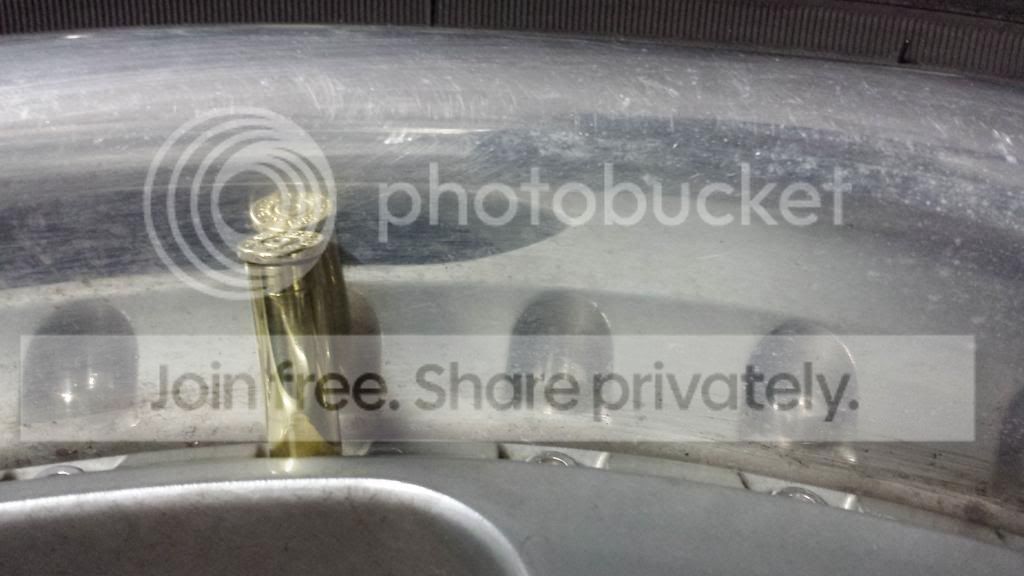

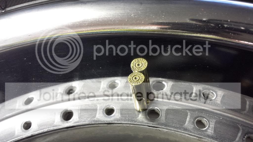

Finished one more wheel today.
Before
After
2 more to go! Polishing is a pain in the as$ (actually its a cramp in the hand)

Looks good Chris. The distinction of image is much more clear, crisp, and reflective. You looking to invest in one of those Mothers Powerball? Might be less fatigue on your fingers. :lawl:
