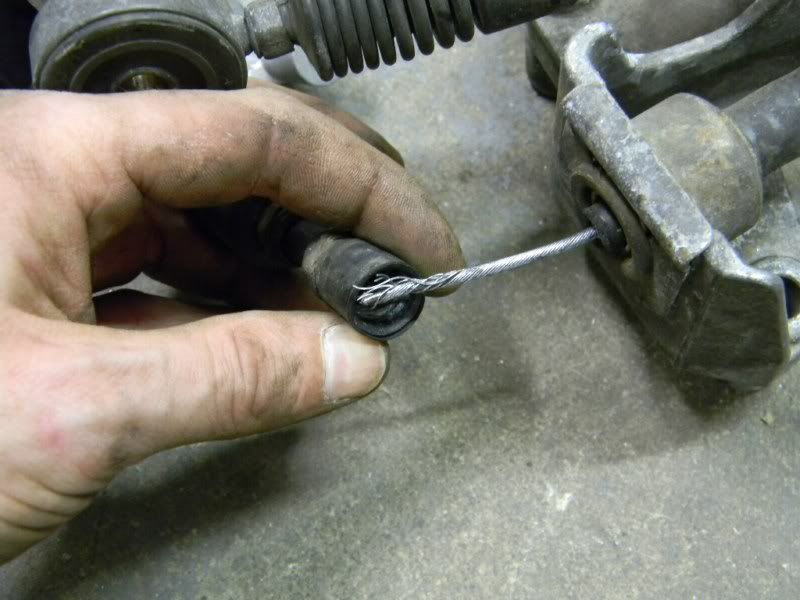

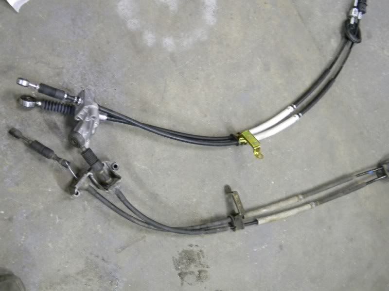

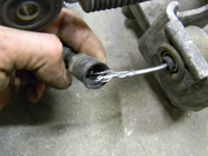

I had to swap out my shifter cables yesterday. The old ones had 214k very hard miles on them.
I went all the up and back to Vermont to go skiing on sunday knowing that they looked like this:
Even though this pic is a little blurry, you can kind of see that there was only like 5 threads left in the cable.
And the new ones:

now was it fraying and thats why you replaced it or because the boot was failing?

Both I guess. Im not sure which happened first, the fraying or the broken boot. I just know that once I saw that, I knew it was on borrowed time and replaced as fast as I could. But not without putting an additional 600 or so miles on it. I had to ski, ya know?
