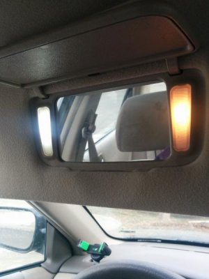

Working on changing out all my interior lights, the vanity lights came in today so I installed those. Waiting till it gets dark so I can compare brightness. I'm really happy with the color though, they are very white.
