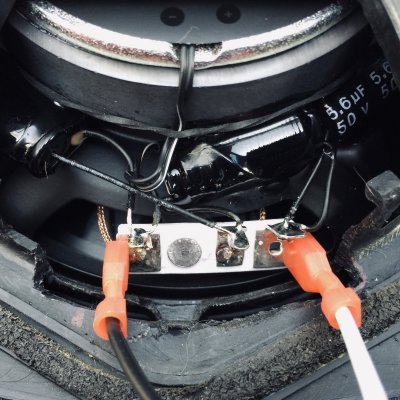

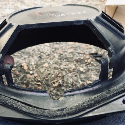

I have decided to go with a 1 DIN Alpine head unit and a Clarion EQ instead of the stock head or an aftermarket 2 DIN head. The issue was that the Clarion, while pretty decent, is only a 1/2 DIN unit. Recently I found a cheap dash kit for just such a setup. I was afraid that I would have to fabricate some abomination for the Clarion out of a sheet of ABS from the hobby shop. I could have made it work, but this is much easier and not much more expensive. Make no mistake: this is cheap, and it will need some hacking with a Dremel and some fabricated steel straps. But I can do that, and the face of the stereo will look pretty decent.
The Clarion has a face that extends about two millimeters beyond both the right and left edges, for whatever reason. If I Dremel these down the whole thing should fit flush in the facia and then I can figure out how to mount it to my Alpine head. The Alpine Power Pack mini amp will fit easily behind the very short "mechless" head and this small EQ box. The sub amp will probably live on the side of the sealed box in the trunk. Not sure yet. But at least this is real progress...
Here are some pics of the dash kit with the EQ, and some pics of how I had to Dremel the door speaker baskets to fit my preferred Polk Audio db652 speakers. (The Kicker deck speaker screw holes had to be ground with a Dremel grinding stone - a lot - and I forgot to take pics. If anyone wants to mount a pair of Kicker 43DSC69304 6x9s in the deck, message me and I will send photos so you can see what will have to be done.)
The Polks ended up being more-or-less drop-ins, but not really. I chose them because I could retain the stock baskets in the doors. These fit, but to make room for the electronics on the back you have to remove some of the basket. You also have to mount your screws exactly like I have shown. When they say, "They only fit one way, so you can't mess them up," they need to include something like, "They look like they can fit about a hundred different ways, but only one actually works - good luck, sucker!" HAHAHA!!!
Seriously, the db652 speakers come with a bizarrely shaped adapter ring that seems made to fit between the speaker and every car door made by mankind since Henry Ford started his cookie-cutter process way back when. In our 6GA cars it is NOT NEEDED, AT ALL. The speakers mount directly to the basket. The fit is great once you cut away the needed material. The door card fits over the speaker just fine. It is tight because the new speaker protrudes about a quarter inch further. The tweeter is flush with the surround, so it does not contact the plastic Honda grille at all. The sound is nice, but a little bit weaker than stock, these speakers have a sensitivity of like 92 or so, so they work well off a stock head, but they really want some extra power. I like them and can't wait to get my head and amp installed.
One last note: The long screws provided by Polk were about three millimeters too long and protruded through the basket and would have prevented its gasket from sealing. I Dremeled off about two threads of length and then rounded the new ends. They worked in this form perfectly. The short screws and the Honda screws are way too short.
EDIT: Hey, my photos made me realize that I put the top screw in the wrong hole on the right door speaker. (The driver door speaker is mounted correctly.) Oh, well - it threaded in securely, so she stays as she lays, I guess… BAHAHAHA!!!
