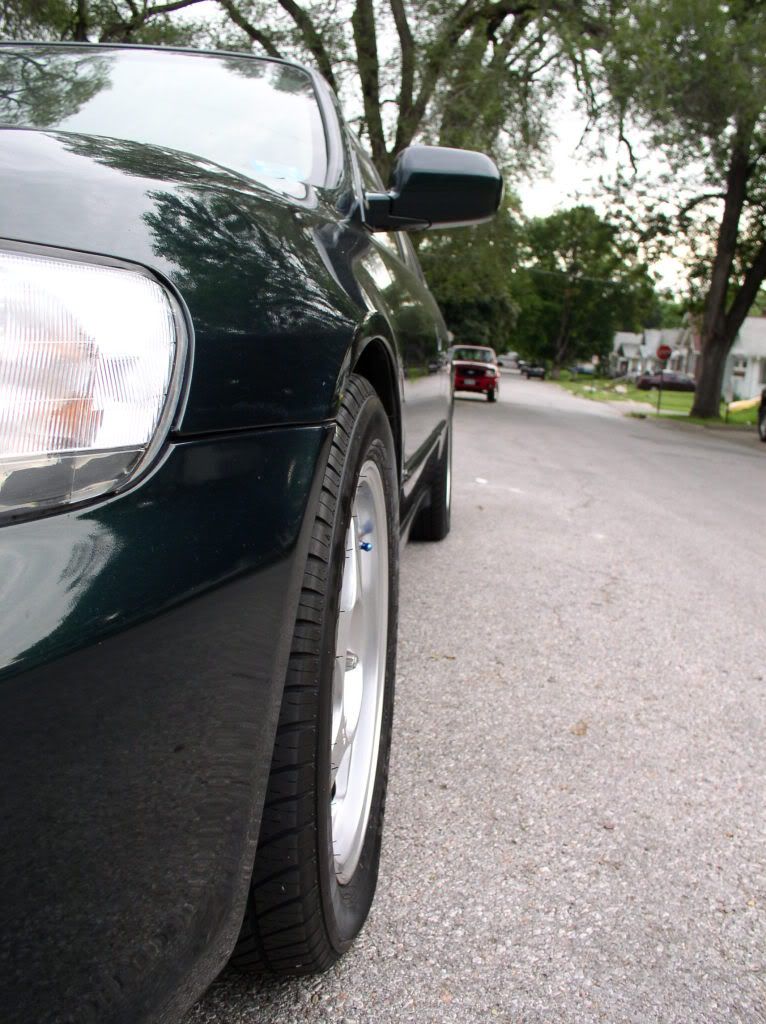

For starters on this please post a picture that shows how the wheel and tire fit in relation to the fender lips. This angle works well, so do several other angles. You may want multiple pictures if it is a real tight (aka: good) fit.
![](/forums/proxy.php?image=http%3A%2F%2Fimg162.imageshack.us%2Fimg162%2F2977%2Fdsc01233si3.th.jpg&hash=804f54a86eaa9954c6186e75ebabe995)

example of good wheel fitment, though the rears could use a 5-10mm spacer.
