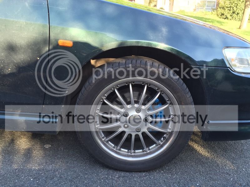

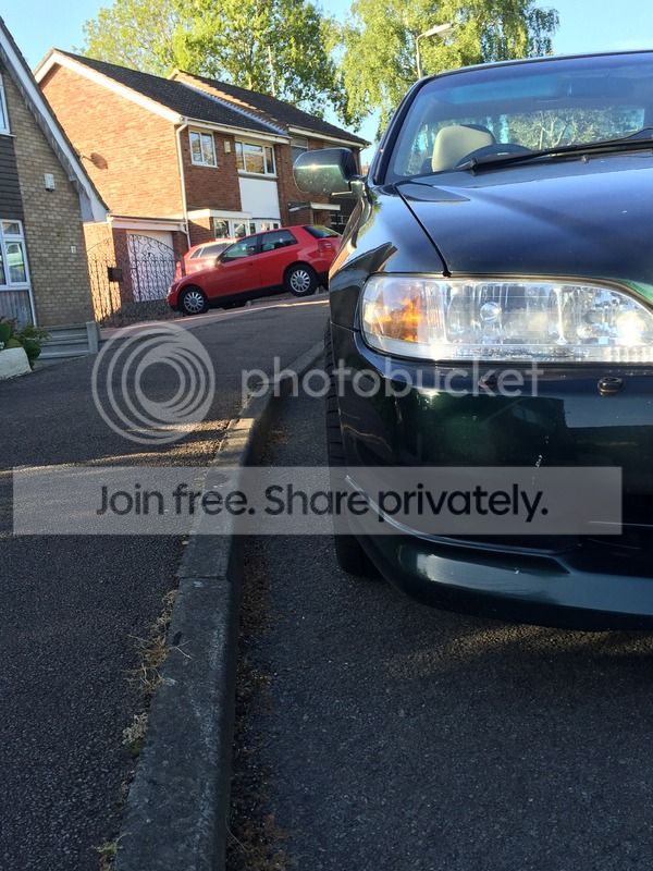

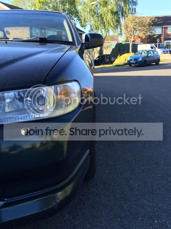

here are a few pics of the front of the car you can see how high it seems to sit from the drivers side front wheel yes it really is that high and those are 17" rims also if you can see it the camber is way out with the top of the tyre appearing further out than the bottom
