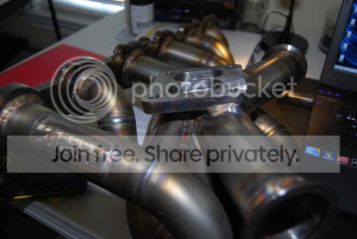

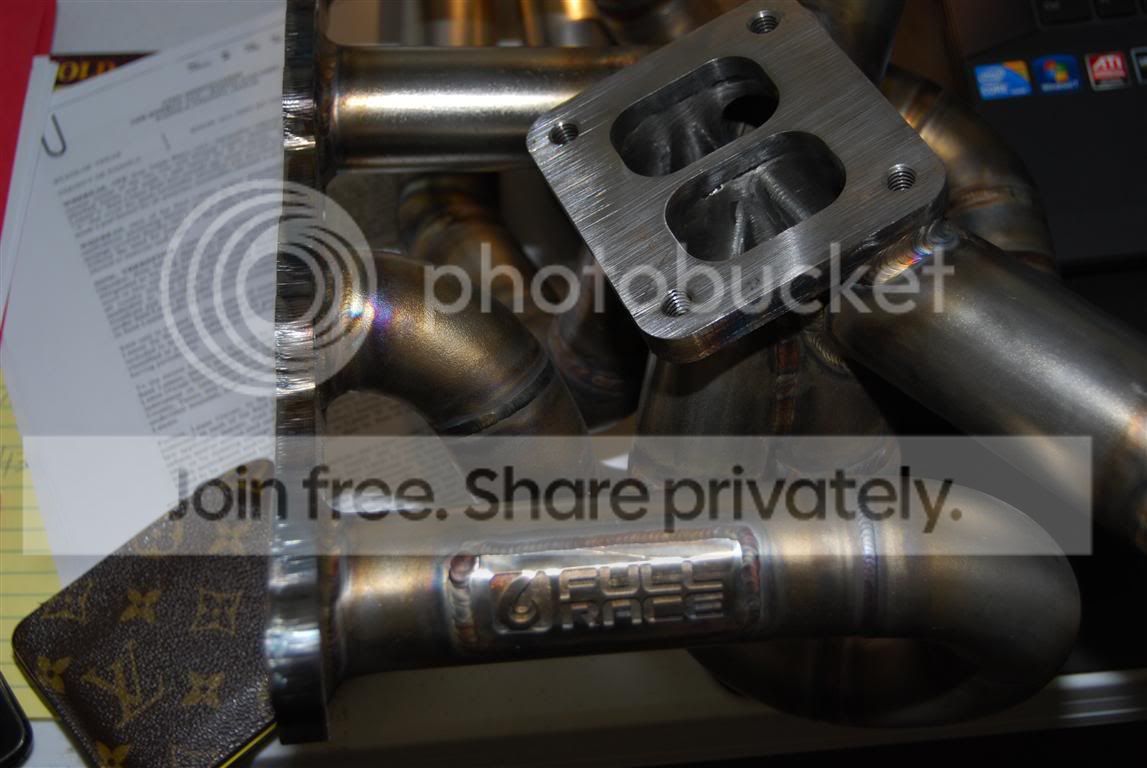

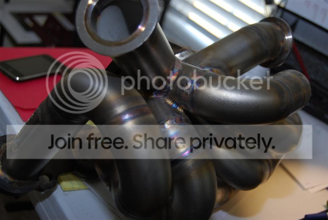

I wish I could go lower, but I can't. The "new" front sway bar actually is the lowest point on the car, and it is literally 2" off the ground...and just above that is the oil pan. I'd rather scrape the sway bar than the oil pan!
The exhaust will be handled shortly.
I have a full-race ($2800) manifold ready to go on, but I will get a 4" downpipe and 4" exhaust (back to a dual 3") made at the same time.
