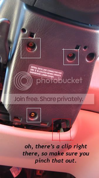

Okay, so first, you can either take off the bolts on the side (referring to the cruise control / audio buttons) OR you can do what I did and go for the screws in the bottom.
Since we're doing it .. MY way, we'll start with the ones in the bottom. Take out the screws that is indicated below in the picture.
Then, from there, you just .. forcibly take off that bottom part. It takes a little bit of effort, but it'll come right off. I didn't take a picture of it, but whatever.

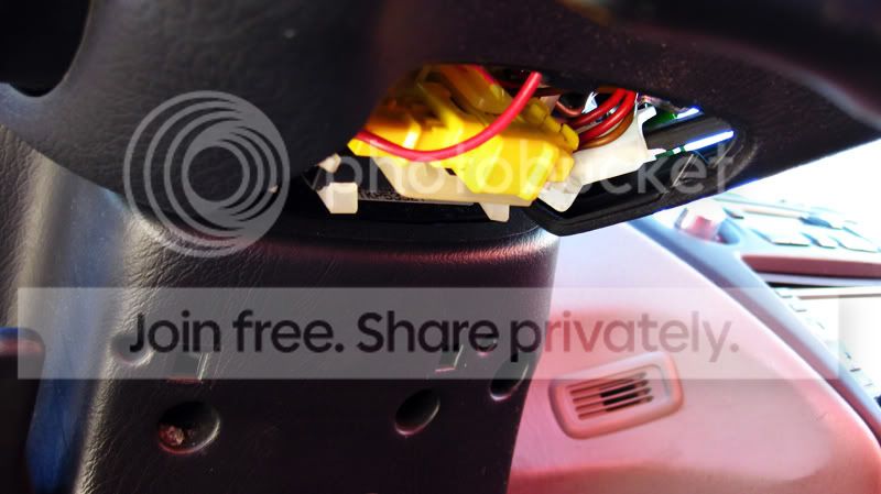

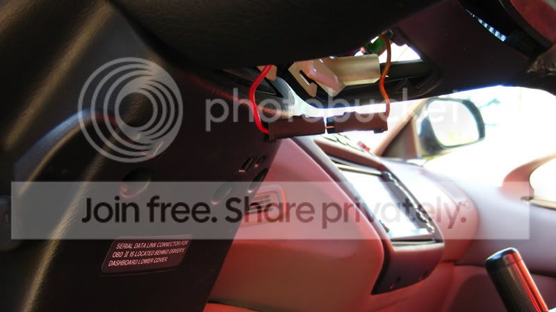

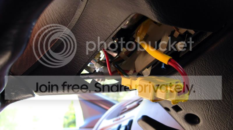

Take your flathead and take off the plate beneath the steering wheel.
From there, take out the yellow plug (fig 2.2) and there's another plug to take off, shown on Figure 2.5.
Fig 2.2
Fig 2.5

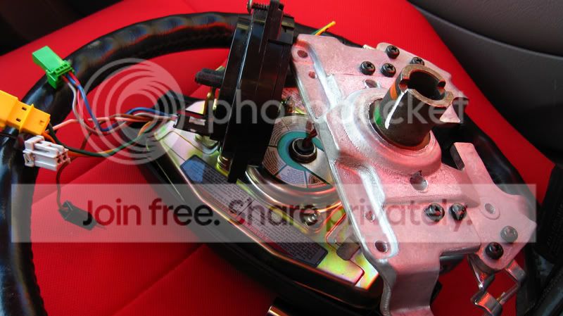

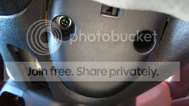

After that is done, we're gonna proceed to take off the airbag portion of the steering wheel.

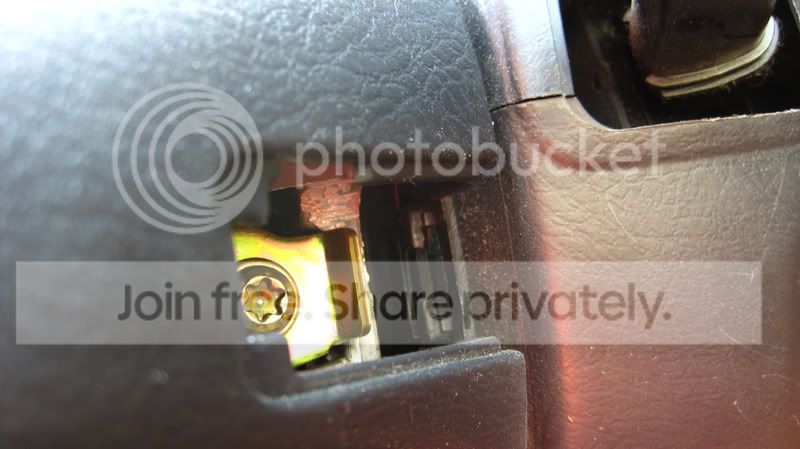

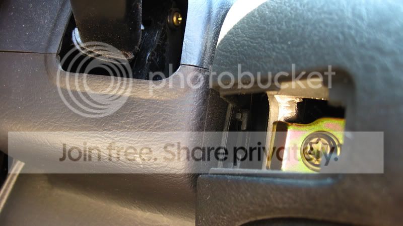

On the side of the steering wheel, there is a visible plastic cover. Use your flathead to take it off.
Then you'll see the torx screw. Like so..
Left side:
Right side:
of course, then you'll use your screw or whatever you want to use to take it out.
Ta da! It's out!

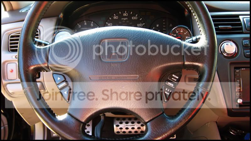

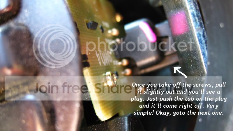

If you have the audio &/OR Cruise control.. look on the side of the controls and you'll see some screws there.
This is how it should look:
Follow instructions on the picture.

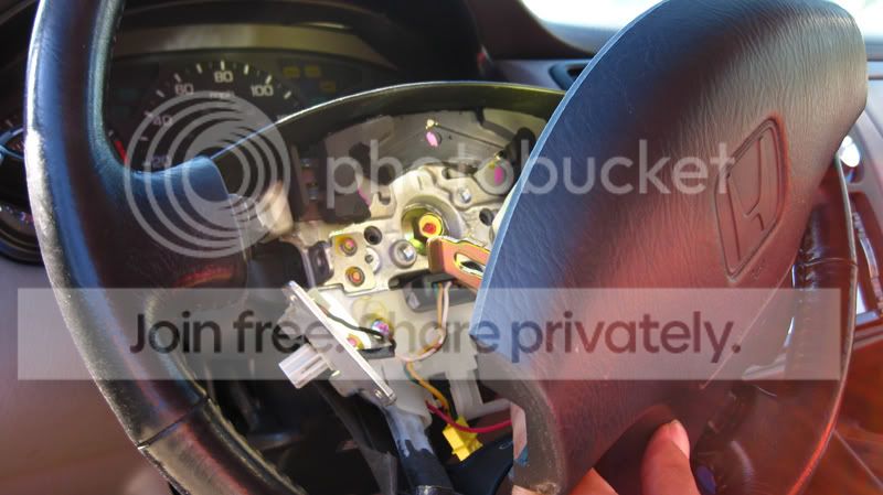

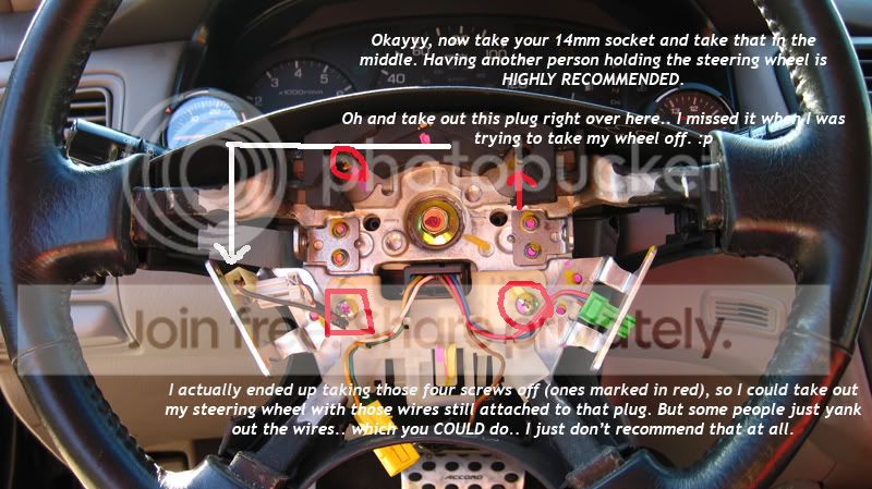

Step 4: Alright, almost there to the end. After you've unplugged the audio / cruise control.. or have just taken off the torx screws, grab the airbag part and just tug on it to take it out.
Okay follow the instructions from the picture again!
After that.. you should see this sucker out and about.

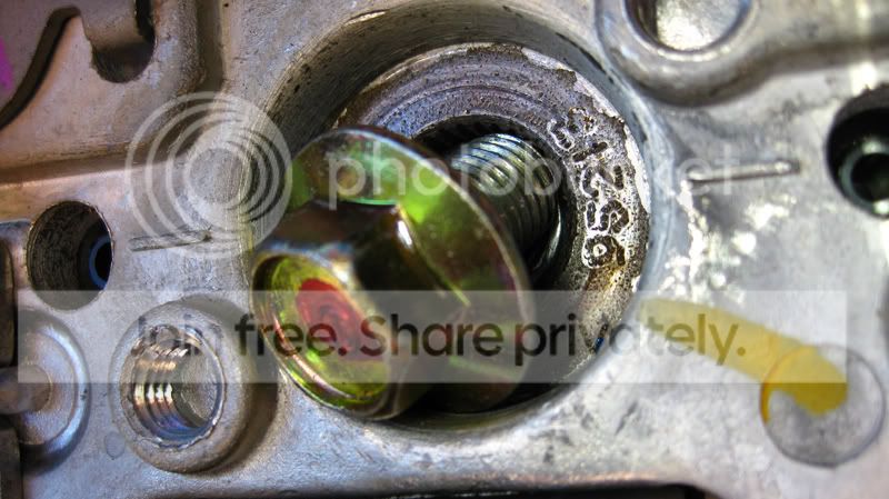

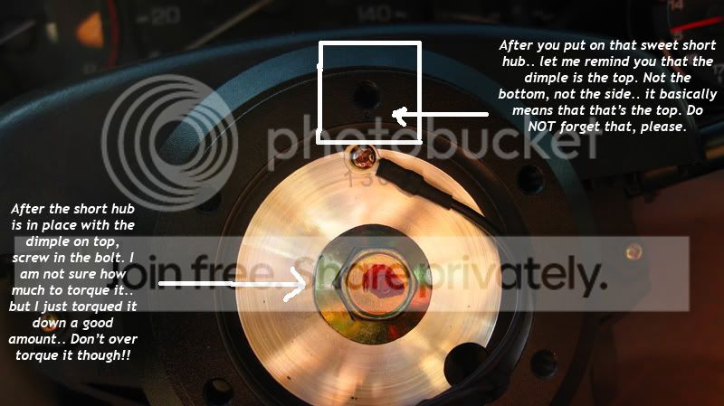

After you take off that bolt, the steering wheel it self should come out.. what I did was.. I just kind of banged the back of the wheel with my hand and it came out. No need to put both hands on the steering wheel and pull as hard as you can. You could do that.. but brace yourself.. or you might hit your face. :spit:

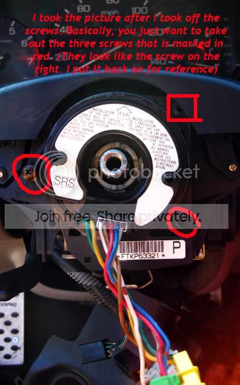

Step 5: Last step. Now you'll see this .. SRS .. plate thing. It's the only thing that's holding you back from putting your aftermarket steering wheel on.
After you do that, there is a loomed patch of wires attached on the SRS plate. What I personally did.. was cut it off. Some people took the SRS plate and dug it somewhere underneath the steering column. I just cut the wires off. (I don't have a picture of the wires.. but there are two wires.. one green one and one yellow one, they're together by the way).

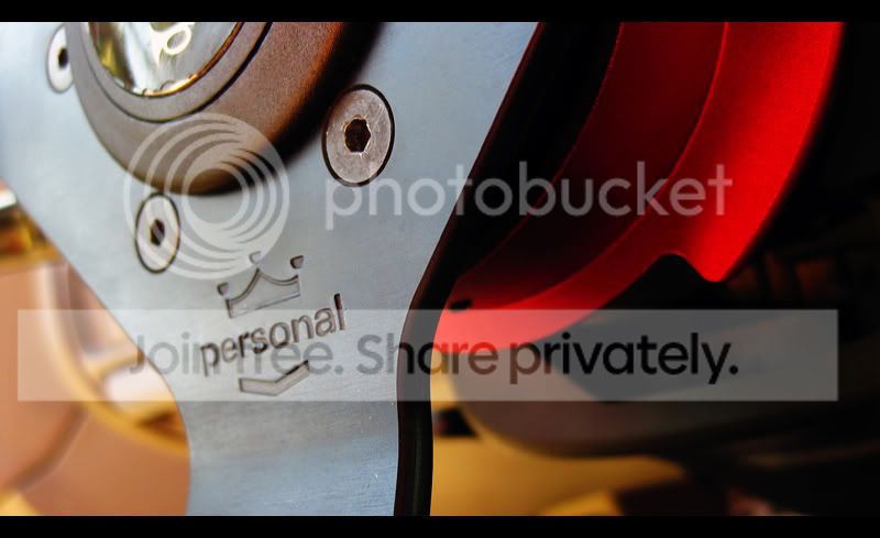

Ah ha!! Now, put on your short hub! READ THE DIRECTIONS ON THE PICTURE!!
Wow, almost done. Heck yeah, I was pretty happy.. anyways.. NOW, put on the quick release.. it should have the dimple on top as well, so remember that. Use my pictures as reference.

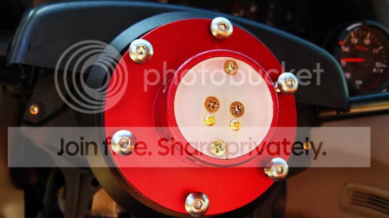

Looking good so far. After those screws are tight enough, attach the entire quick release back on. From there, you want to do the same thing with the steering wheel, putting on the 6 screws with the allen wrench.
After that.. you're DONE.
