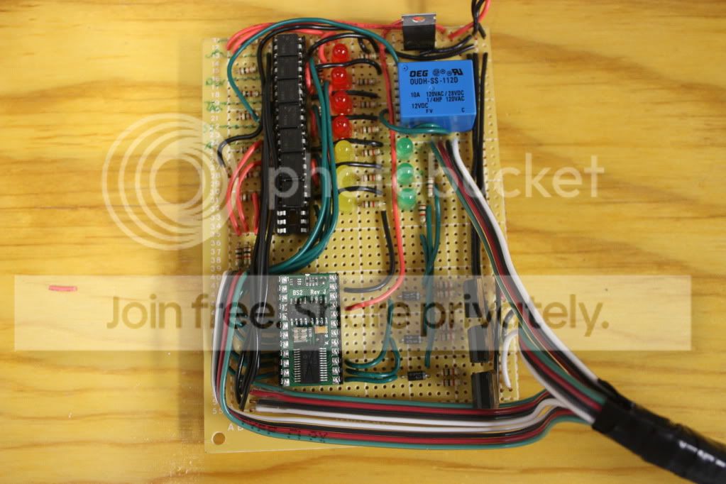

I don't think it'd be that difficult to build a separate module to run the tranny, but I'm not the guy to talk to about doing it. There's a guy on j32a.com with a j35 turbo civic who did exactly that - get in contact with him and see if he can hook you up :) Here's his OP:
Yeah, I didn't know what else to do. The car, na, with the stock ECU running the engine and trans would shift fine except if you went past say 75% throttle. Say you floored it from a stop, 1st to second would shift fine at redline but the car would not shift from 2nd to 3rd. It would bounce off the revlimiter till you let off then hit 3rd. Once in 3rd and past the downshift rpm you could floor it again and it would shift into 4th at the redline. Using tiptronic mode was no different. No codes at the time and I tried a base model ECU and a type-s ECU. Both did this.
Any other Auto swap people have this problem???
I knew I would be switching to the AEM EMS anyways and knew something would have to be done to control the transmission. So I built a controller myself. Its not perfect but does work really well. It controls the 3 shift solenoids and pressure valves based on your gear selection from the tiptronic shifter. Basically its how Tiptronic should work from the factory. Hard shifts instantly when you upshift.
When I rebuilt the trans I opened up 3 passages slightly and messed with the accumulators. Nothing major at all - I wasnt totally sure what I was doing, but it shifts very hard. Like I said, chirps 2nd and 3rd with the slicks. 4th is just a little soft.
I'm over there. I saw his thread and have seen his vids on Youtube. Wanted your input. Thanks a bunch.
