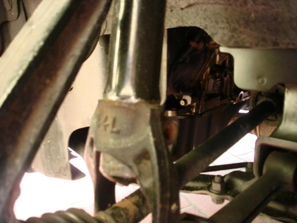

Well guys after reading this thread for a while I got the time to do it to my car. After putting my springs (H&R Sports) I wanted a bit more drop in the front. It was easy and pretty fast. I took the tabs in the shocks out (stock ones) and did some grinding in the shocks and forks. I used a regular drill and a metal grinding bit. Here is a pic of when I finished.
