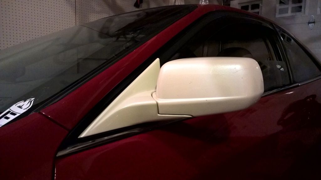

Mirrors look good. I definitely want PFM. It gets cold here but I don't think it gets cold enough for heated mirrors but it is a nice feature. Like the heated seats. I'd rather have cooled seats in the summer though.
Just playing devil's advocate here but have you considered, while they're apart, working in some kind of light or turn signal? If not on the cover then perhaps behind the glass?
Cooled seats would be sweet! I agree heated mirrors aren’t essential, but I do have to scrape mine sometimes so maybe it will be handy. I will definitely get the most out of the power folding. I’m also curious how much that blue-ish tint on TL mirrors reduces glare, all I know is it looks cool lol.
I have actually, if anything it would be on the mirror side. I came across this thread about SKP Dezigns which I found interesting. But these are for UA4, not to mention they are one offs from Japan so crazy $$.
http://acurazine.com/forums/photogr...r-ua4-5-side-mirrors-led-turn-signals-916061/
I also saw a thread somewhere where someone put LED’s behind the mirror glass, but I can’t find it now. I meant to explore that further because I wasn’t sure if the mirror glass was semi-transparent, or what. Or maybe there is a way to mount something somewhere else.

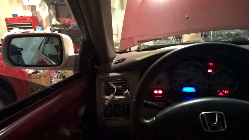

Looking good. Need to sed my how you you did this and how to find the parts what do I need to search for. Was the wiring job easy to do.
Well you have a few options for power folding mirrors. Check out this thread, some data has been gathered on various side mirrors.
http://www.6thgenaccord.com/forums/showthread.php?t=39585
FNCONE also made heated PFM’s with a set of RSX mirrors:
http://www.6thgenaccord.com/forums/showthread.php?t=50361
But it seems like the most straightforward routes are the UA4 or UA5 TL mirrors…they both fit well on coupes. You want to get mirrors that include the pigtails. Then you need a switch to actuate the power folding, either one that comes with a pair of mirrors you buy or from a JDM 5thgen Accord, or a JDM EP3 Civic. Some also have integrated relays, some have a separate one.
With FNCONE’s help I have learned a lot and the wiring for the mirror adjustment motor is pretty straightforward (3 wires). There are only two wires for the power folding motor so that shouldn’t be too hard surprisingly, but not sure on that yet. As for the heating elements, just two wires you tap into your rear defrost with, but they have to be run separately since there is only one unused pin on the PFM connector.
