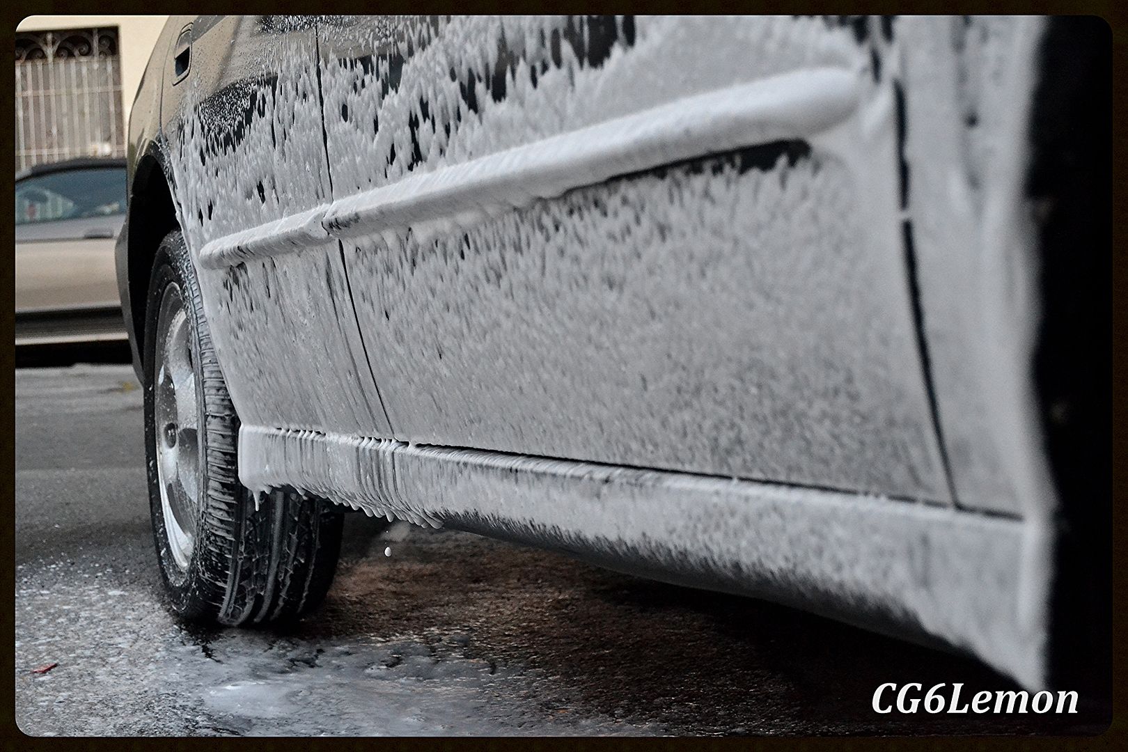

How to properly clean your tires
These are the 3 methods I use to clean tires before applying dressing.
Method 1: Use an all purpose cleaner.
I have a couple different brands of all purpose cleaner, but one of my favorites is Meguiars all purpose cleaner(D101). I cut it 1:1 when using it on extremely dirty tires that haven't been cleaned in a while. For weekly or bi weekly washes I use it at 3:1.
Method 2: Use a dedicated tire cleaner product
So far my favorite tire cleaner is by Tuf Shine Tire cleaner. A product that's specifically for cleaning tires will contain different key ingredients from all purpose cleaners. In most cases, a dedicated tire cleaner will be able to get the tire cleaner in less attempts.
Method 3: Using a product that's able to clean wheel and tire
This is killing 2 birds with one stone approach. A product I reach for once in a while that can also be bought at a local auto parts store goes by the name Mothers wheel and tire cleaner. This product foams and clings onto the surface longer to let the chemical do the job before agitation. Gets a thumbs up in my book!
If using method 1 or 2, hose off the tire and spray the product onto the tire and scrub it with a tire brush. Rinse and repeat until you don't see any more brown gunk coming off. If using method 3, then hose off the wheel and tire.
Dry off your wheel and tire and apply your tire dressing of choice. I personally prefer only using water based dressing. I dislike oil based and silicone based dressings due to slinging product, and not a natural look to it. Water based dressing will actually nourish the rubber and not rot it.
