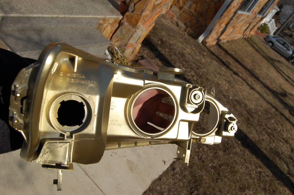

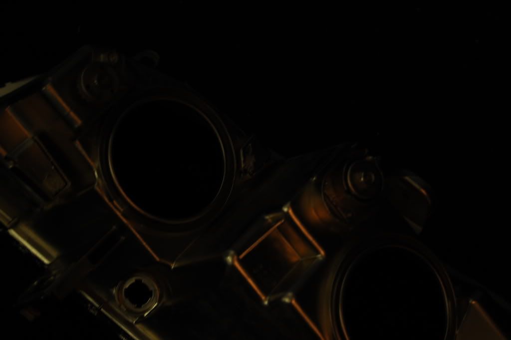

So it's onward of probably 2 months since I first started planning my retro. You guys have probably seen a lot of these pictures already but I figured I'd put them all into one thread so everyone can see how I did my retro.
*SOMETHING I'M KEEPING SECRET UNTIL IT'S DONE ON THE WAY*

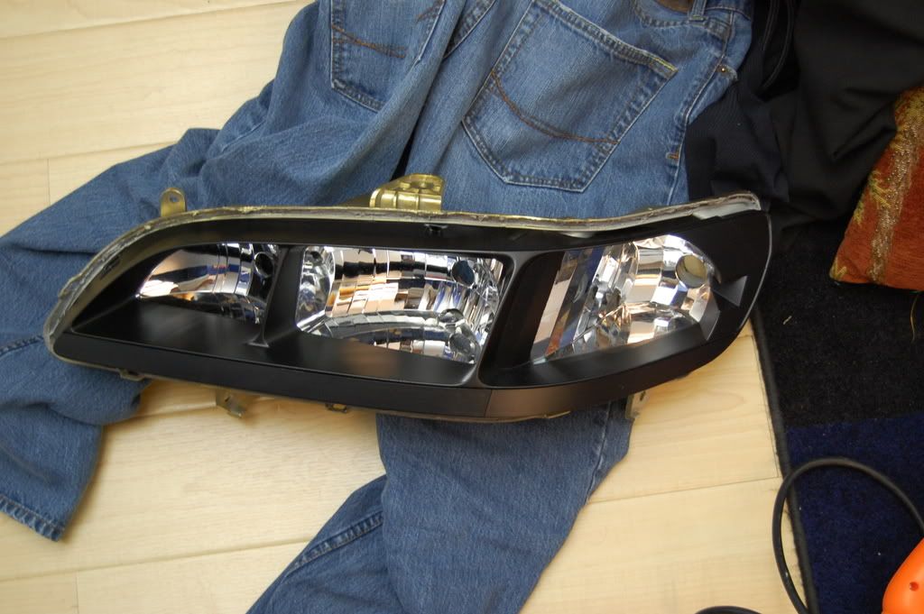

It started with way to easy of a tease...
Then it was revealed.

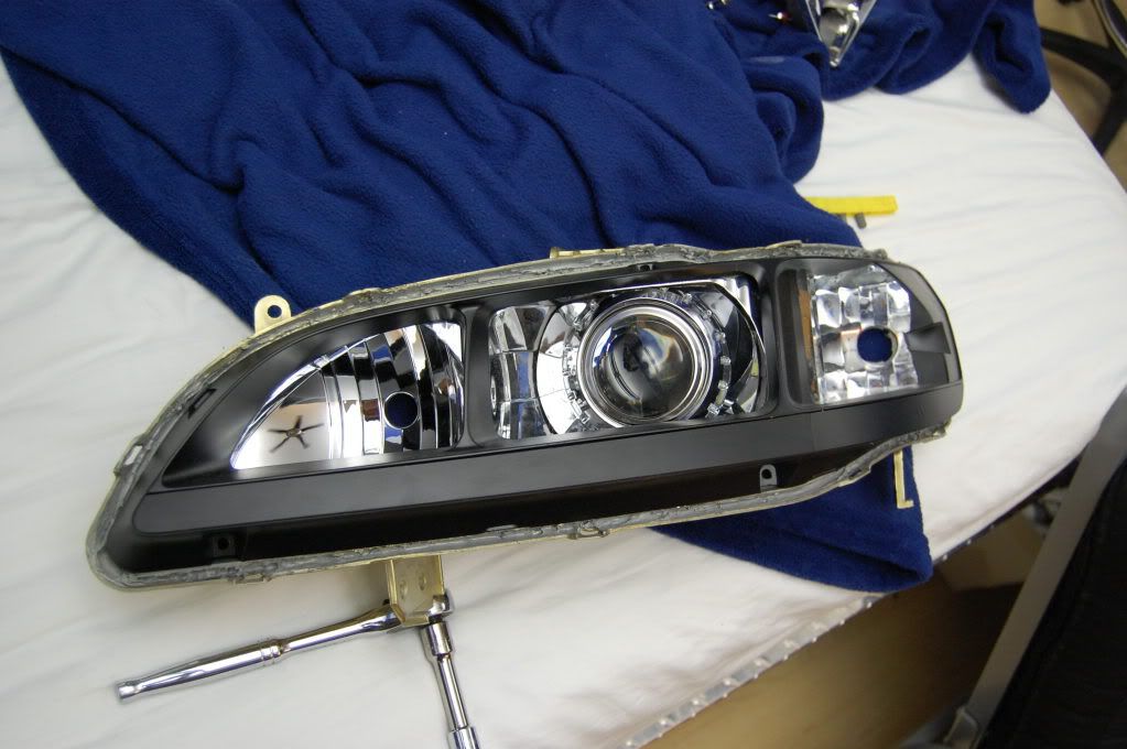

Black-housed and together for an idea of what it would look like.

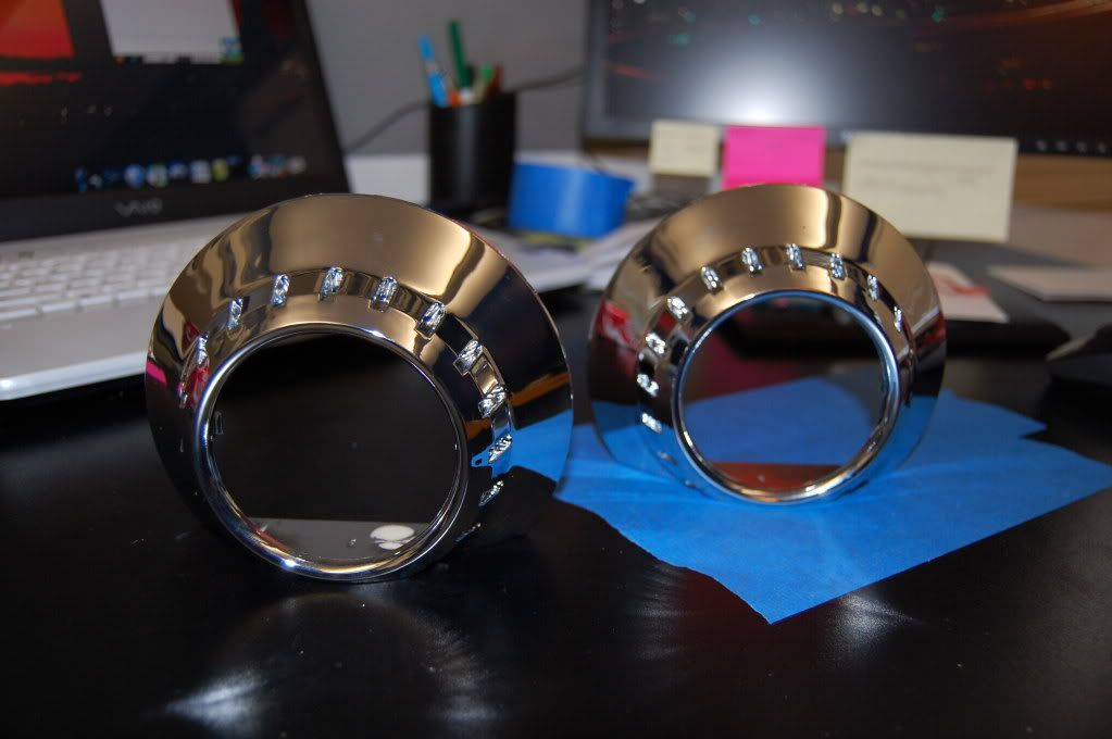

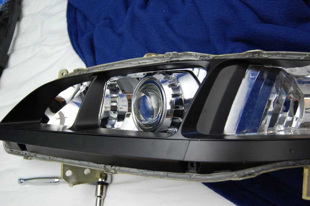

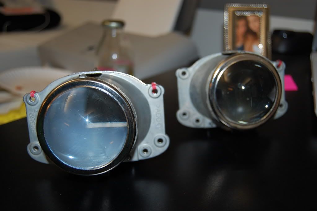

Then came something new. A beautiful set of TSX projectors with clear lens.
Shrouds

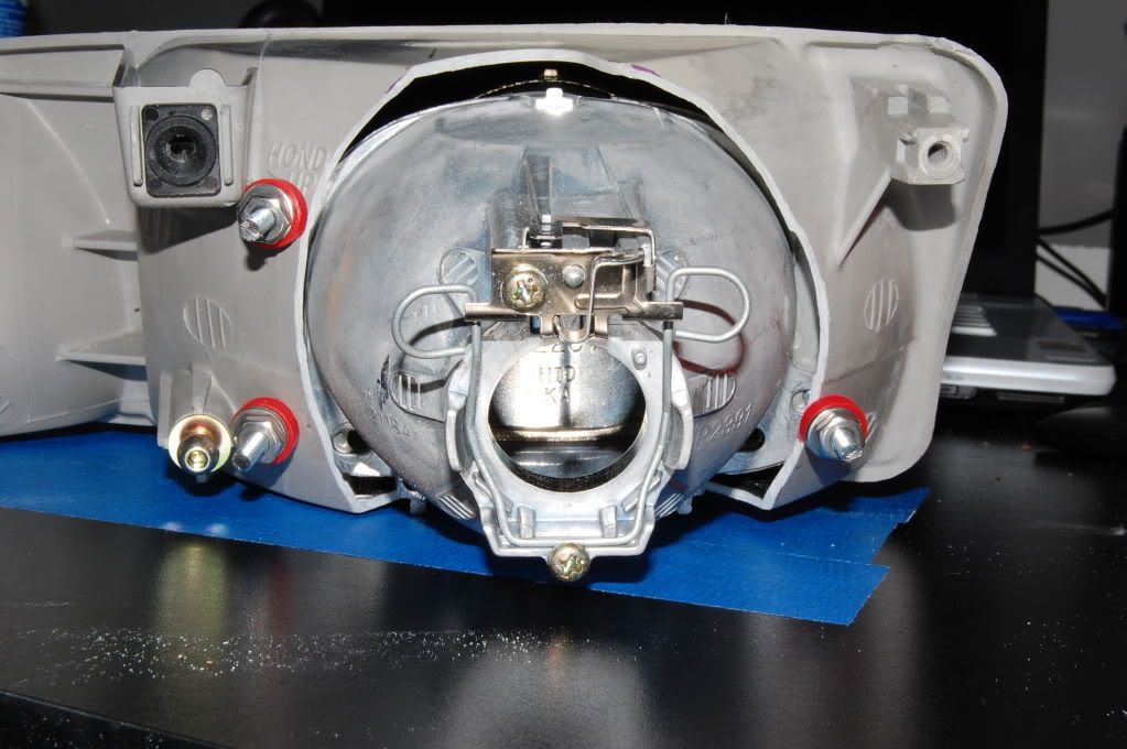

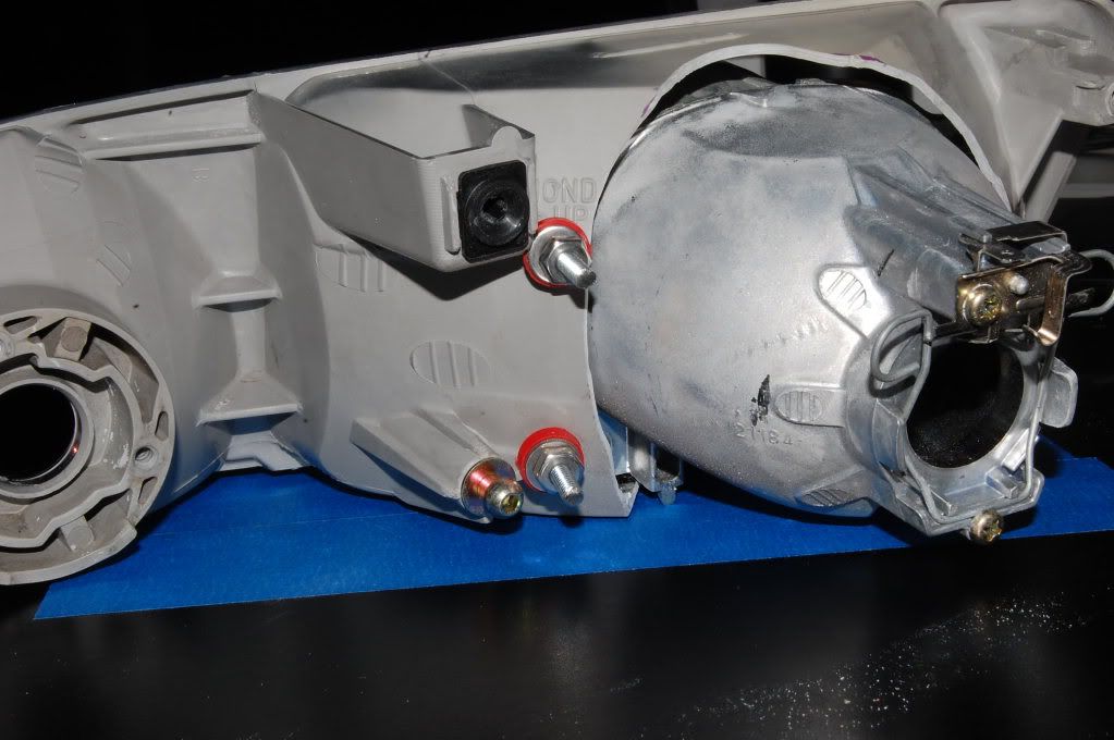

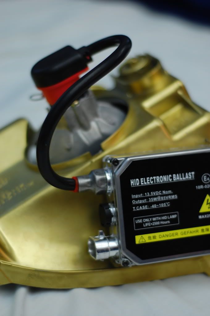

Started piecing stuff together. Not for the faint of heart.
Christmas came early

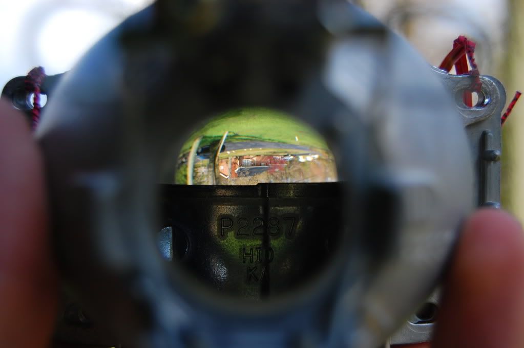

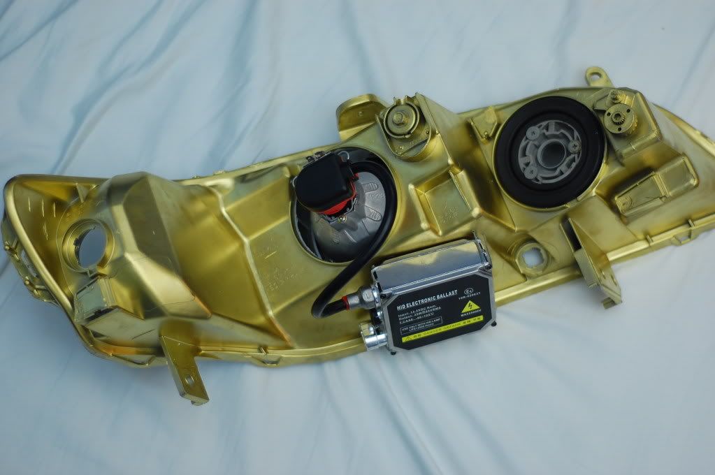

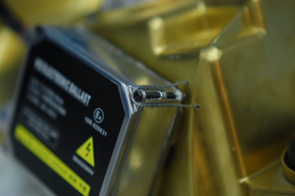

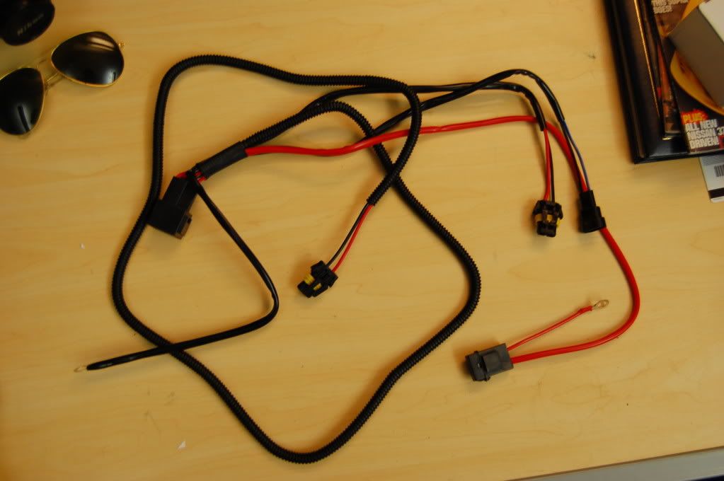

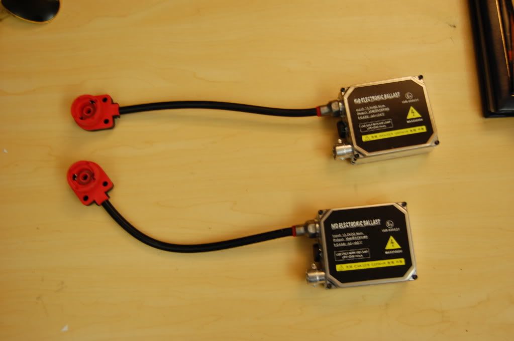

Bulbs, Ballasts, and a harness
The backs of the projectors

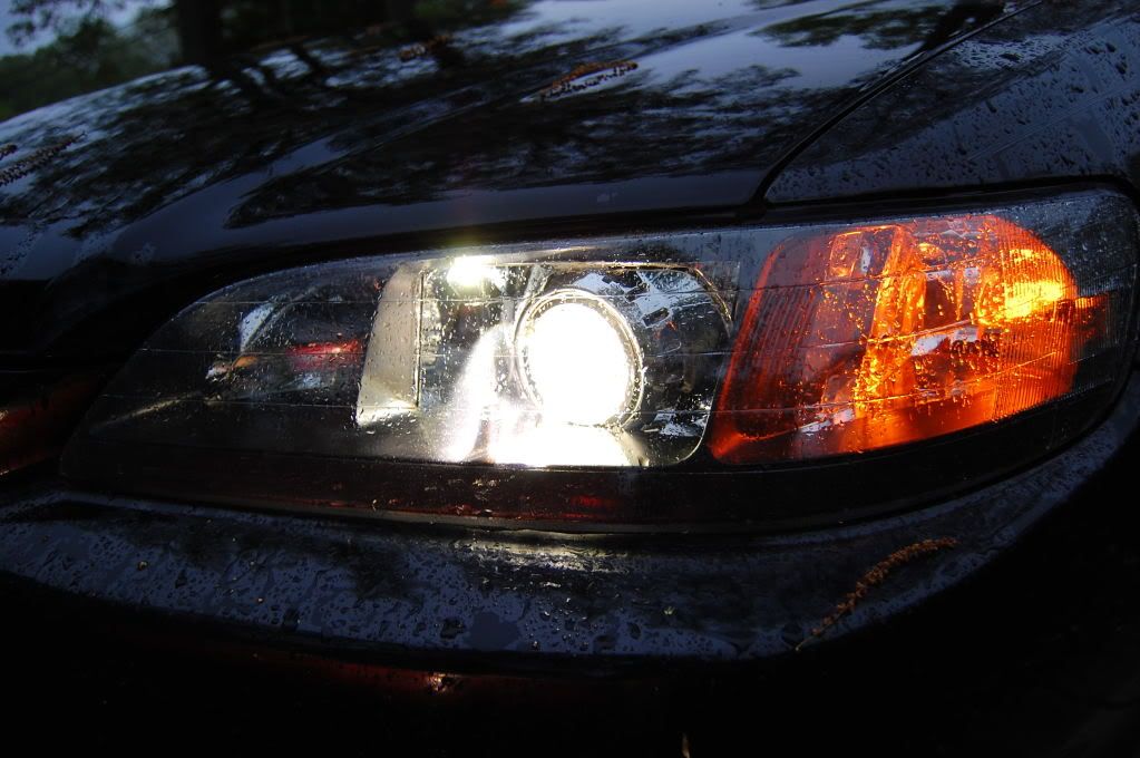

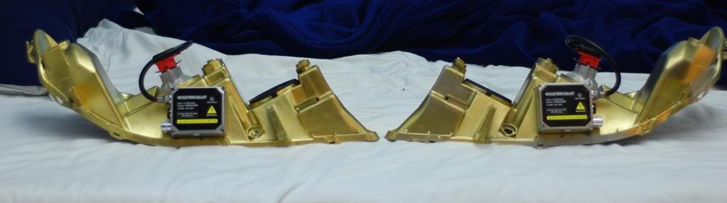

And almost how they'll look when they're done.
And I think someone said the back of a retro shouldn't bring attention?
Comparison, only cause I have really bad luck though.
I'm done for now. Maybe i'll open them up for a little extra something.

and that's where it is now. projectors and bezels should be here mid week, and hopefully I'll pick up the Ballasts and bulbs this weekend. This sh*t is expensive. I now know why not that many people do them.
oh yeah and for those who have done retro fits what did you use to cut and drill your housings? just a dremel and a drill; I'm afraid that'll crack the housings.
I would be afraid to touch those headlights, the blackhousing looks really nice.
mad props I don't even know how you did that. haha.
and yes I realize this post didn't help you at all, haha.

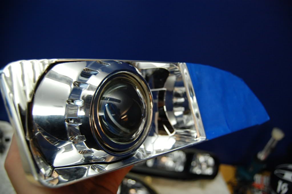

Time and a bunch of sticky notes. I had to use sticky notes as my tape, to do the corners like that, because any blue tape would just peel off the chrome. And thanks man.

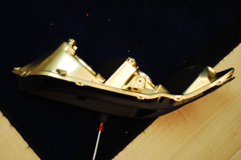

Question: once sealed do you just reopen them with a heat gun like the first time? Seams like brand new Hondabond wouldn't want to release like 10 year old stuff does.
Rick, why did you have to mask them? You know the chrome bezel and the chrome reflector bowls come apart right? Unless I'm missing something on other years of headlights...
These are 01 sedan:

OEM BMW E46 Shrouds 125
S2000 Projectors 375
TSX Replica lenses 70
He masked off the corner
