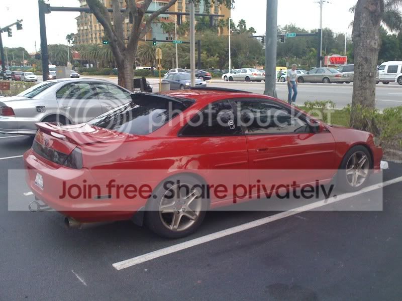

ever since i got my coupe ive wanted a rear window visor (rear roof visor?) but i was only able to find them for the 4 door
after looking on forums i saw that toofastaccord said his was for a sedan and he got it to fit with some TLC so i went and ordered it and figured id put up a DIY to give back a little to this community that helped me
heres the auction on ebay
http://cgi.ebay.com/ebaymotors/ws/e...0440748110&viewitem=&sspagename=STRK:MEWNX:IT
and heres what tools i used
an acrylic/plastic cutter from an art supply store for about 10 bucks
60 grit and 220 grit sandpaper about 3 bucks each

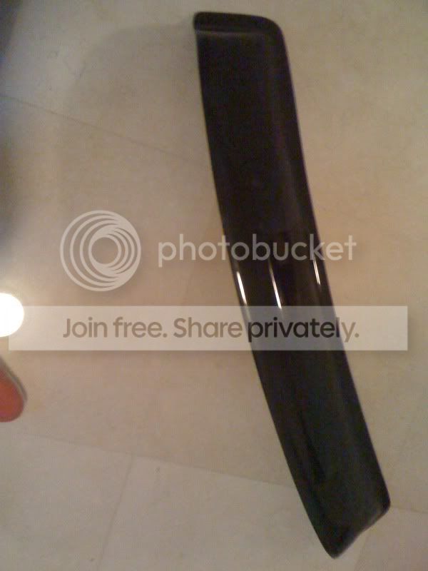

the visor fresh out the box

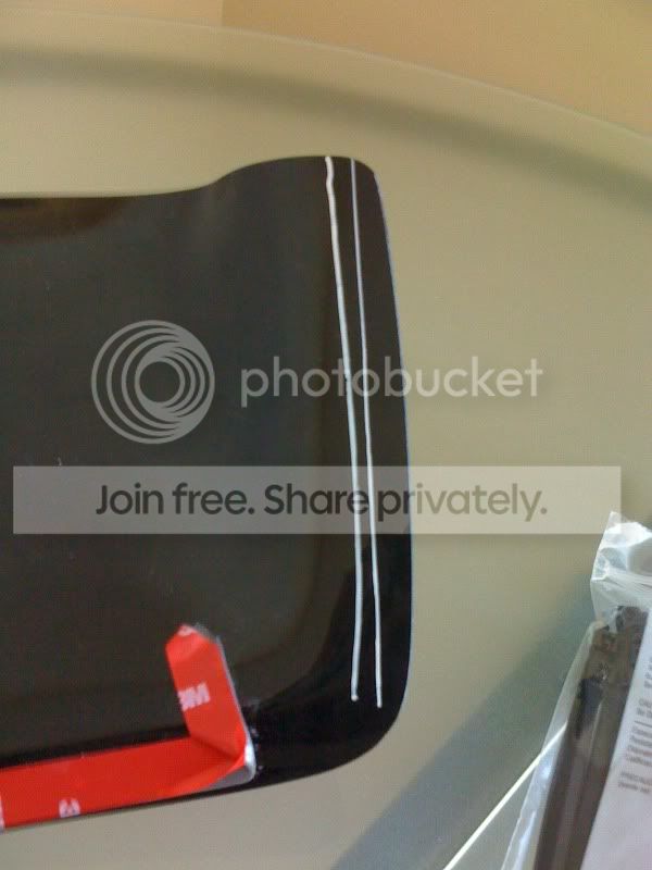

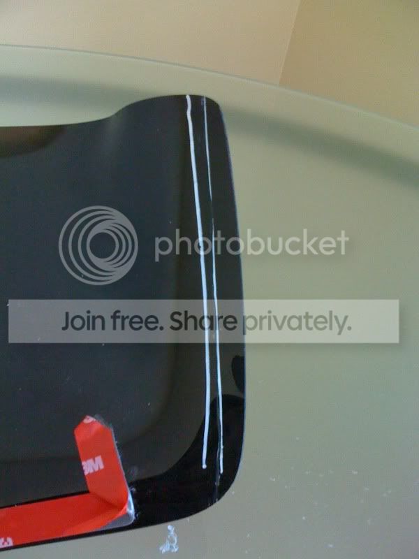

i test fitted it on the window then used the 3M tape as a guide for how much i was gunna take off...then marked it with a white paint marker
realised i didnt wanna take off too much and be stuck i made another line closer to the edge

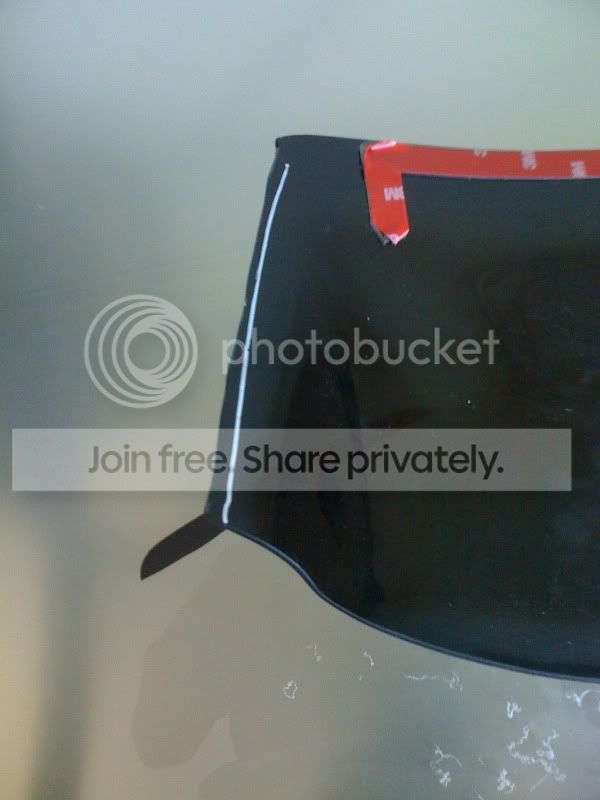

scored it with the acrylic cutter about 2 dozen times with more and more pressure
grabbed some pliers and snapped it off
other side
this is when i forgot to take more pics :D
the next step is cutting an angle where the corner is...about a half inch then sand down the rough edges and youre done

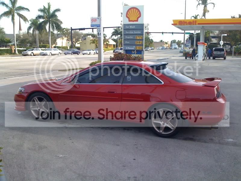

finished product (with new blackout chrome trim)
hope this helped someone!
comments? thoughts?

good DIY man. the only thing that keep me from doing this is that I think that those visor sticks out too much and doesnt really flow with the car. But none the less yours looks good. got any pics close up? how it sits on the window

i like it, this should be put in the master diy list... also the spoiler and roof visor look the same so it works
yeah i was unsure of how it would stick out but i gave it a try anyway and it looks ok....when i go out today ill take some close up pics
gas station pics ftw. :lawl: gj on blackout and visor
haha yeah i was at the shell when took some test shots, thanks i like the blackout alot
think so? ahha i missed half the pics and yeah they have the same angle so im happy with it

personally i think a smaller window visor looks nice. nice work tho.
why is your honda H upside down??lol
