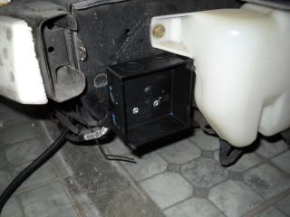

2. It’s up to you how you want to mount the Ballast but this is the easiest/quickest/cheapest solution for me with the tools and supplies available. Actually, these blue boxes worked out like they were made for this project. The cut out holes were spaced perfectly.

7. I painted boxes black for aesthetics.

9. Passenger side, I had to drill two holes. Hole in frame was too big for 3/16” rivet. Also a threaded hole but decided not to use.
10.
11. Passenger side with box mounted. I could not access holes from opposite side so I coated circumference of drilled holes with white-out, pressed box against white out, leaving markings on where to drill.

13. Used “light-switch” backing as padding between back of holder and ballast.
14.
15. Inserted ballast into holder. Notice padded weather stripping to reduce slack and act as a shock absorber since ballast is free floating.
16.
17. Cover with weather stripping
18.
19. Holder with cover.
20.
21. Driver’s side drilled two holes towards the bottom of the “pinch” weld on frame. I placed holder against frame and used white-out on opposite side to mark for drilling. Used rivets because they lay flat, very secure. Only way to remove is to drill out center.
22.

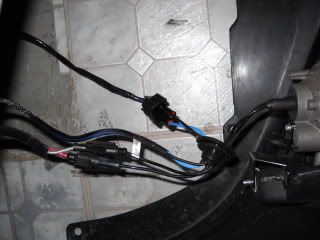

25.

30. I would suggest turning on fog-lights before re-installing front bumper. Once you are sure everything works, install front bumper. All-a-ka-zam, you now have HID fog-lights.

the box served as a method to mount ballast on car/frame. I could have done something cheesy like zip ties or something else but this worked best for me. IMHO I think it looks fairly clean.
