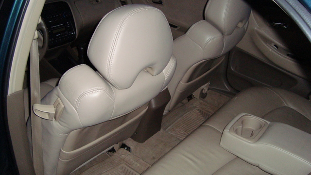

More good news the 02-03 Acura TL/CL seats are practically direct swap into all 98-02 Honda Accords even with side airbags, if you dont have side airbags then you dont have to worry, for the ones with side airbags the only thing that has to be done for the SRS light is to swap the OPDS unit in the backrest of the passenger seat, Unclip the clips at the bottom of the seat back by pulling towards the rear of the car(they almost always break and service manual says to replace them) undo the seat fabric on the inner sides of the seats and peal off the fabric to reveal the OPDS unit, remove the white clipped in plastic cover to reveal 3 philips screws, unplug the 4 yellow plugs and plug in the OPDS unit that came with your car('01,'02 accord). Make sure the seat belt sensors, airbags(yellow connector), and the OPDS connector are all plug in tight. Clear the SRS light if its on and you shouldn't have a problem unless there was already something wrong with your SRS system or if there is something wrong with the ones in the Acura seats.
Now I'm going to order heated seat switches to see if I can get those wired up, but it looks like they should work with the wires that I posted earlier.
Here are some pictures of the biege, also you have to be moderately skilled to perform this...

Looking good!!
Now find a sedan with leather door panel and swap - that's what I did to get the doors to match :)
Also, did you ever finish hooking up the heaters? Where did you end up putting the heater switches?
