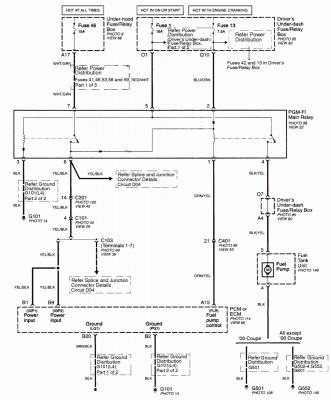

Took the main relay circuit card (with its connector still attached) off from its housing. When I did that, I accidentally shorted the circuit card to ground. After that it didn’t want to turn over. Not sure if I burnt something or what lol was going to replace it anyways since it’s suspect.
I checked the fuses just in case (fuse 1 and 13 on the driver side fuse box) and I’m good.
Welp I have to wait until Saturday so I can go to the junk yard and pull a relay. Hopefully it does the trick.
Apr 29, 2019
18
Houston, Texas
Update!!
Due to me shorting out the circuit card of the main relay, I ended up blowing fuse 46 that is under the hood fuse box. I’ve attached the diagram that I used to solve my issue.
Anyways, due to me shorting out the circuit card, my car wouldn’t start anymore until I replaced that 15amp fuse. So that solved that temporary issue.
I later then went to purchase a new main relay. I noticed that these are different now. They have IC chips in them now which are more reliable than the old relays.
I replaced the relay and have drove around for two days. Car has not stalled. I may have solved my issue.
I appreciate everyone’s help these past couple of days. Hopefully this thread helps someone else in the future.
Just a side note. Whenever your car doesn’t want to start, I would say to make it a good habit to check for blown fuses per the diagram I attached. Might as well cancel all that out.
