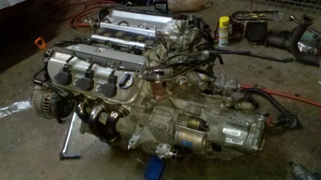

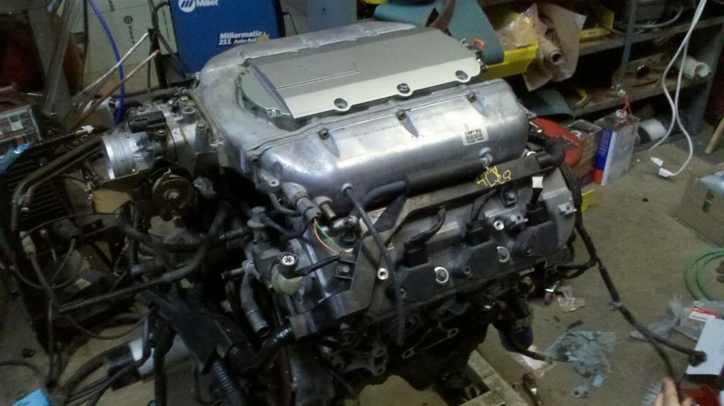

We installed new timing parts on the J32, borrowed parts from another motor that were in better shape. We cleaned the injectors, IM, etc. The motor is pretty clean, with maybe around 60k miles on it...need to carfax the VIN on it to see for sure. Anyway, hope I get to use it.

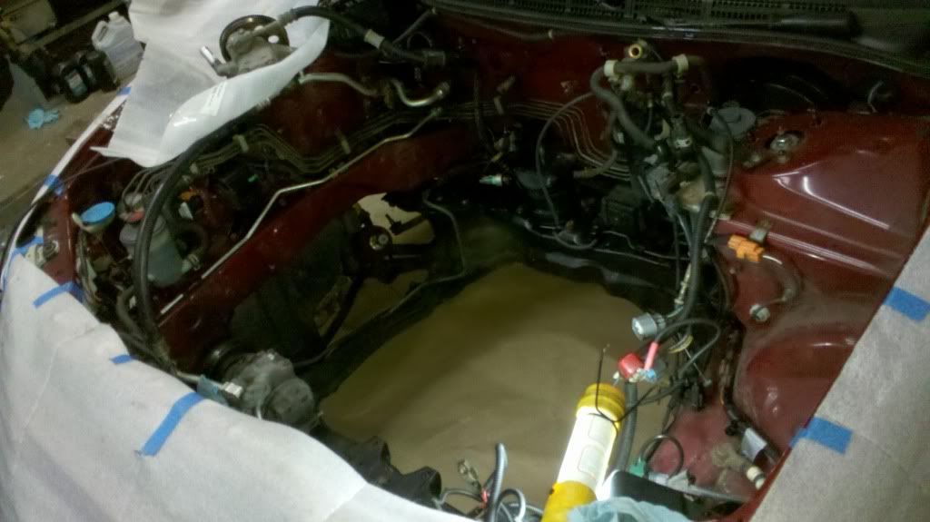

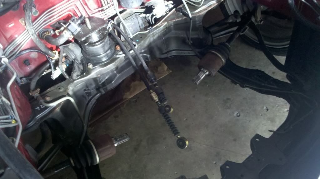

EDIT: Tomorrow is the big day. Motor mounts get modified to be shorter, motor/trans get "mated" and go in the car, shifter gets hooked up, clutch/brake pedals get mounted. We plan to have it running. Good news: we're documenting hooking the J30 wiring, etc back up while its out of the car, so we can have more time to get the J32 in and documented. So good chance I will end up with the 3.2.
