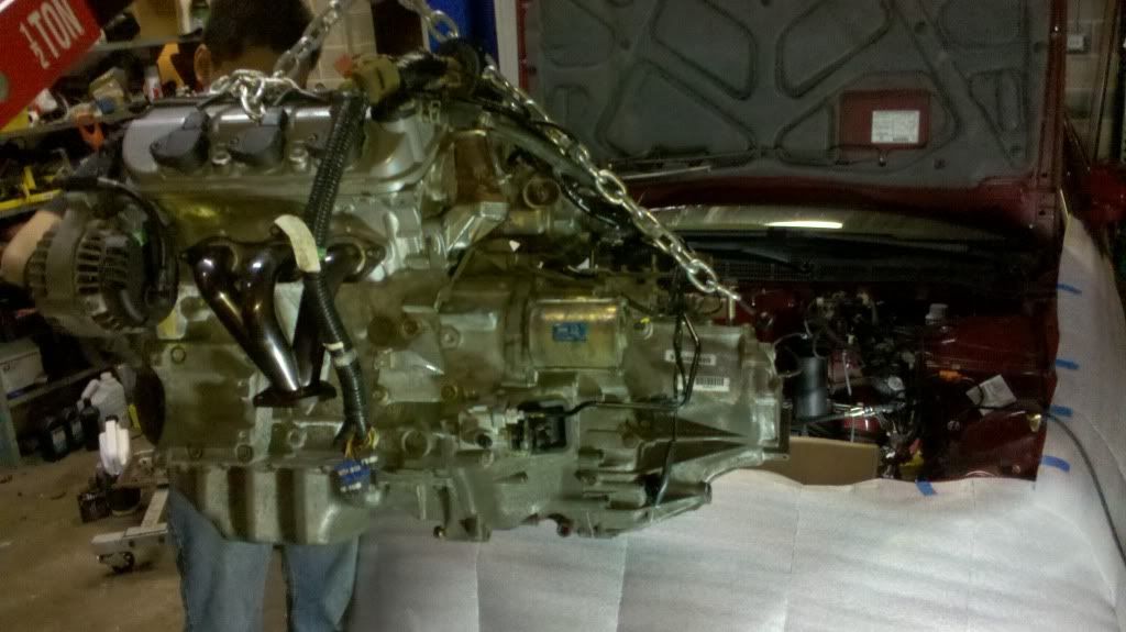

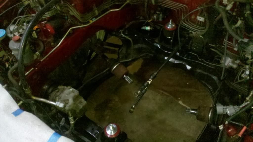

First thing today, figure out what we need to do with the motor mounts (you either have to lower the rear mount by 1/2" or put spacers in the subframe to lower it 3/4", so the hood clears - because the J32 is a little taller), then drop in the new trans/motor and hook up all the harnesses/plugs.
Pedals need finished up, pin needs made for one of the shifter cables to attach to the shifter, shfter cables need attached to tranny, axles need put back in, headers/downpipe need reattached, radiator needs put back in, interior console needs reassembled, and motor, tranny need new fluids.
Hopefully we can finish everything by 4pm tomorrow, at the latest...

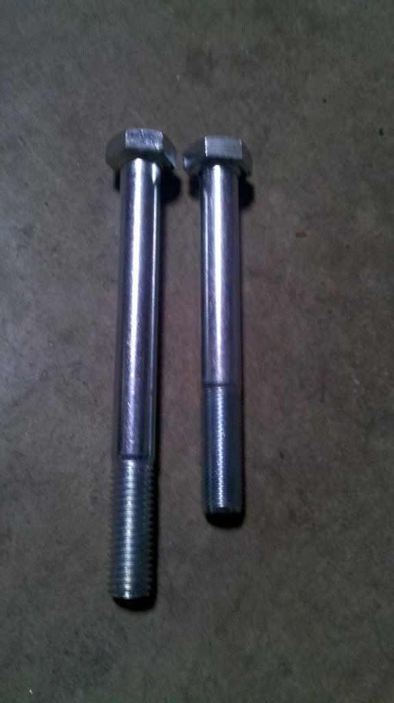

The bolts Innovative ships with their mounts are too short for this car, so we had to buy longer bolts. We found ours at Ace Hardware. Innovative bolt is on right, which is roughly 7/8" shorter than the Ace bolt on left. Only difference is the threading, but both work. If you use these mounts, just make sure you get bolts that are rated the same.
Bolts:

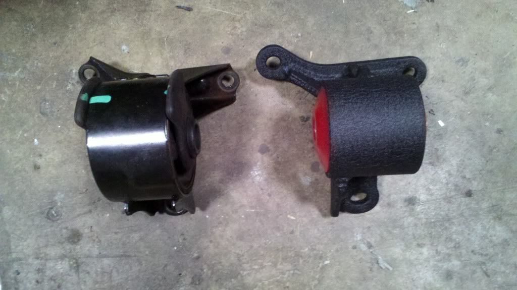

Side mounts. Oem vs innovative
Fronts
Rears
Mounts in car

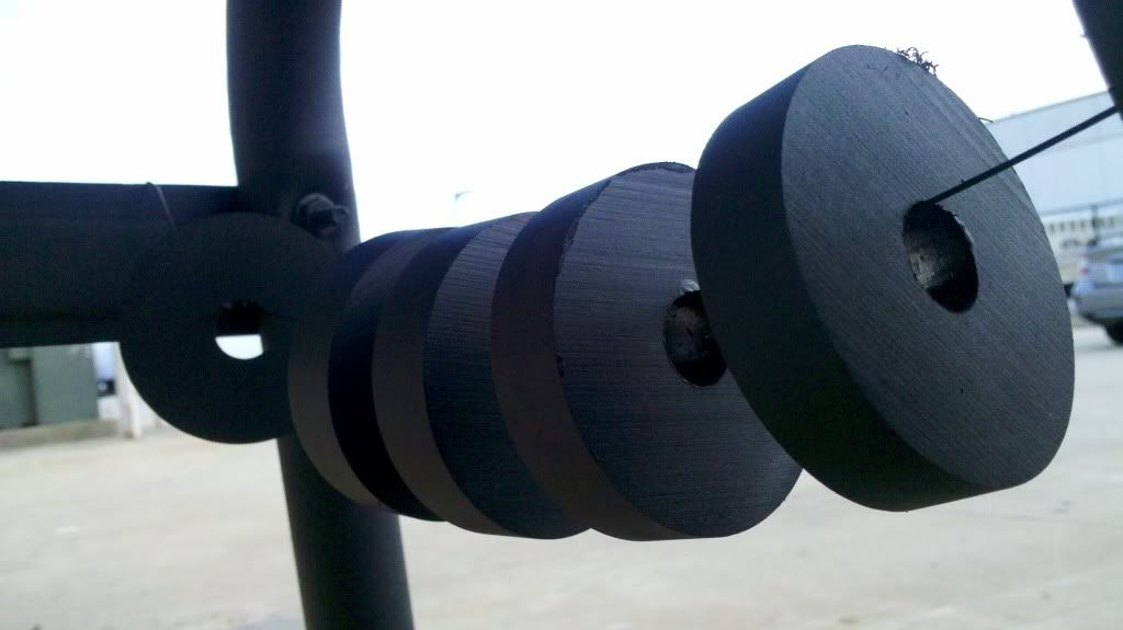

Motor is in, shifter, shifter cables, and clutch pedal are fully functional. Most plugs and connections are done. J30 ecu is being swapped for TL-S ecu, that's almost done. Hood clears the motor thanks to these spacers, which were used to drop the subframe. They are roughly .6" thick.
