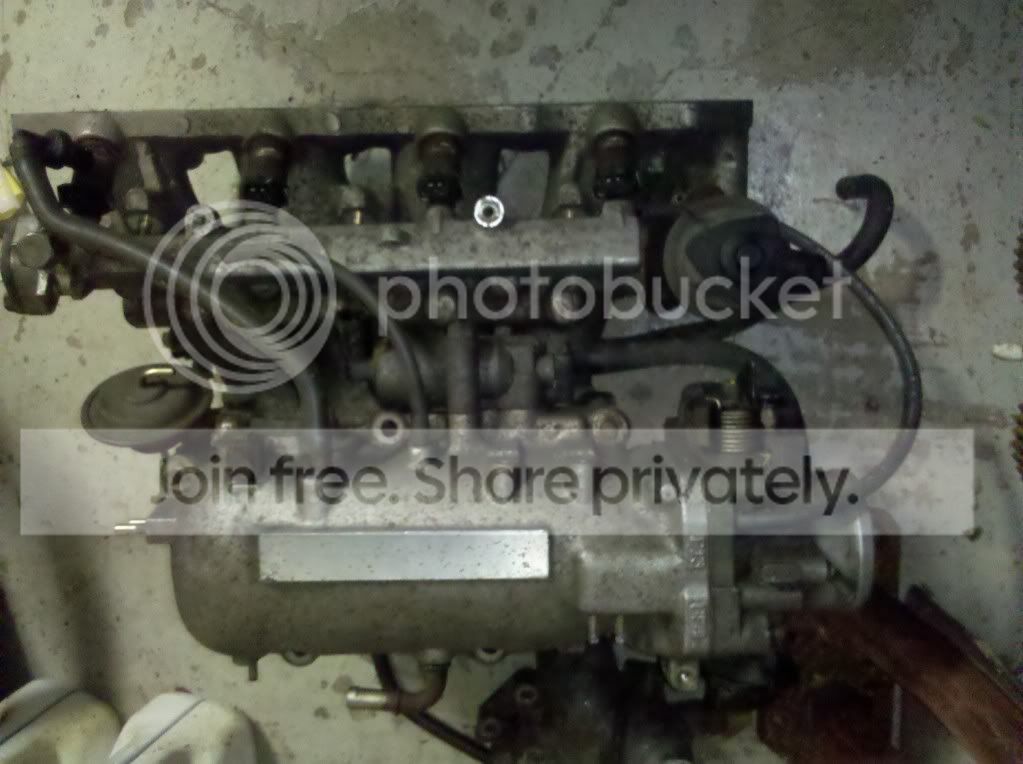

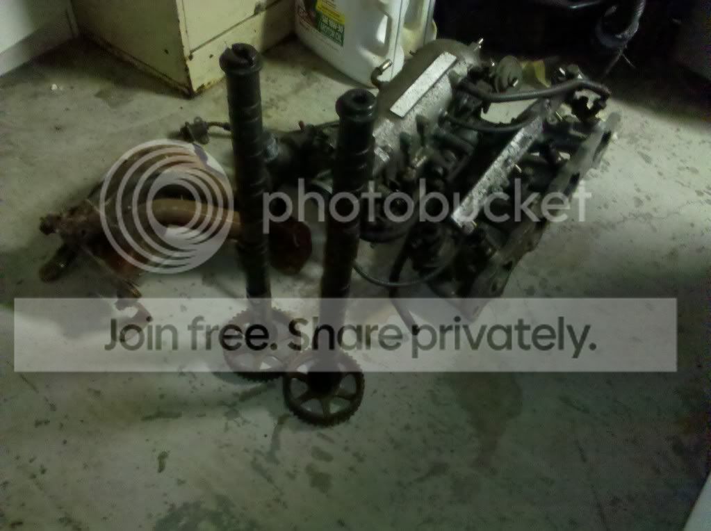

Picked up all this and a H22a Head for 50 bucks!!
AFAccord
Jan 18, 2007
1,911
33
Spangdahlem, Germany
Re: Accorman722's G23 Build.
That manifold and cams will get you no where close to your lofty goal. Let me make a recommendation before I check out of this thread...
-H22 Head: You're going to need port work so factor that into your budget
-F23 Block: I doubt the cylinders in a block of that condition will be straight enough to run 86mm pistons. If you bore it to 87, the liners will be paper thin, and there's no way I'd trust that at 300hp.
-K20a2 OEM pistons in +.25 size: Forget K24 pistons, they'll barely get you to 11:1cr, and you're going to need more than that. The A2 pistons will get you around 11.6cr. If you still have enough piston to valve clearance while running an aggressive cam (Type-S isn't big enough) then you can mill the head .010" and bring your compression up to ~12:1.
-F23 rods: Get them shot-peened and magnafluxed for stress cracks if you can afford it. You'll need the added insurance at 8,000rpm. You'll also need ARP K20A3 rod bolts.
-Skunk2 IM: You'll need either this or an Euro-R IM, but I imagine the Euro-R is out of your budget which is a shame because S2 has very questionable QC practices and some of their parts are down right garbage.
-You're going to need hot cams to utilize that compression. Hopefully GSC will have something out for the H22 by the time you're ready, if not you could see if Bisi can fab one up for you.
-You're going to need a quality stand-alone or OBD1 system for tuning.
-You're going to need a Tri-Y or similar header. Even the replicas don't come cheap.
Basically, unless you have each of these in your budget already, you're just setting yourself up for a sub 220hp build, if that. Best of luck to you.

great info...
but as far as the manifolds go.. either get the Euro-R or have a blackworkx stage 3 manifold done.. cause the "junk2" manifolds arent worth it.. ive read all up and down prelude forums about how those are no good for builds.. they only help out with improving a stock motor..
accordman.. i wouldnt even trust using the cams you got.. guaranteed those things are outta spec due to not being stored properly. same with those injectors on that manifold...
