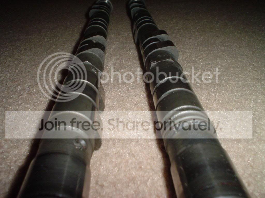

Here are the pics of my Delta 260 grind camshafts. When I first got them I compared em with my stock cams and the lobe separation is "Way" different than stock and so is the duration on intake and exhuast. It not your typical stage one grind at all, so ive been told. Cant wait to get my car running!!!!

Damn dude, let us know how its going, and try to get some more pictures of your frankenstein ;)
