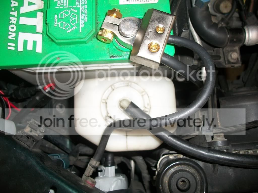

1.) So first i unhooked my postive and Negative Battery Terminals
2.) Like I have always been told, wrap your negative wire in cloth or anything like it.Non conductive. Bad experiences if you do not
3.)It is sooooo hard to get the stock ring terminals off the wire so i cut them as close to the terminal as i could to ensure enough length.
4.) Just Got the wires, (12/14/11) hooking them up now!
Positive P3 Teminal: As you can see it wasnt the greatest fit at the top due to the wear of the terminal, But It fit snug the other 3/4 the way down. Same with the Negative Terminal
Positive
Negative
Both

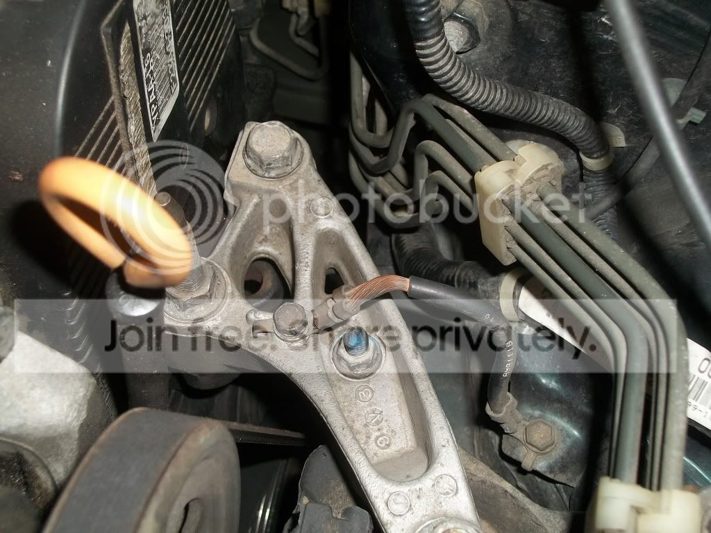

Negative Wire that will be upgraded to 1/0 guage wire.
The Ground that is on the engine mount that will be upgraded to 1/0 guage soon and possibly relocated

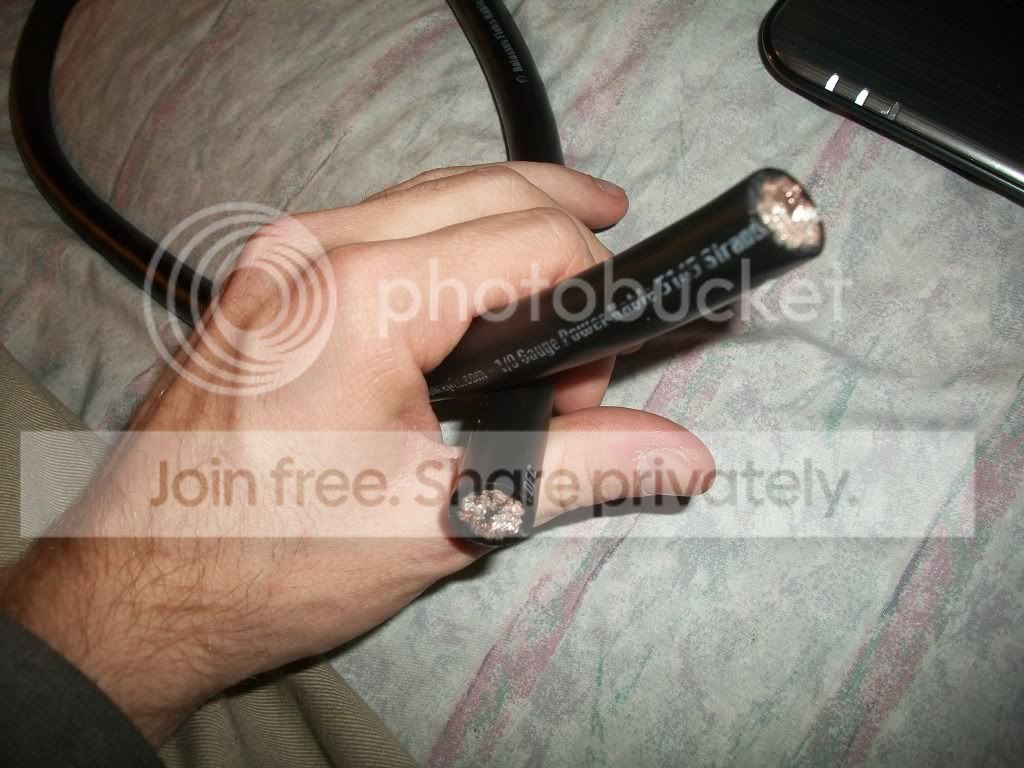

1/0 Guage Ring Terminals
1/0 guage wire Super flexable! like its weird?
