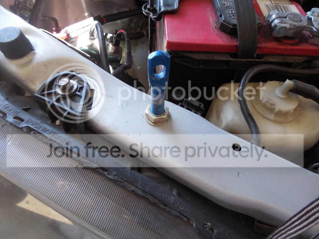

1. open hood and find the largest hole behind your headlights to mount the rods to and use one washer and one nut for top and bottom mount. Just get them snug, don't tighten all the way because you will need to adjust them later. Should look like this when done

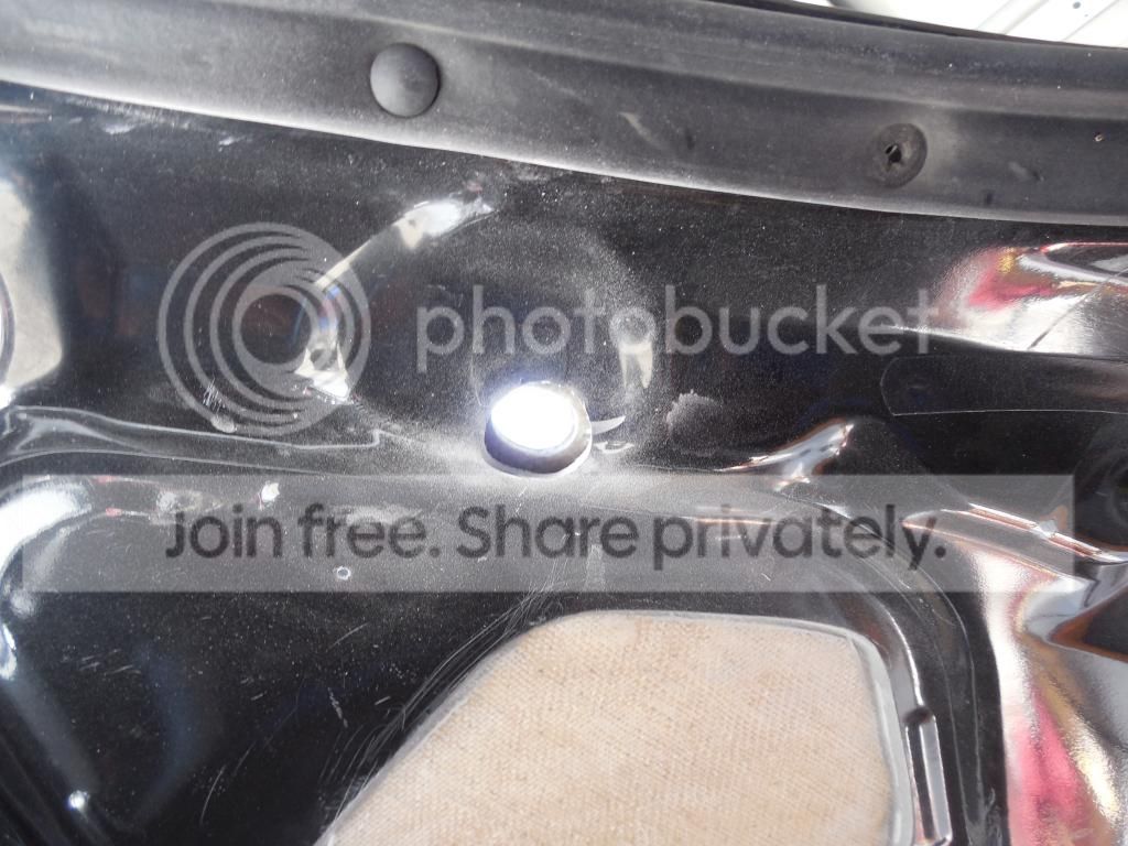

2. Next you need to find what spot you will need to drill into. I used a dab of car wax on top of the rod and gently set the hood down so it would transfer over to the hood. Next grab a small drill bit and drill straight through the hood on that spot and after each drill bit move up in size so you don't damage anything by using too big of a bit too soon. When you get the hole slightly bigger then the rod use a dremel to smooth out the hole and widen it if need be
