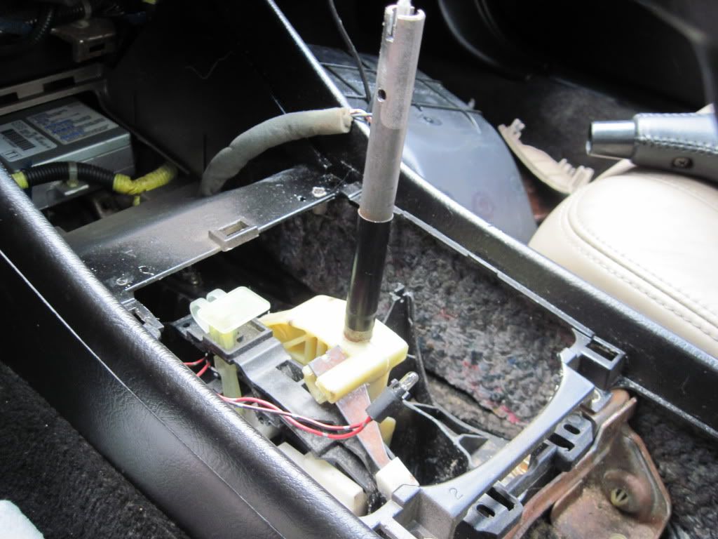

(you can just lift up center console to get next part out but removing center console makes it easier) and it will look similar to this
^ you need to get that shifter trim off so you can remove the slider in the slot, ive already got it out in the picture, the snaps are sort of under the center console thats why its difficult, there is 3 snaps holding it on.
^this needs to come off

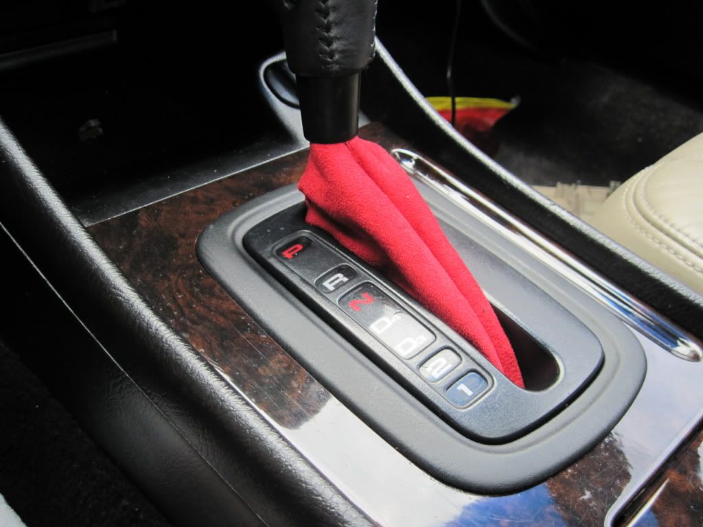

^now that the shifter hopefully looks like this, slide the boot over shifter then reinstall everything in reverse order.( i cleaned everything with soap and water before reinstalling, makes a difference) the top of the boot is kind of tucked into the bottom of the shift knob, theres enough room for it, the top edges of the triangles hold up in there
the result is this

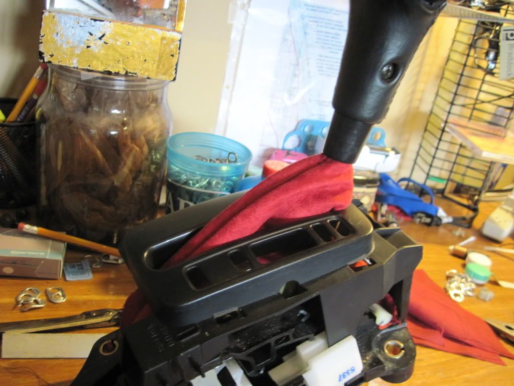

and here's a picture of it in 1st when i test mounted it on my spare shifter
the result is this
