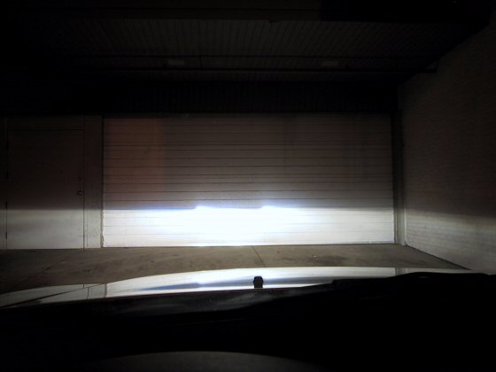

I got everything back together and hooked up..came home tonight and noticed all the light where literally on the tree tops..got home and adjusted it as low as i can,still dont have an even cut off..ones higher than the other i can fix that,but the beams arnt straight they kinda slant..is that a BIG issue? i was expecting a nice bright road infront of me,but dont see anything special.. :(
can anybody show me what the TSX cutoffs are suppose to look like so i can attempt to duplicate when I have time

TSX cutoff from 25 ft.:

Sounds like they need to be rotated a bit?
