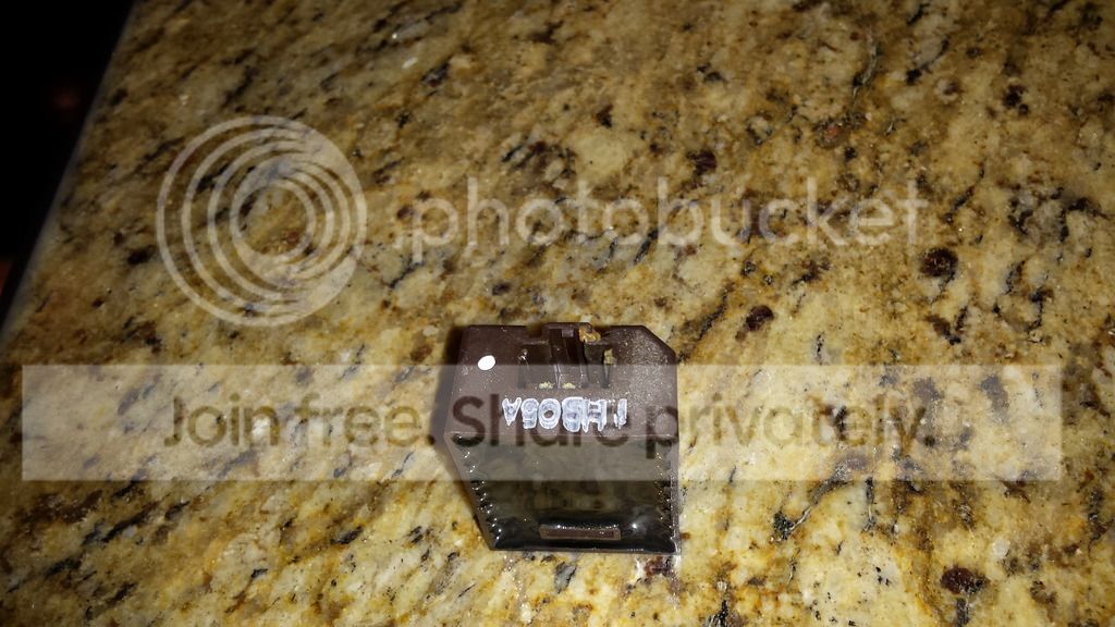

Bc technically in the Honda catalog for these vehicles it's not a seperate part.
However - the common one is 38255-S5A-003

good to know.. I seen that one on ebay/amazon, I think the fuse box might need to be modified a bit I think our eld has a corner shaved off. I could be wrong though.

Here is our eld the plug is centered and the corner is shaved off. I'm sure it's a minor mod to make that one fit though.
