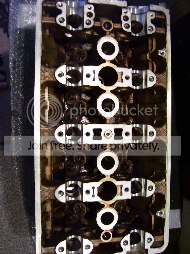

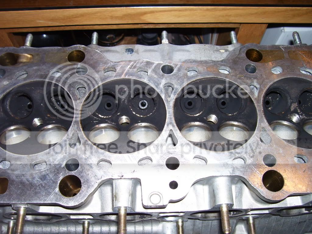

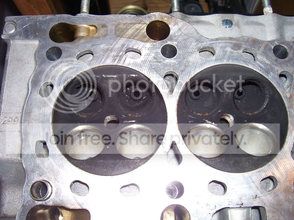

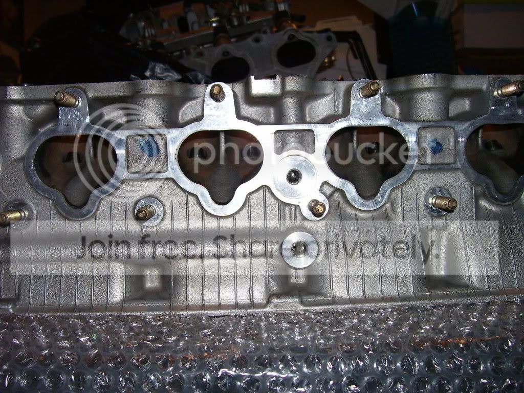

A small update on progress made too just for fun.
finally got a valve spring compressor added to my tool box, so i was able to get the Head taken apart so it can be taken to the machine shop for a full P&P and 3 angle valve job. just need valves. don't want to reuse the stock ones. gross looking those exhaust ones were.
time for Pictarz!!

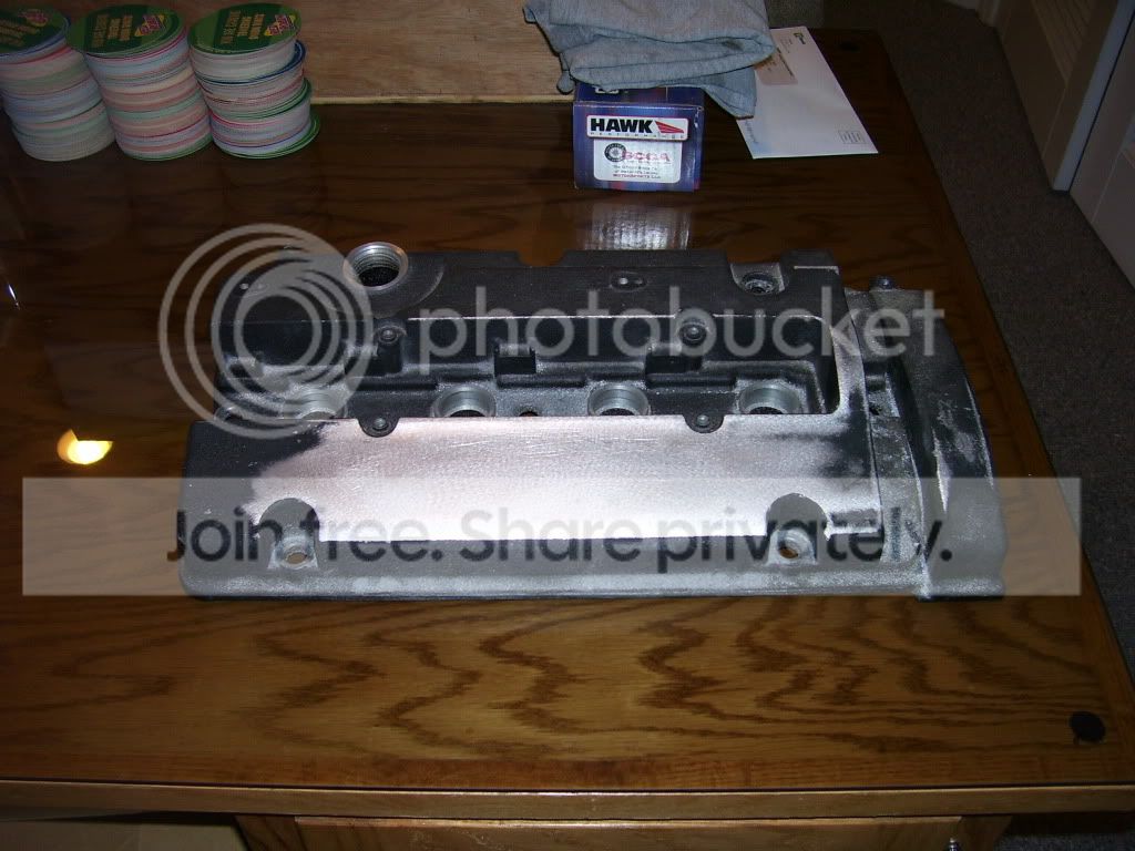

Also shaved the VC... a tedious project, but i wanted to try my hand at it. i think i did well. it looks like **** because the paint isn't all gone, but my buddy is sick nasty with an airbrush and offered a free paintjob as his contribution to the project. said he'd do the prepwork himself so i stopped sanding. it's nice and smooth. just needs the finishing sanding before paint.
i told him he knows what my plans are for the car, he knows what i like and the color scheme i'm going for, and i trust some badass artwork from him. so i told him he has free reign over design. can't wait to bring it to him and see what he does with it. i know some people would be worried what they'd end up with. but he's helped me with anything i've done to the car so far no matter big or small, and i've helped with his. so i figure a little bit of his work should be repped under the hood.
