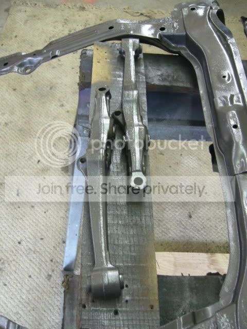

Bent LCA. Mine does/did the same thing in almost the same spot.
Pretty obvious here -

It's somewhat a PITA to remove for the first time. Hold a ruler to it and see if its straight.
