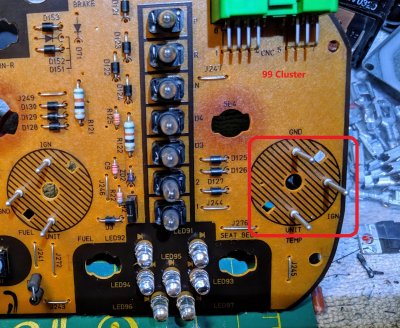

Yep, see SergA'a post above. You'll need a 98 or 99 gauge cluster. Run a single wire from the single connector sending unit on the side of the head (under the distributor) to the C2 connector on the gauge cluster.
This sensor
3MAWIEhMIdn_nv8KVvM4XDs4PadUpu87yBH8uby-bqU6HT2mglZyeH4vfW0-m2zhhT5xFT0ihyNABdyPiMTbS4e8Q8EO_7X7kD4V1rtAMcQSItLGBHnkwSpqXCwohptfBts6UjgjGEhPrqK-rGE3Vq8KV2aSLlQ23s8zqX3H_z3fY8VmYQkzxmX68KtmqYEu2Oa4CJebVEFWIDhHQZRg_9Cwp3VJXW_ql8Z9JvNMnpROn6qXezgxnqUiZ0xiY4mRdai3iRiBPPwYpEWS-vExB3s8cE2E4aGwc-NDUo6aPX6t0zLJvEZF7IM7EjeKZrgl749Wj3Y0GHEpyLJlq3PU_weTYgdjj-xi8mUTigdIL8ckc_6-rtO2vfraoiuJuxPy_yMHQWho1kIGXIc9el7D7Q261jadKzrkMurjELEtREW9SUdtfXpWvjaABdyuIEZEqhK68SUuOJIrTM_wNnXH80U_ptNrT-8izcxmVHdDfhhPpHAm83VujnlQJL41ap3bfsi0cjITWz81_vONSudwYBoqsPaKJ0KOzQkEPWKYLkxNhrrWjSSduRgjhMCP36d5wpOAKGAPNEpGHSc47h4RgYA1uIBXsCWFN2mYQg_8toFwbeFsY8pN9Rfzc4lsr4MSgeMZC_QgLw7Z86JUgbck1FyNRl-XMckE=w702-h937-no
Connects to this wire - C2 (Yellow/Grn Stripe)

Yep, need a 99 or 98 cluster and run a wire from the thermo sensor directly to the cluster. You can add the thermo sensor if your head doesn't have it, I made a post on how I wired mine up for my H23A swap here

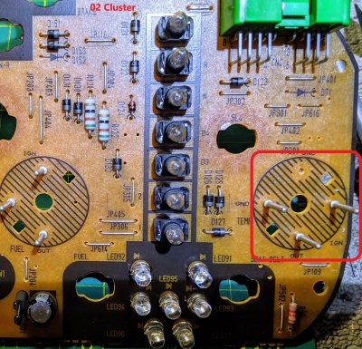

The 00-02 coolant gauge pins are in a different position from the 98-99, they won't work in each other.
