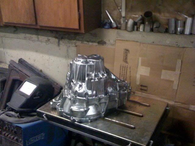

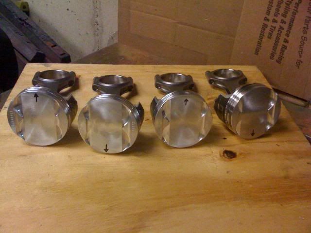

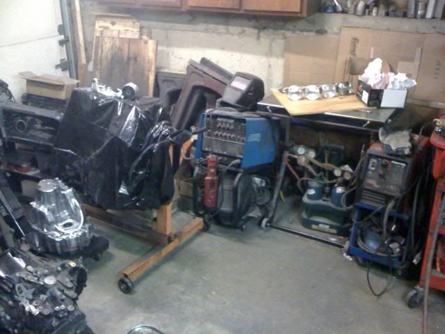

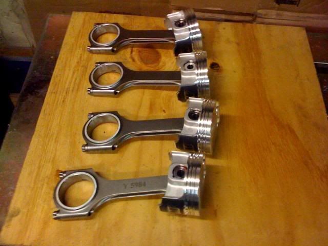

Been very busy with work the last week or so and I'm still waiting for some parts to come in. Last night I was able pull some parts apart and get them ready for coating getting everything burnished and cleaned up as well as possible. The trans took forever and it's still not 100% done maybe a few more hrs left before it's in shape for coating. Once it's done it should be real nice. Here are some random pics from the last few nights. The block got over bored and honed to 87.5mm and the pistons are ready to go forgot to take a pic of the block it's covered in the black garbage bag. Also beefier upgraded wrist pins are being used vs the wrist pins that come with the pistons in the box, it costs a bit more from wiseco but was told it's a good idea. Sorry for the crapy pics won't have my camera for a while I'm just snapping pics with the crappy iphone camera for now. I hope to get more updates sooner then later lol.
