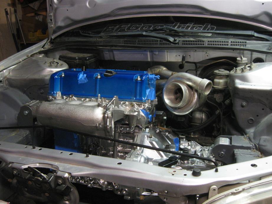

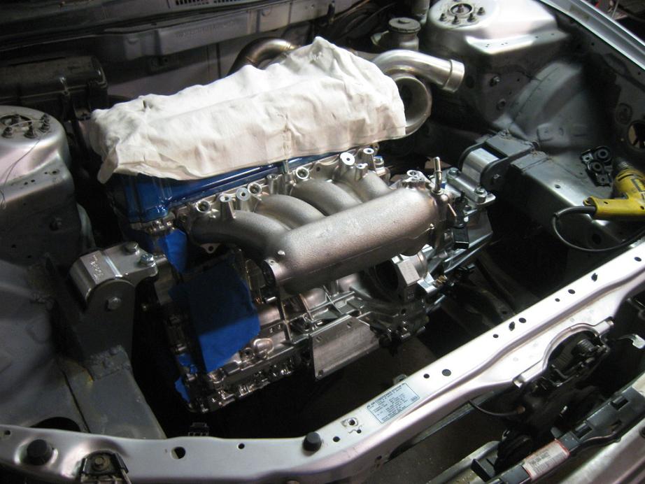

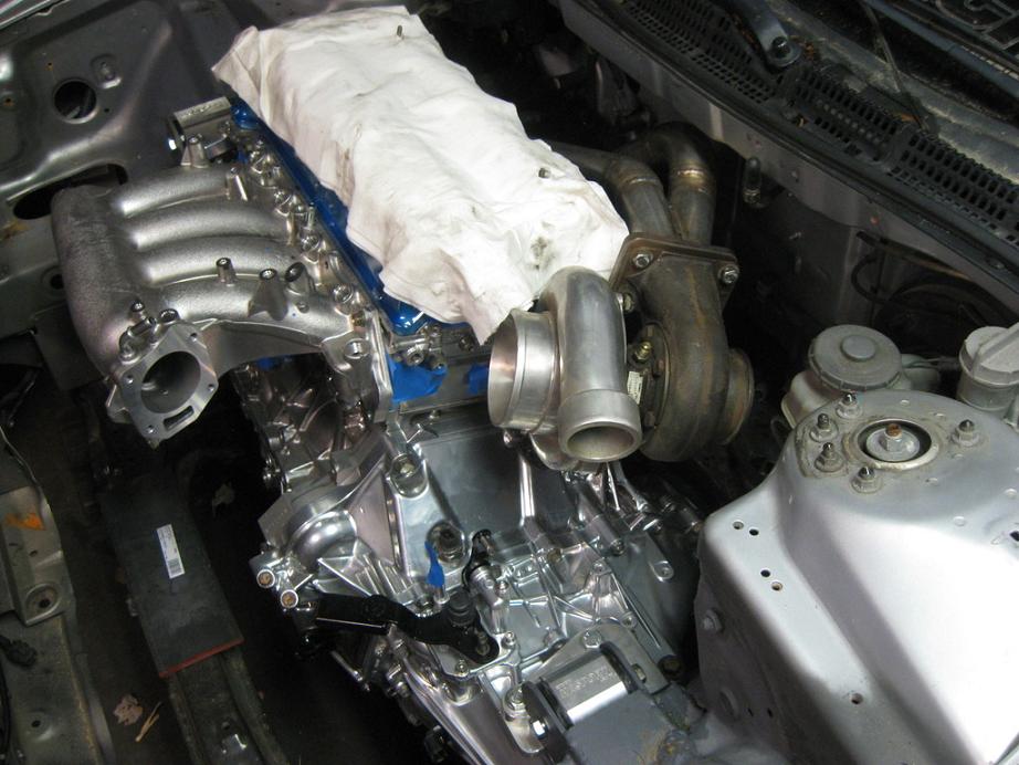

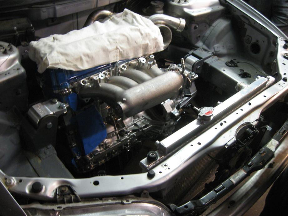

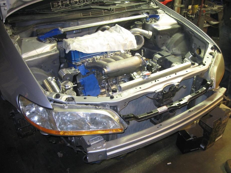

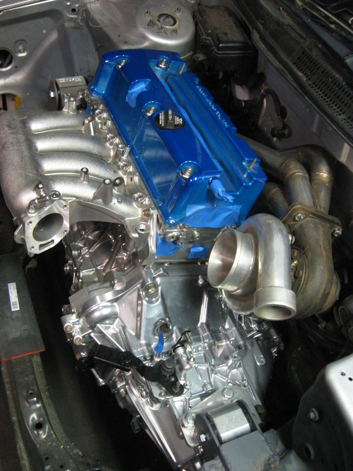

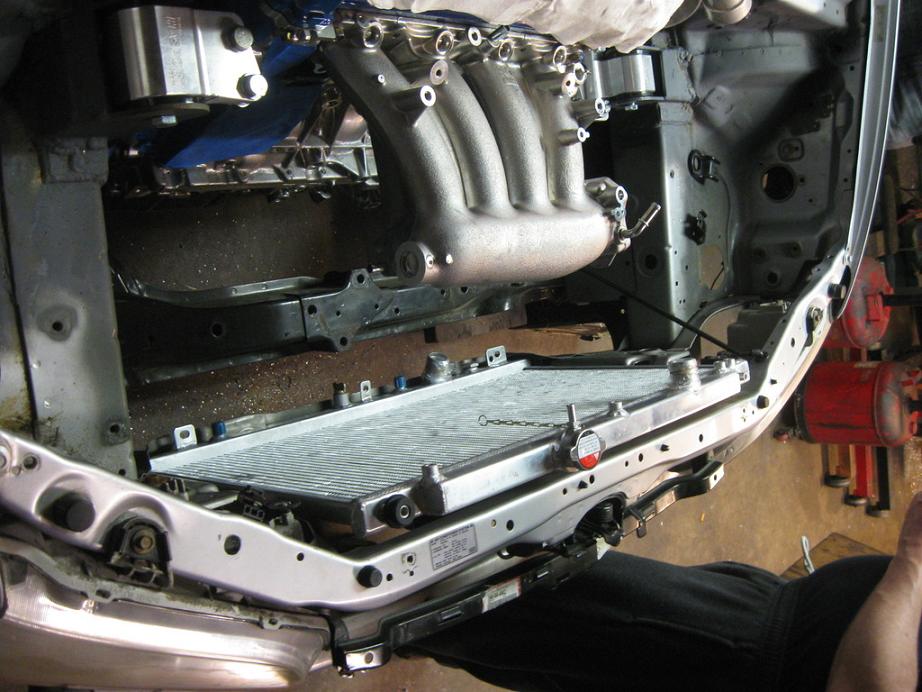

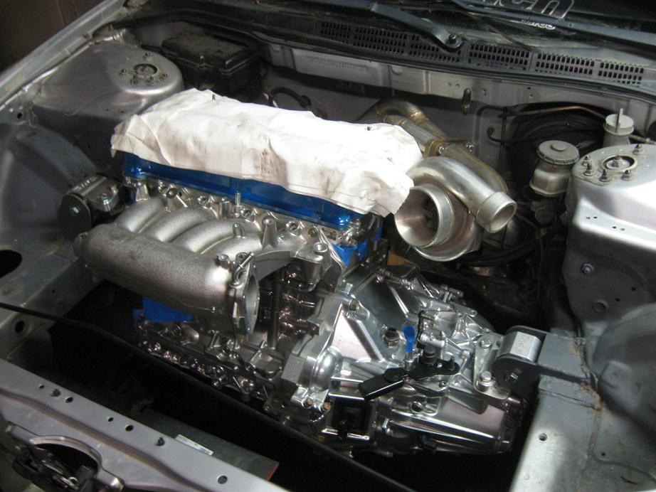

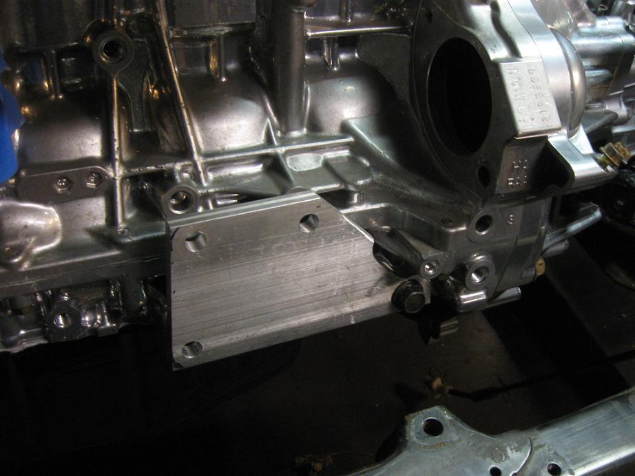

Well we made some progress yesterday installing the motor and manifold and other parts trying to see how everything fits before we do some fab work and more clean up of the engine bay before paint. We found out it's a little more work then it could be for instance the wastegate fitment is going to be tight but will work and will be welded on top of the manifold facing the turbo, the manifold fits well but the downpipe coming off of the turbo will touch the brake booster lines unless something is modified which will be done.
Unlike Civic's & Integra’s there is a lot of engine bay room but not so much in the back since the placement of K and J series motors are unusually more further back the those cars which is why these issues happen. 7th gen 4cyl radiator fits well in the car but it could be a little shorter but fits very snug under the hood. Catch can brackets, front engine mount and a few other things will be done in the next few days here are some pictures from last night.
