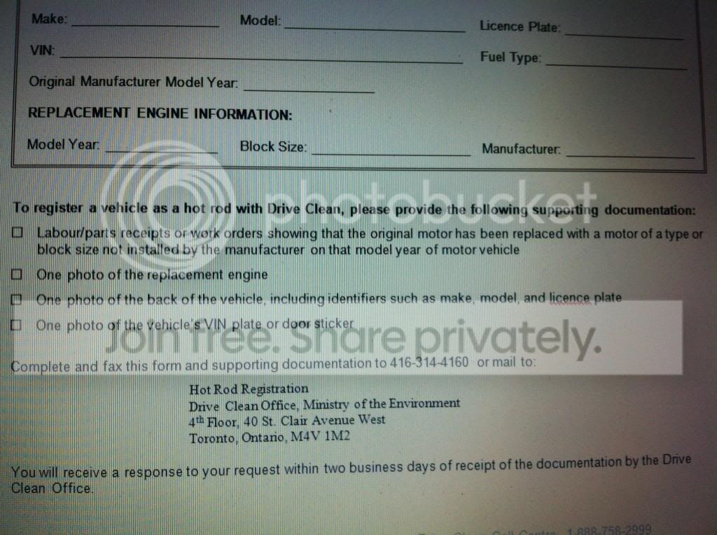

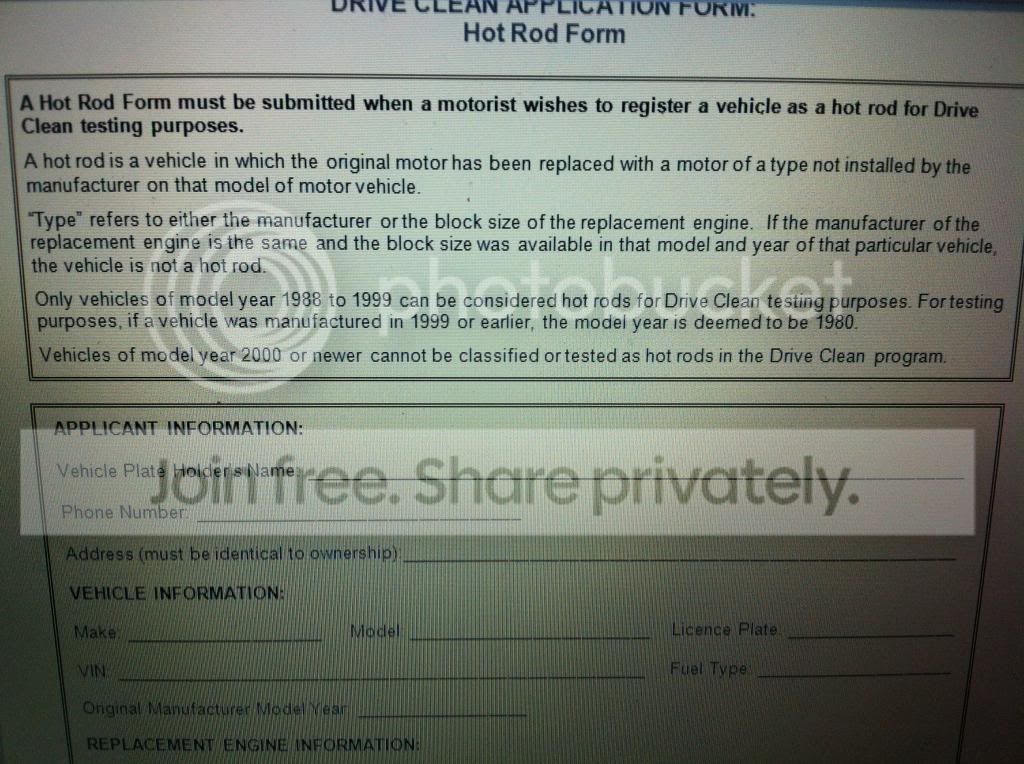

If all won't work, register it as a hot rod lol
...however take note this may screw you over in terms of insurance...or it may not. It depends how your insurance companies takes the news. DO NOT however withhold it from them if you go such route as you will HAVE a misinterpretation under your file and 99.9% be dropped and have a cancellation under your file and rated back to a 1 star driver.
You will need some documentation from Rich if you do not have it already about the swap/labor etc.
