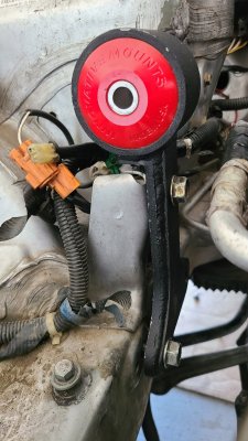

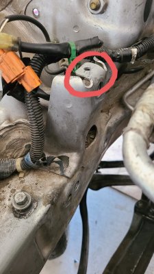

okay, so I had bought a set of innovative mounts for my 00 prelude, in expectation that I would be doing that swap after I got the motor rebuilt. As most know the 6th gen accord can run H22/H23 on the stock mounts. Really the only change is the driver side engine block mount. Following so far... So, today I was looking at the stock bracket again and held up the prelude innovative mount next to the bolt holes. The stock bracket has a tab that extends up a few inches. The prelude does not. Basically all I did is bend the tab on top about 90 degrees. Then I temp installed the prelude j adapter mount with 2 bolts. The lower bolt holes are slightly off, but think that can be fixed by elongating the holes.
619rcr
Jan 3, 2013
321
32
AZ
The driver side adapter is not as close to the prelude with the bolt hole placement. I could weld the bracket to the car. But, then again the cls uses a different mount setup bolted to the lower sub-frame... Why innovative never made a j swap mount kit for the 4cyl accord is beyond me..

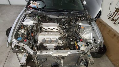

Couple shots of the donor. Removed the bumper and extended nose piece to make room to operate...

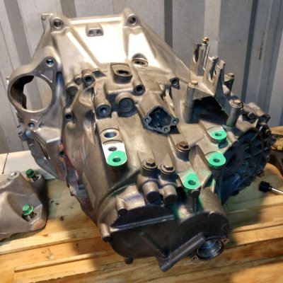

Here are 3 pictures that show various bosses on the J-series FWD 6MT. The first two pictures are of the transmission housing. The 3rd picture is of the clutch housing.
These 4 bosses that I spray painted green are used in various applications. I have not yet seen a transmission housing come from Honda that has all 4 of these holes drilled and tapped. All of these are tapped M12x1.25.
The 2003-2007 Accord and 2004-2008 TL (base and Type S) the 3rd boss to the right tapped with a small M8x1.25 thread. A small bracket bolts to it that holds one of the vaccuum lines for the rear mount in place. I have not yet had to drill out that thread and run a M12x1.25 tap, so I don't know if its possible. -- At the very least, this still provides 3 options for the upper transmission mount.
Note: 2003 CL-S 6MT transmission does not have an upper transmission mount.
Here are the 4 bosses on the lower transmission housing. These are M10x1.25. Every transmission housing variant that I have seen has all 4 of these bosses drilled and tapped.

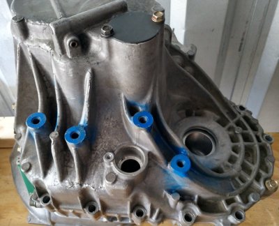

Here is the front view of the older style clutch housings;
Left: 2003 CL-S 6MT
Right: 2003-2007 Accord V6 6MT / 2004-2006 TL 6MT
The 3 upper holes that I circled are M10x1.25. The bosses are there in the casting for the 2003-2007 Accord / 2004-2006 TL clutch housing, however they are not drilled / tapped. In this picture I have them drilled and tapped. IMG_20210509_191404980_HDR__1400x1400.jpg

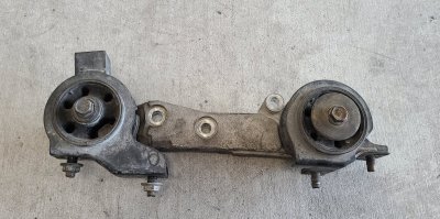

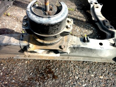

Here's a shot of the superior cls trans mount that bolts to the driver side subframe similar to the AT 6cyl accord. The 4cyl doesn't have the holes.

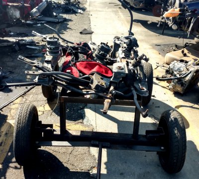

I went back and dug up my old pics from when I bought the 2003 CL-S 6MT subframe from the junkyard in March/April 2017. My recollection of what I did here is a bit fuzzy / clouded by the stress that I went through with the breakup that I had with my ex a few weeks after I took these pictures of the subframe / crossmember.

I *THINK* that what I did was pull the subframe + crossmember from the 2003 CL-S 6MT. Then, after realizing that the CL-S front subframe was bent due to the CL-S being in a front end collision, I think I picked up the front subframe from a 6g Accord V6 and bolted it onto the 2003 CL-S 6MT crossmember before carting the complete subframe+crossmember to the checkout at the junkyard.

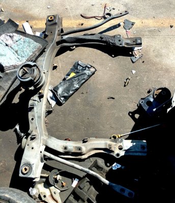

Hopefully my investigative efforts here will provide some insight for others in regards to what is needed for this swap. Picture showing the 2003 CL-S 6MT front subframe along with this additional area of the subframe that doesn't appear to be present on 6g Accord V6 subframe. I think this is where the damper connects to the transmission?

Cart where I grabbed both;
A closer view of this additional plate / threaded holes that the '03 CL-S 6MT has at the front of the subframe.
6g Accord V6, where this plate is absent.
