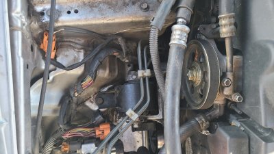

the easiest way I can explain is there looks to be a piece of sheetmetal that is tack welded and bonded with sealant to the frame on the v6. on the 4cyl, that piece is missing and so I had hoped it could be sourced and added on. only problem is I didn't want to cut up my cls in case it didn't work.
Searching honda/acura the rt wheelhouse seemed like the only part that matched up. part number 60610-s87-a00zz, which has been discontinued.
The circled area is what I'm talking about. I'll try to add a comparison pic tonight

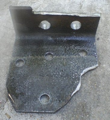

All you have to do is get everything mounted except for that, and then you can make something with scrap steel metal, a grinder and a drill.
I wound up doing this in 2006 when I was doing my F2D swap in my '94 Civic hatch (custom geared D trans, F20B). I went to a metal fabrication shop that I used to work at and grabbed a pice of c-channel from the scrap bin.
What size are the 2 threads that are at the bottom of the circled area of that pic you sent?

couple pics showing the differences. 4cyl motor out, j32 in. Ignore the thin silver strip toward the top of the 4cyl bracket, that was affixed to the intake. The 4 cyl body appears to only have 1 of 3 bolt holes as normally found holding the 6cyl bracket. its 8mm x1.25. the custom fab prob could work. Just don't have any materials on hand.
Plan to pull the j32 to rebuild, maybe in a week or so. Should be able to get a better look at the spot welds then and maybe test fit swapping lower crossmember on the 4cyl. Worse case I have innovative jswap mounts for my 5th gen prelude, standing by.
