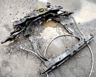

And here is a picture showing the '03 CL-S 6MT cross member with the 6g Accord V6 front subframe next to it, showing that it lines up. I have circled an the part on the CL-S 6MT crossmember that I think might be where the rear engine/transmission damper mounts;
https://www.acuraoemparts.com/v-200...6-gas/body-air-conditioning--engine-mounts-mt
619cr, can you please confirm this?
Hopefully my investigative efforts here will provide some insight for others in regards to what is needed for this swap.
