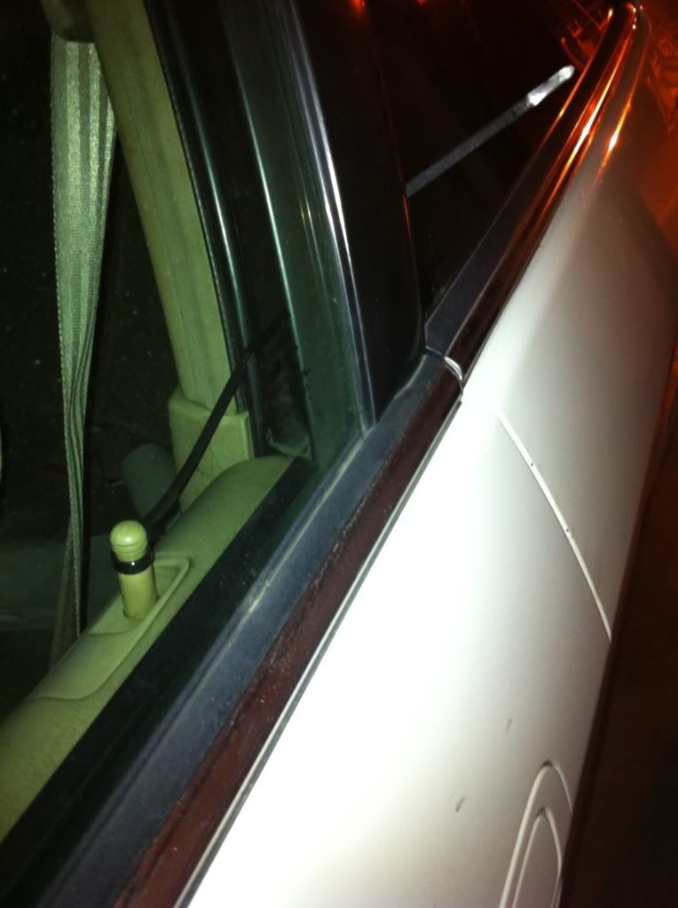

Tools: Flat head & ziptie
Basically, I was at a friends place tonight and I locked my car, went back to get something out of the trunk and closed it with my keys still in the trunk.
Lock the zip tie with enough space to fit 2 fingers.
Pry the top right corner a bit with the flat head to fit the zip tie in.
Wiggle it down to the bottom and loop it over the lock
Tug gently to tighten the zip tie and pull up
Most lock smiths will charge anywhere from $30-$70 (especially past business hours). This took me 5 minutes, if that.

LOL. This was a rare occasion that I locked my keys in my car and I just tried this method real quick to see if I could get in and it worked. Most locks now dont poke up as much as ours do or the lock is next to the door handle.
Oh and if you drive a honda, chances are you have zip ties laying around -__-'
