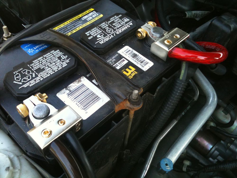

now its narrowed down to bad connections and/or bad battery terminals. pics of the ring terminals and battery terminals would help, as would pics of the ground locations themselves.
first step is to set the meter to ohms, and most are marked with a setting called "10" or something similar...set it to that. measure from the negative battery terminal to the chassis ground...battery terminal to the transmission ground...battery ground cable end-to-end...and so forth. cheap meters from harbor freight or menards will only go down to about .5 ohms or so, which is ok. thats close enough to 0 as long as we know that it can't actually display 0.
next is to switch the meter to DC voltage or some are marked just DCV, again to the "tens" position. might as well measure across the battery terminals to start, making sure we have 12.8v or higher with the car off, and it should show 13+ with it idling. once that's done, start probing the grounds with the black lead while holding the red lead on the positive battery terminal. if you see a spot with low voltage, there's your problem. alternately, use the resistance setting and do the same.

These are the terminals I'm using. I'm not exactly sure what to do with the multimeter, where do I put the red/black contacts and what numbers are considered "normal"?

ok, the ring terminals are the normal, flat ones. those conform to curves and such.
which battery terminals, then?
for measurements, you want impedance/resistance to be low...under 1. voltage/DCV should be over 12 for the static battery, and well over 13 when running.

Terminals
Battery (+)
Battery (-) to chassis
Block to chassis
Thank you for all the suggestions ryan_s and everyone, I'm gonna measure the resistance when I have a chance to see if it looks alright. The car still seems to be running good today.

Well I think I found the problem for the idle issues, my engine grounds were poorly sanded. You called it ryan_s.
since it only started after messing with the ground and the terminals, well, there's your problem in there somewhere. bad connection, bad wire, bad termination, inadequate bare metal at the ground point, poor plating on any terminal/ring terminal, loose connections, etc...
I used 220 grit sandpaper (which is all I had around) and did it by hand, I couldn't really tell if I was seeing bare metal or not. I busted out a wire brush drill bit and power drill and took off the paint that way, and now I know that I definitely wasn't grounded to bare metal before. Now the idle has been pretty solid for the past few days.
So yea, don't skimp on the sanding part when grounding like I did. Thanks again everyone for the help.
