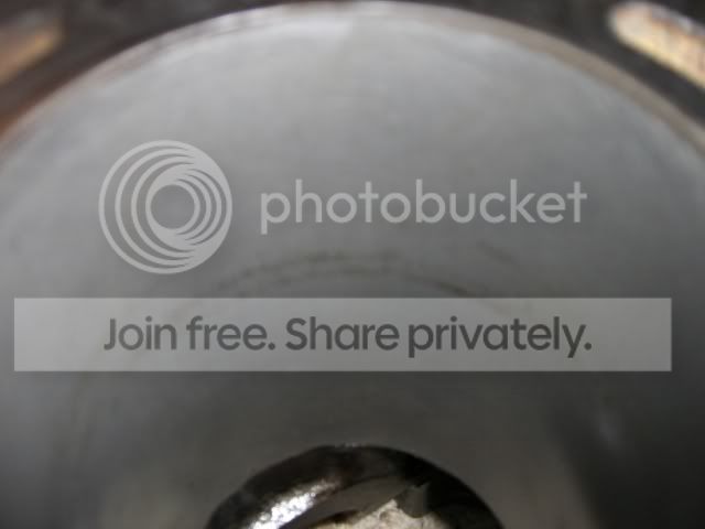

The engine is going to be bored to 81.5 because there is some rust on cyl #1

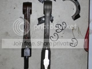

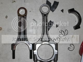

These are the stock rods I will be using. The longer silver one is a k20 rod for comparison.

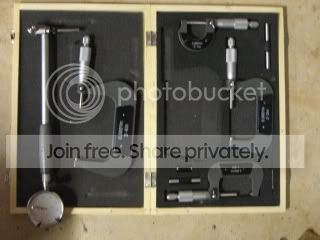

My new tools

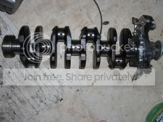

I miced the crank and its in great condition. Im going to have it polished.

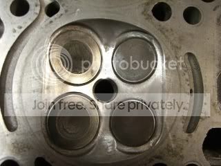

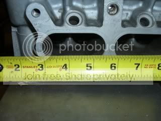

My bigport head. These ports are huge for a 1.6 liter
I have already semi polished the combustion chambers

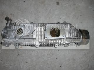

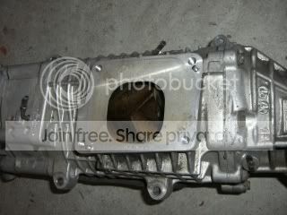

And this is what is going to bring it to life. Its 1l/rev twin screw. The first pulley set up will give it about 17 psi.
