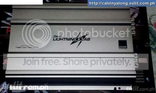

my 4ch amp is a jbl gto-4000 for my front seps and rear 6x9... it is 13x9x2 inches so i think ill be having trouble installing it under the seat... i still dont have the pix coz im so busy with work now... but i will still post the pix as soon as im free... thanks for the ideas guys and im pretty sure all of your inputs will give me the best option where to put both 4ch amp and sub amp... my sub amp is 312mm X 232mm X 51mm...

The 4 channel would definitely be a tight fit, and it doesn't help that it has side terminals. My 5 channel was like 10 x 8" and had all connections on the front.
I assume you want to reuse what you have, but a class d amp is much smaller (and more efficient to boot).
