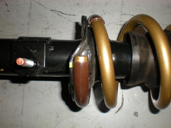

Okay, so I've been getting this annoying clunking sound from the rear of my car, even on small cracks on the road, for the past several weeks now. Sounds similar to turbo_911's problem a couple years back. Last week I replaced my rear sway bar bushings but that didn't eliminate the noise whatsoever. Earlier, I captured a video of this..
Clunking
When I try to twist the spring around, it's tight but it seems as if there's a slight gap between part of the very-bottom coil and the spring perch that's causing the sound.
Do I compress the spring more (move the 2 perches up a bit) or should I buy those Tein Silencer rubbers and place it between the bottom of the spring and the perches? I'm thinking the latter.

The spring should not have movement up/down, it should be actually compressed 5mm from its free length. If they were never re-compressed after installed when new what could've happened is the spring is now broken in/sagged a bit.
Personally i'd do both.
#1 Make sure the spring is compressed 5mm from its current length now
#2 Add the rubber silencers

Well, I just came back from a local tuner shop and they didn't carry the Tein silencer rubbers but the guy gave me this (don't know what it's called), which he said is essentially the same.

What they gave you would serve the same purpose...it's basically there just to soften the metal/metal contact.
As for the preload; from all the FF sets i've seen and helped out on I've found none of them to be to FFs specs for preload when out of the box brand new. Some have been tightened too much and some not enough. I've always just loosened the spring perches fully; measured the spring; compressed it 5mm from its free length; and then gone through with installing them on the car after lubing everything with grease.
Would you compressing the spring 5mm make a difference? Yes it will make possibly a small minuscule difference.
Reason being as...right now the spring does not start compressing until that small amount of movement compresses into the shock body first(this is assuming the car in the air and the damper under no compression force at all)
Once you create the correct amount of preload, the spring will begin its compression at once with no free play in it.
I would assume the end result will be a very very slightly higher ride height after you preload the spring. It's hard to say if you'll need an alignment or not though but if you've got the whole lifetime alignment deal then Yes get it.
One thing to keep in mind though is that when you drive your car the spring is loaded at all times no matter what you have set the preload to as the weight of the car is on it. Hence why I would think doing both #1 adding the rubber silencer, and #2 making sure the spring preload when free is correct...should hopefully fix things if it is coming from the coilover itself
