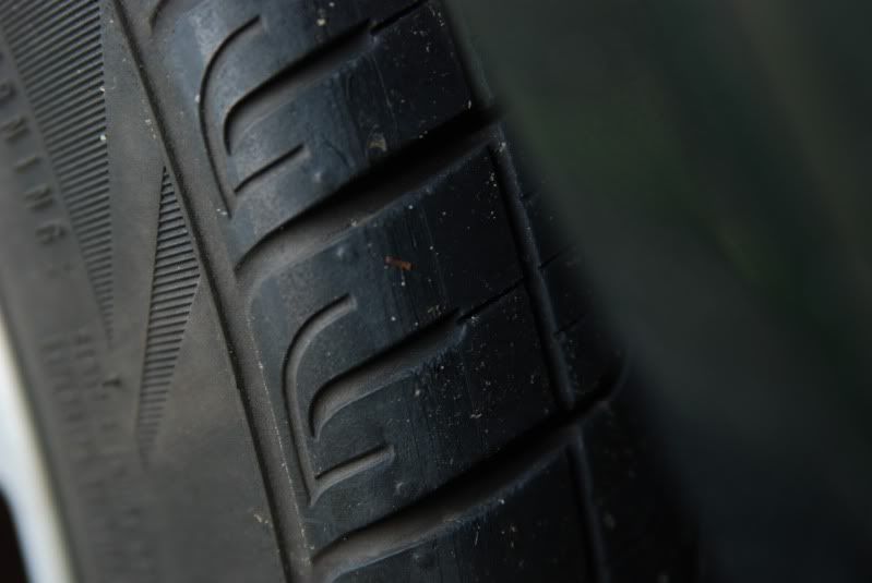

you aint rubbing till your tires look like these
both my rears look like that shredded :D 18 x8 35 offset it's my bumper tab that keeps hitting it. I'm going to relocate it and cut the bumper.
