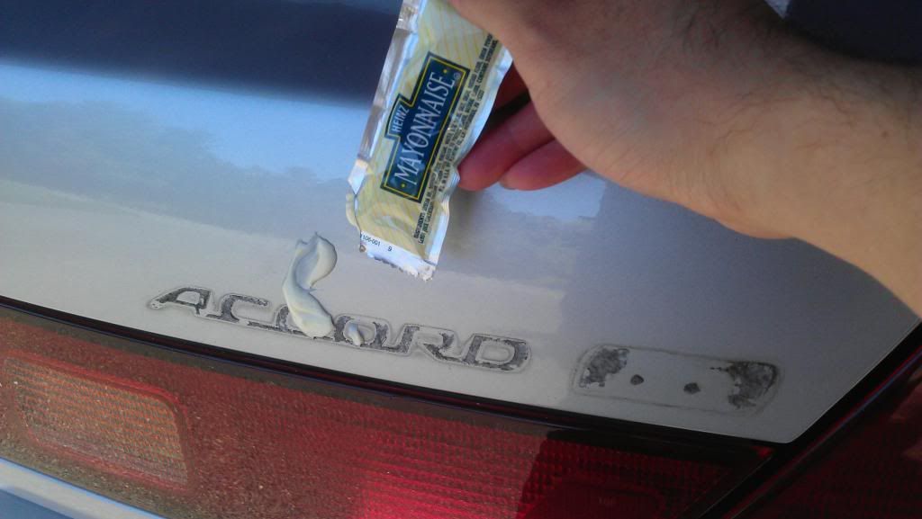

Okay, as I promised to reveal the "Grandma's secret" method of removing those tough adhesives after the badge removal, here it goes:
:puke:
Yes, the secret is Mayonnaise! :rock: The adhesives become jellified, after rubbing it with some paper towels for a while. I think it's the grease that plays the trick, meaning that using non-fat Mayo won't work.
Scraping them off w/ Mayo applied. (Later I discovered that it's best to just scrape them w/ finger nails; It won't scratch the paint since Mayo rubricates the surface.)
It's very hard to tell the badge marks unless looking at them very closely in a certain angle.
I've always been wanting to do this sometimes, and it's finally accomplished. :)
So, it was da Mayonnaise lol. No Goo-Gone, acetone, or any of those harsh chemicals that harms the paint surface. Mayonnaise ftw!
When I had my side pinstripes removed, there were some marks afterwards but they disappeared after one summer season. I'm sure these ones will be gone as well.

mayo? seriously? lol. nice man. awesome home remedy. haha.

Lol ! I was expecting to see a big squeeze bottle of mayo .. :lawl:
I might debadge mine now .. thanks for the motivation Richard .. :rolleyes: hahaha

Mayonnaise?!? Seriously??? :lawl: That's great.

Yeah, I'm dead serious fellas lol. I think it's the safest adhesive remover for a body paint. :thumbsup:
Well, some of you already know that I am a barista. One day, I was trying to remove a sticker on the espresso machine. I got it off but the adhesives were not being so cooperative. One old lady (a customer) was watching my job the whole time, and she walked up to me and said, "Try mayonnaise." She definitely deserves a rep point right there lol.

Dont be fooled by thinking mayonnaise is the safest thing out there. If you leave it on too long on warm paint it WILL eff things up. :coffee:
