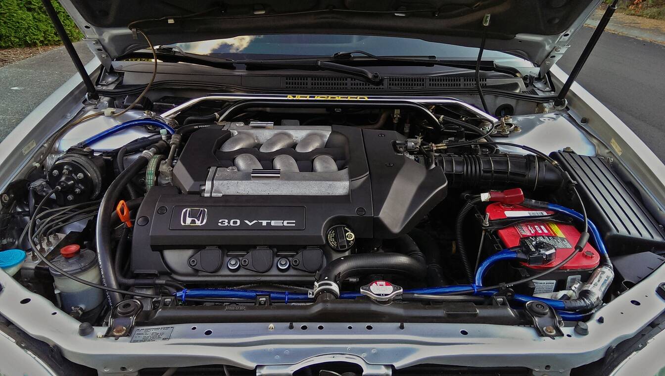

Was debating between this or "無限 MUGEN POWER" in silver logo.
Good sealing compared with the OEM cap I've had; It turns and feels much more gradual in torque as I tighten / loosen it. Hoping that the rubber sealing will stay like this.
Almost chose the center cap in blue, to go with my blue ground wirings, but settled w/ black.
Before & After.
More things coming soon!

I like that cap. Subtle but still adds a nice touch to the bay. How much did that thing cost?

Thanks. It was 9,180 Yen, and I paid about $90. These ones are their newest model (~2012), btw.

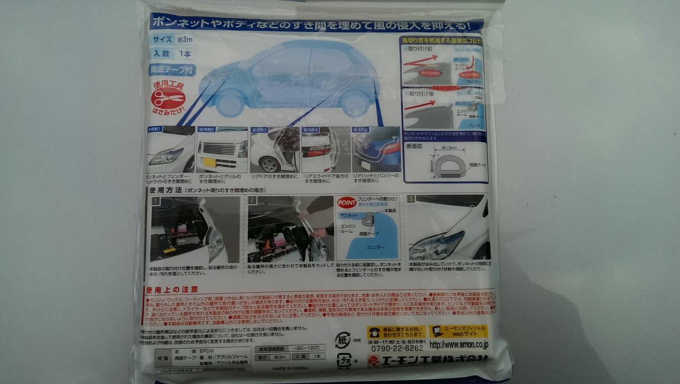

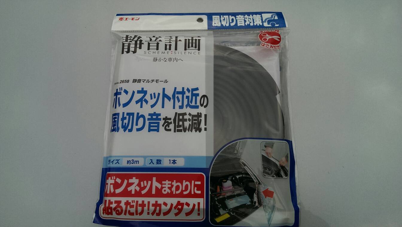

Thought this could help reducing some wind-noise from the outside.
Pretty thicker than the other ones I have for my doors & trunk lid.
Before & After
Kindda hard to tell from a distance, especially w/ my door edge guards over it, but it's def filling up the space inside.
Was able to tell the noticeable change, especially when driving w/o my side window deflectors. (Oh, it's not the placebo thing tho. :lawl:)

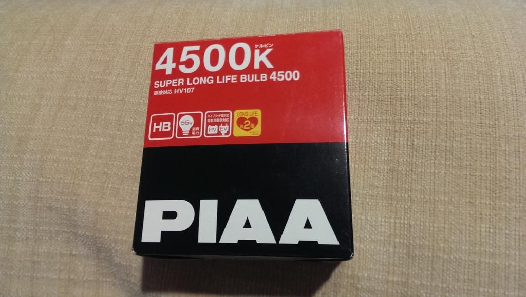

One of my PIAA 4250K Arrow Star went out, and decided to get a different one.
PIAA 4500K Super Long Life Bulb
No pic of the lighting, but it's very similar to my Arrow Star shown below. Slightly bluer than this:
It better be "Super Long Life" as they say.
More mods to come soon!
EDIT: Here's the pic of the lights.

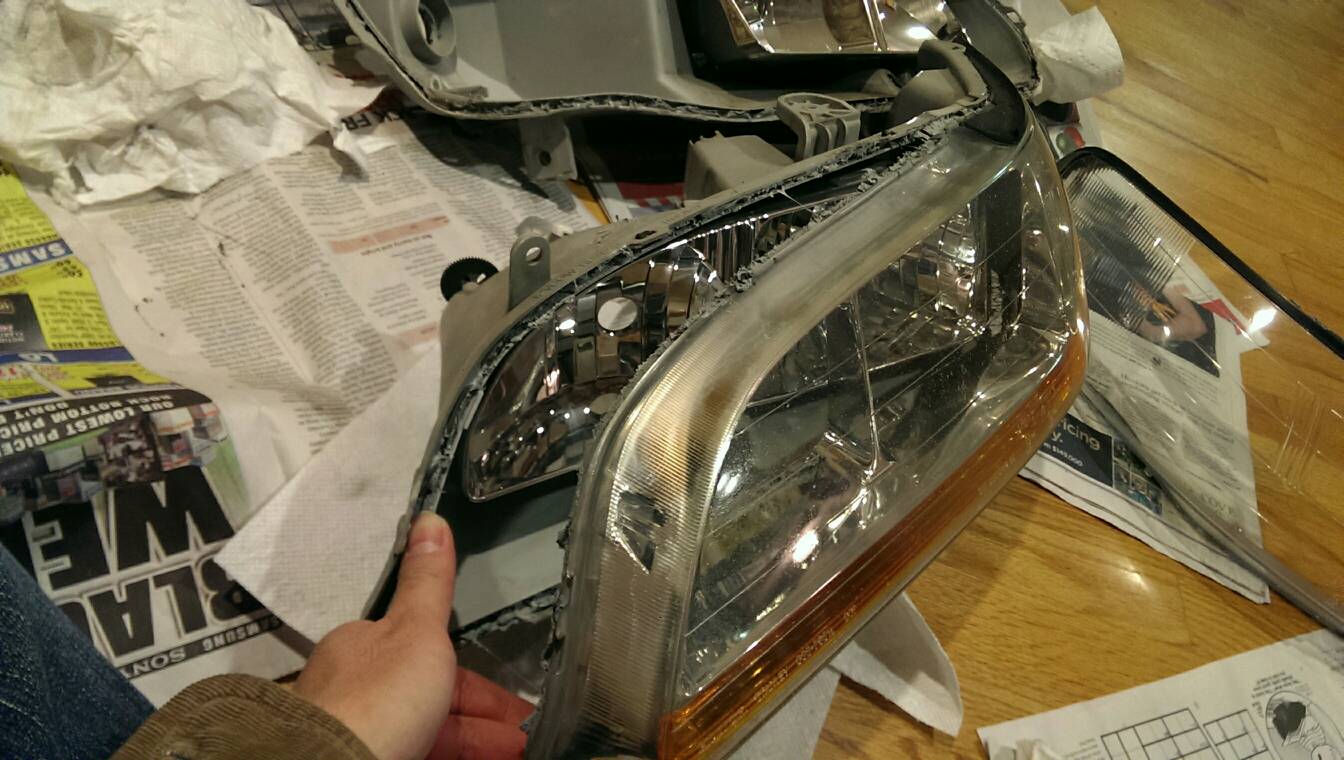

Been having a spare set of used OEM headlights for 5 months, and it's finally time to black-house them.
My original intension was to use a heat gun to melt the sealing, but I just put them in the oven instead, because it was taking too long w/ the gun.
--Preheated the oven to 210°F
--Baked them (one by one) for 10 min
--Pried them apart with a plat-head screw driver
(Wifey doesn't know that I used the oven. Shhh..)
--Removed two phillips screws behind the amber strip housings
--Washed all of the disassembled pieces w/ mild soap
--Wiped them off w/ kitchen papers (Let's be careful not to peal off the "breather hole mesh stickers" inside the housings that prevents condensation.)
--Ended up using the heat gun as the blow drier lmao
--Dusted off fibers from the kitchen towels w/ the air duster spray
Ready for some masking work on the housings.
To be continued..
